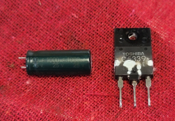

I collect cars and do all my own work. I picked up a Hunter tire balancer with a CRT monitor. Everything appears to work except the monitor is dead - does nothing.
A visual inspection revealed a burned Toshiba C5339 and a swollen 1000uf 25V capacitor. The components are on opposite sides of the board so I don't think the 2 problems are related. The capacitor is in a section of the board that is labeled 12V.
What kind of information do you guys need to tell me what direction to go with this repair?
The C5339 is mounted to a large heat sink but the compound is totally dried up and the board is discolored. What else should I check before I burn up some new parts? Thanks!
The C5339 and 2SC5339 are popular horizontal output transistors which would make sense with any CRT type device. You may want to give this a read:
HORIZONTAL OUTPUT TRANSISTOR BLOWS UP - REASONS (CRT Based TVs). A big part of the problem is you are likely looking at a symptom, a blown up horizontal output transistor and not the root cause of the problem or why it is toasted. Replace the cap and less the transistor try turning the system on and look at your DC voltages. The cap looks to be a common 1,000 uF 25 WVDC filter cap. Less any drawings and a good knowledge of how these things work it will not be easy to trouble shoot it.

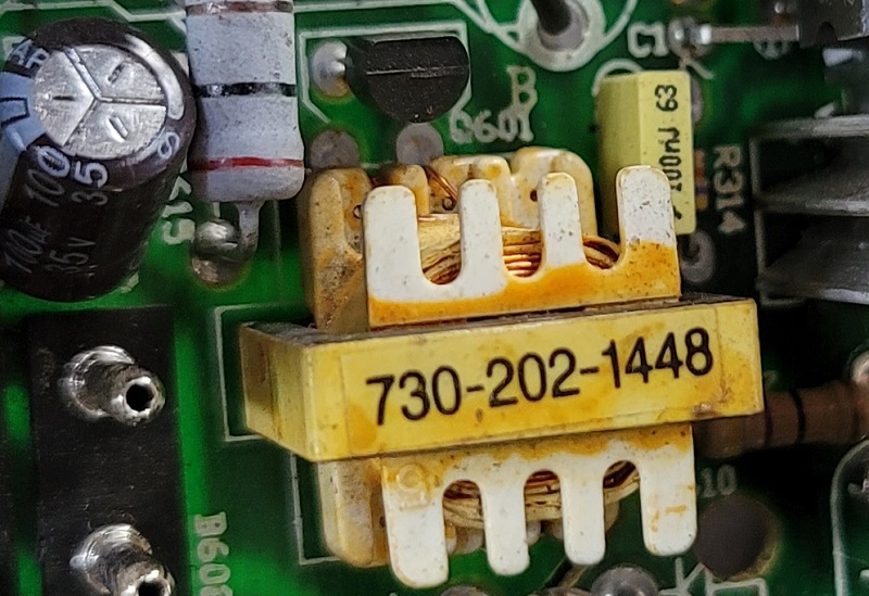

Pins 1 & 3 are shorted to ground measured at the board with the C5339 removed. You were correct in that the C5339 burning out is just a symptom.
The transformer has has 3 pins and 2 wires. The three pins show .1 ohm between any pair with my cheapo meter. The 2 wires show .6 ohm between them. Does this mean it is shorted? That seems like a really low reading.

1, 2, and 3 if I read it right should be Base, Collector and Emitter so if that holds true the Base and Emitter are shorted to ground. The transistor is a NPN type so Emitter to Ground is not that unusual depending on how they have it configured. To turn it on when running the base needs to be at least 0.7 volts more positive than the emitter. When taking resistance readings you also may want to try the leads one way and then reverse them because you don't know what other semi conductors you may be forward or reverse biasing when you probe.

That's because it's the primary of the line driver transformer, so perfectly normal.
Main cause of LOPT transistor failure is the LOPT transformer failing.
Basically, unless it's a chassis you're VERY familiar with, you replace the transistor and see if it goes BANG when you turn it ON - keeping a close eye, and ear, on the LOPT transformer (they commonly arc internally, or externally, and blow the transistor).
that's normal, however, if you noticed the small transistor next to the transformer, that's the primary side of the transformer.... on that side of the transformer, look for a small (usually somewhere between 4.7uF and 22uF, and rated between 16V and 50V) electrolytic capacitor connected to the opposite end of the primary than the small transistor. replace that capacitor as well, and any electrolytic coupling caps between the secondary and the 2SC5339 base pin. problems with either (sometimes there isn't any coupling cap, but the driver transformer bypass is important) can cause the output transistor (the C5339) to overheat. when i was in the business of repairing CRT monitors, it became habit to replace these capacitors if i had a repair involving a shorted horizontal output transistor. and make sure you use white(not silver) heat sink grease for the output device.

That capacitor on the primary side was 100uf 35v and it only measured 14uf. I replaced it. Thanks!
One thing I did forget to mention - resolder the joints on the driver transformer - a common cause of LOPT transistor failure was dry joints on the driver transformer.
