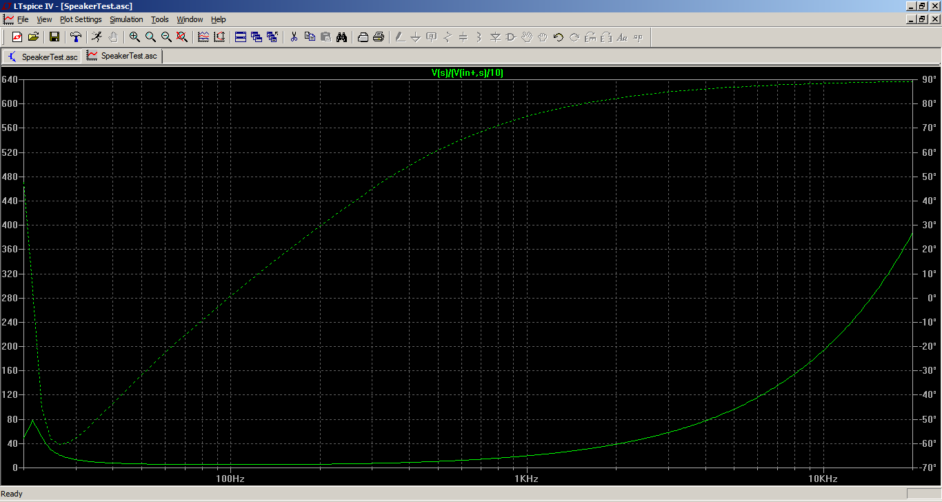

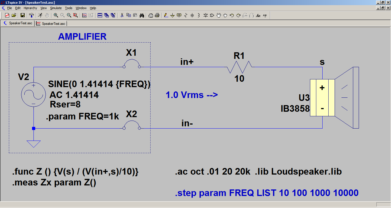

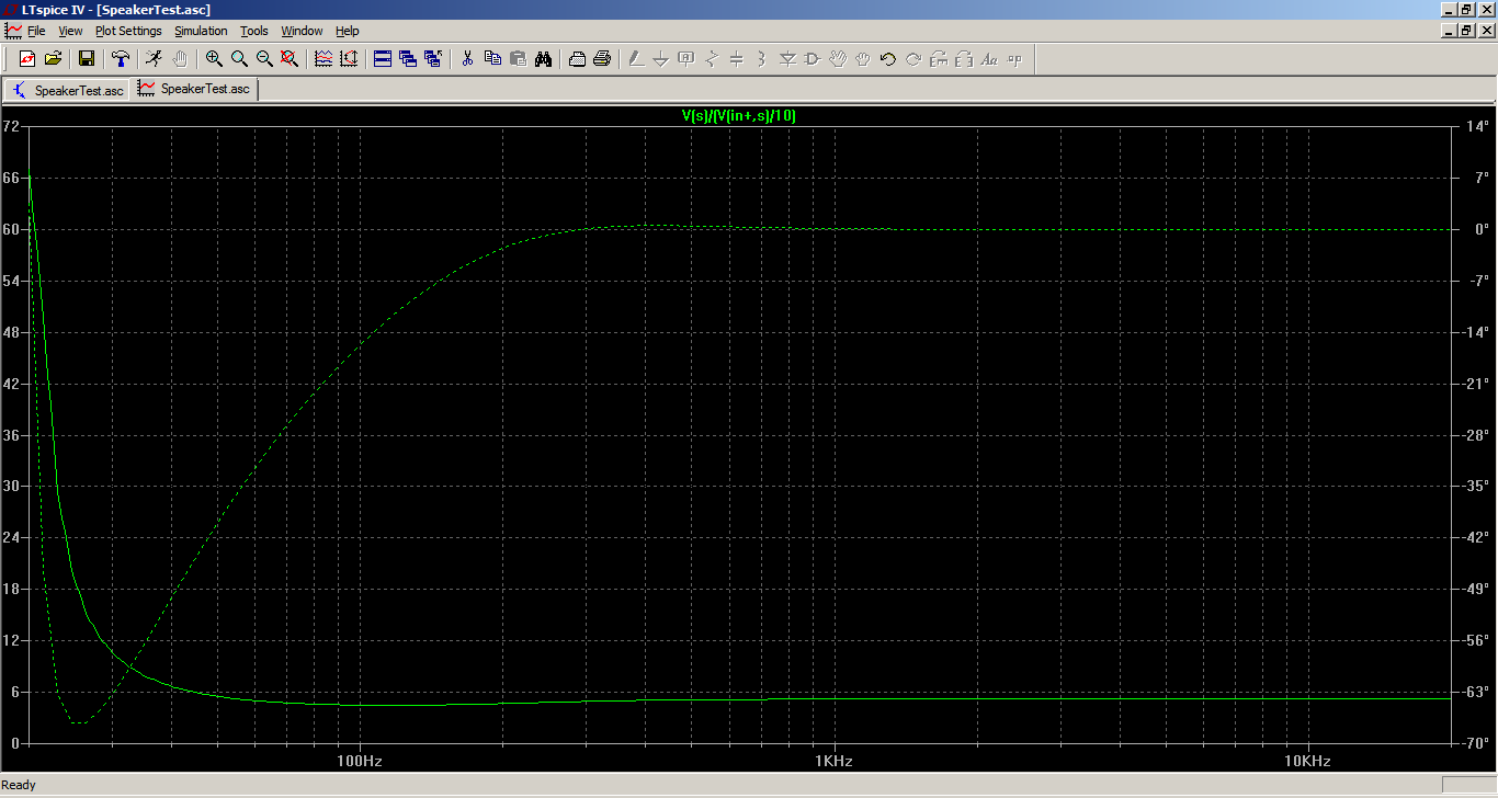

So I've run a couple of tests with and without the Zobel impedance correction on the IB385-8. I can ena/disable Zobel by setting a param in the model. I've attached a sim for each. Have a look.
eT
With the Zobel networks then the crossover networks are loaded correctly.

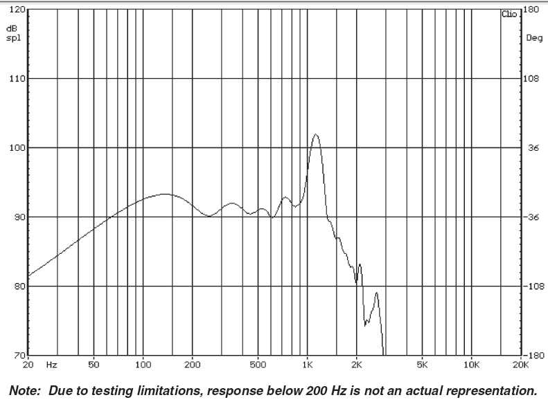

Here is the frequency response of a Dayton 385-8. There is a nasty bump at 1.2khz. Hopefully the cross over network will role that off.
The frequency response below 200hz will depend greatly on the enclosure.

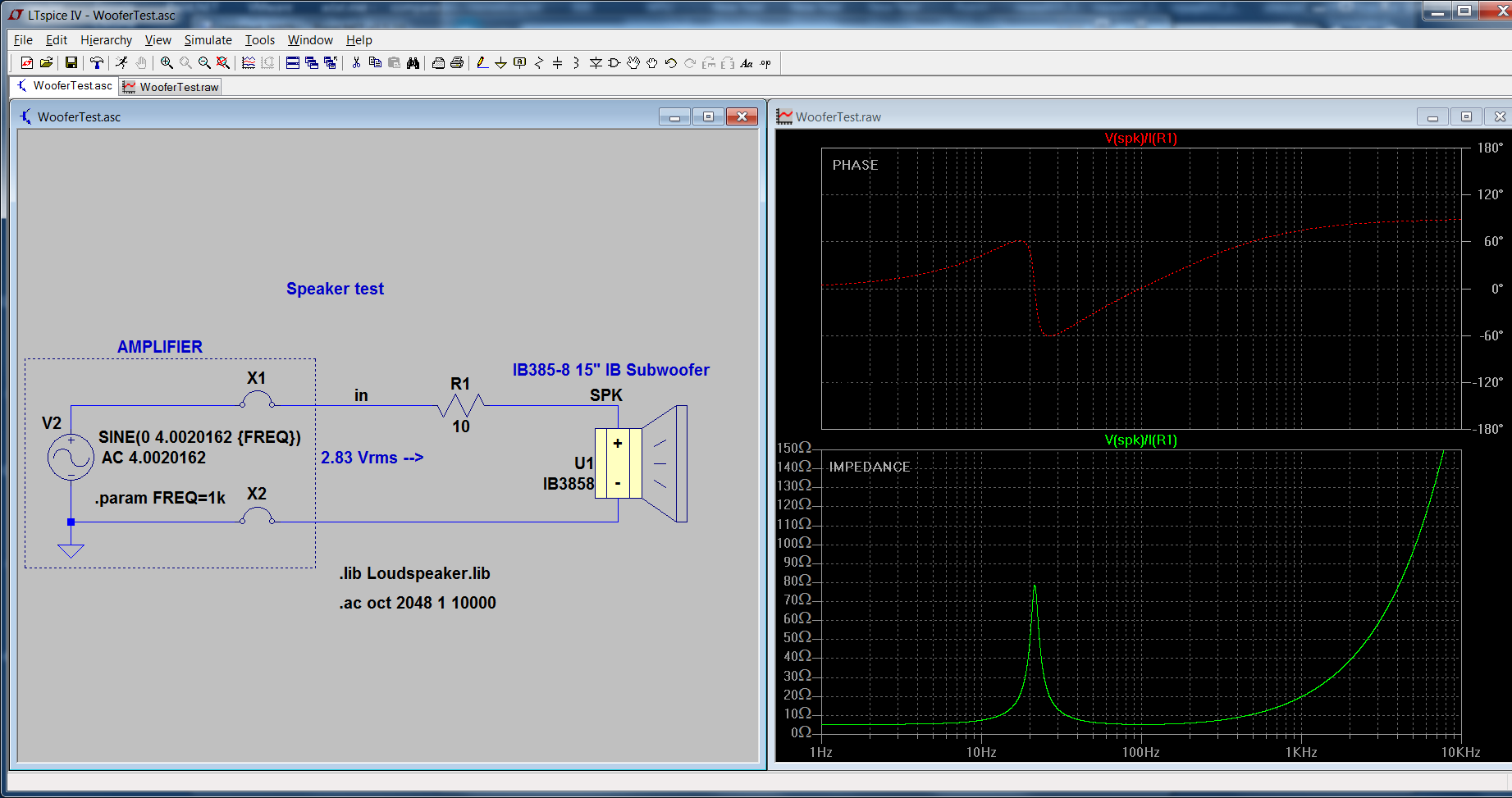

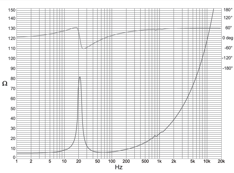

Here is the impedance of this speaker. I don't know if the SPICE model takes into account the inductive effect above 200hz.
Hi
Here is the spice speaker test and impedance response plot for the IB 385-8.
eT
