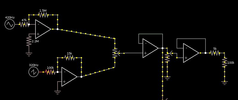

Okay, here's the basic solution I'm trying. I haven't had a chance to breadboard it yet, but it simulates fine. The source signals and the op-amp stuff right after them are just part of the existing circuit. The blend pot is a 100k linear and at either end of the range it seems to be 100% of the appropriate signal at 100% amplitude. The half way point is a mix of two, each at about 45% amplitude. So the only issue I'm seeing is that the 50/50 mix is actually 45/45 so a slight decrease in overall amplitude.. but I don't think that will be an issue.

I don't understand why the 50% point mix is 45/45 when it should be 50/50. :confused: Are you sure you measured it correctly?

The middle opamp is completely wrong, it needs to be an inverting opamp to act as a mixer, and needs a feedback resistor.
Check the link I posted earlier for wiring the pan pot correctly.
It's not completely (or even partially) wrong at all. At the midpoint of the pot the signal at the op amp non-inverting input will be a 50/50 (voltage) mix of the two input signals. You don't need to use an inverting amp.
