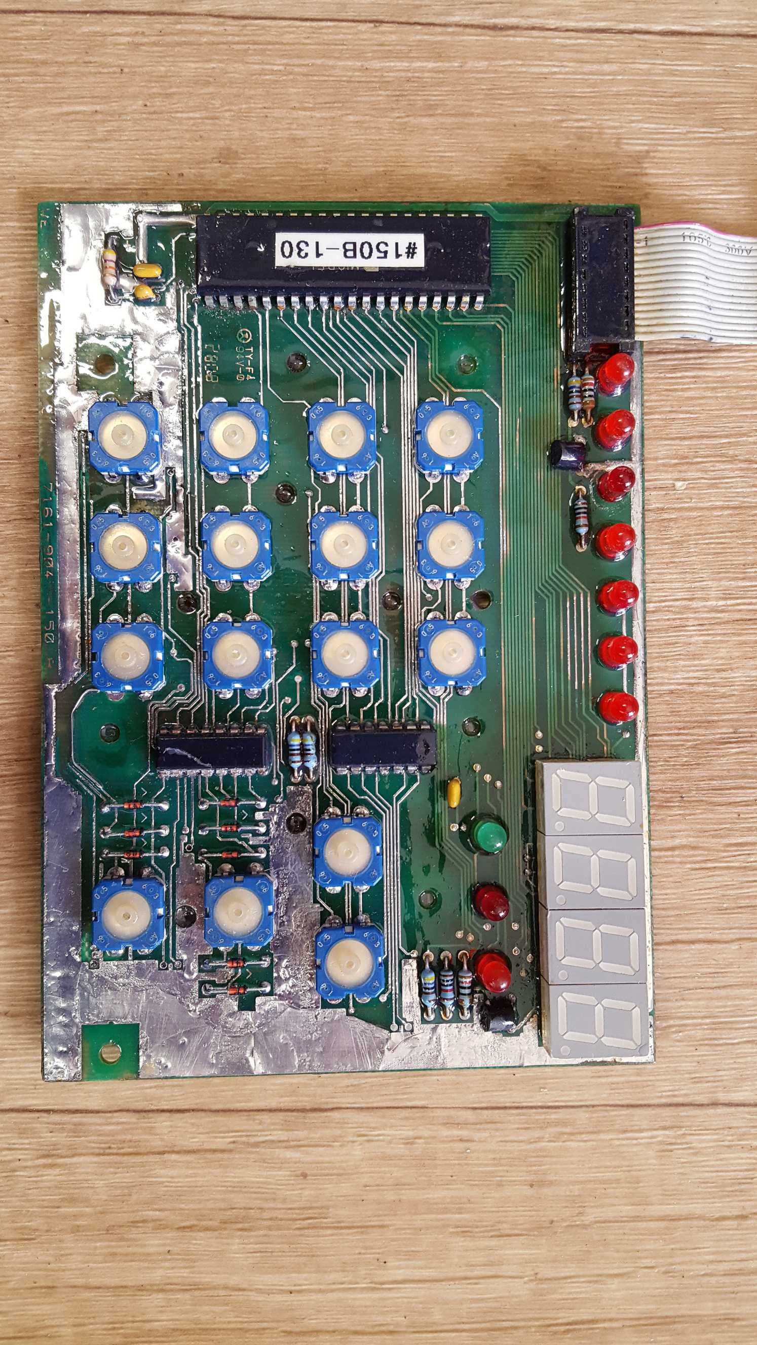

1. PHOTOS of the board.
2. Do you have a schematic?
ak

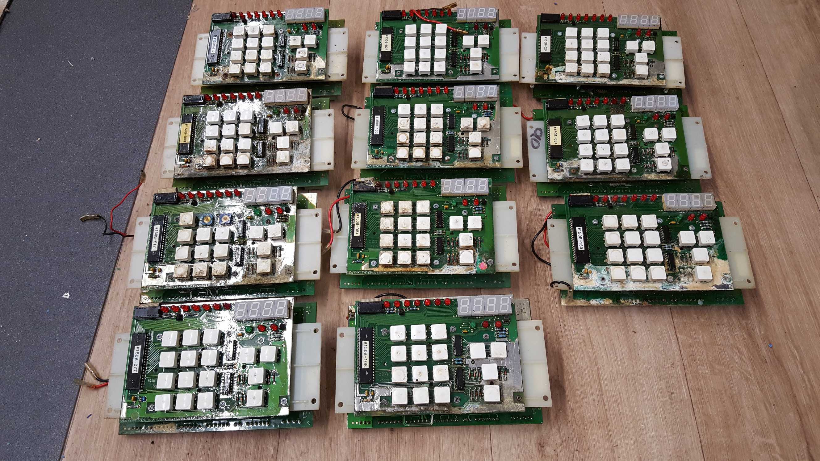

This is what I start with ...

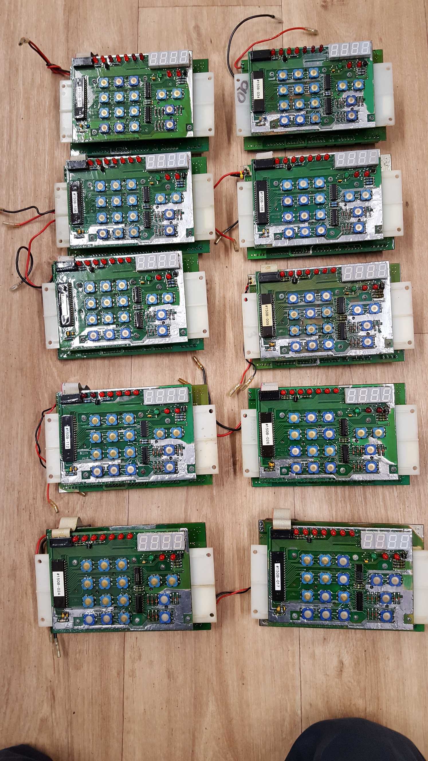

This is a finished batch ...

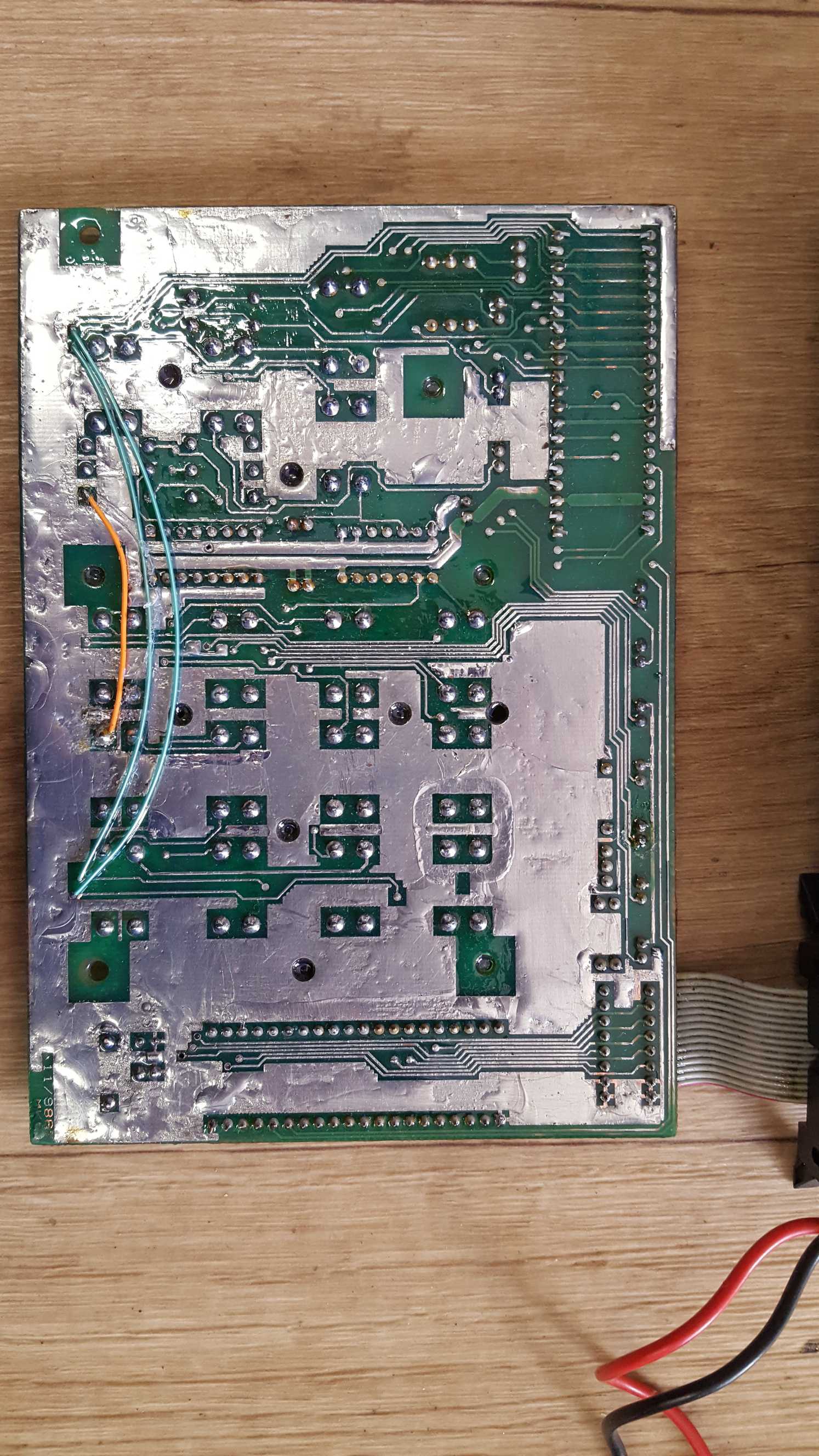

Closeup of partly done - front
Closeup of rear
I do have a circuit ... a very rough hand drawn one.
I should say segments of circuit ... as to keep it manageable I have separated the display and drivers from the keypad side etc.

As mentioned above, the board is fairly simple ... but is part of a set and only available at AUD $1100.
I'm not sure of actual numbers, but this is certainly not a one off.
A lot of boards are easy to fix and I wouldn't even consider offering a replacement in those cases ... but if you look at the Before photo above ... you get some idea of what I have to go through.
With boards in this condition ... with pcb and parts on hand I could build a new board myself in less time than it takes to fix the harder ones ... though I do lean towards having batches built for me.
I have colleagues overseas who face the same problems ... so there are potential outlets there as well.

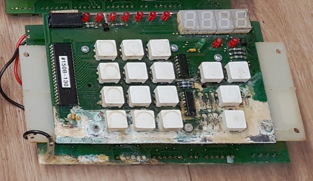

edit ... add closeup of faulty board
Do you know how it interfaces with the other board? What is the big chip on the board? It might be programmable and therefore a problem.
Edit, where are you based?
Those are all low power circuits, so there is no explicit reason for extra thick conductors. I suspect that the actual copper weight is a normal 1 oz or 2 oz, with extra solder plating hanging onto the wider traces.

The electronics on the board is very basic ... nothing sophisticated at all. The first versions of these came out probably 30 years ago and the only difference with these newer ones is the style of switch!
The board at the rear is a different matter ... I wouldn't be thinking about replicating them in a hurry. :)
The big chip is the display driver ... M5450 ... and is available cheaply in an smd version ... which I would mount on the rear to help protect it.

Yeah. That looks totally doable if you know what the board is supposed to do and what the ICs are. Only 3 ICs and doesn't look high speed or anything special so you can probably ignore most of the nitty gritty ground plane return crap in my post. It's just good to follow when you can.
Also looks like it's a 2 layer PCB though you could go with 4 if you really wanted to make routing the power and ground connections that go everywhere easier. But looks low speed so you don't even need ground planes and use jumpers where needed to cut cost.

Agreed ... unless the designers were expecting constant drownings and for corrosion to eat them away. Then thicker ones will last longer. :)
Not sure of the actual thickness ... the extra solder plating is from a previous repair. I do know when I have peeled away some of the tracks I have been amazed at how thick they are compared to many modern boards. Maybe twice the thickness at least.

Reason they want them fixed is that many of them are used on farms with 40, 50, 60 ... maybe as many as 120 of them. To put in something newer they have to buy a complete new batch ... along with the associated hardware. Absolutely megabucks.

I don't know who designed the originals but just about every bit of space between tracks is filled with areas connected to ground. Absolutely nightmare when re-tinning everything as whiskers catch me out every time.
And apart from that, trying to decypher a circuit on a board like that is nigh on impossible ... especially the rear one ... takes forever. Me anyway!
