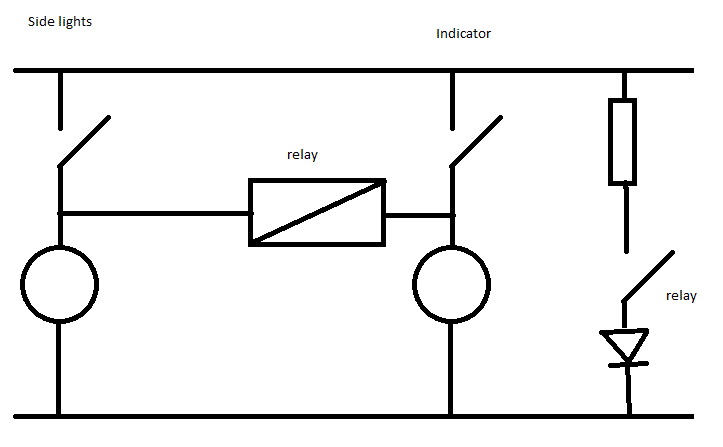

just use one relay, and then you can use bulbs or leds :)
with the sidelights off the relay pulses in time to the indicators, with the sidelights on it pulses out of time.
do i win?:D

ummmm, what?
do you have anything besides paint to draw that schematic in?

my one relay solution is simpler than your two bridges. as for my choice of cad package, would autocad have conveyed the message any better?
in case of confusion, the relay being high resistance will earth out via the bulbs, without illuminating them.
I think they're both about equal in complexity. Those two bridges are for both sides; one bridge per side. With your method, youre just using one relay per side.
So they're both very easy to do. If for whatever reason this bridge configuration doesn't work right, I'll get some solid state relays and try your meathod.
