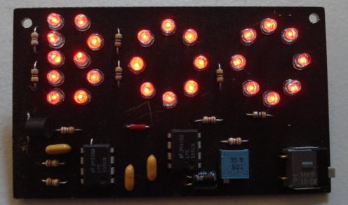

Well part of the circuit could be with LED's. I have been using a CR2032 lithium coin cell, .650 dia and.125 thick. I have blue and white LED's that are both very bright on 1 ma each. The forward voltage of the blue is 2.5v and the white is 2.5v. The attached photo is of a badge I made for haloween about 10 years ago. The LED's are blinked on/off about every second. I generally wear the badge for about 4 hours at a time. I don't remember when I last changed the battery. The letter B has two strings of 5 red in parallel, and the O's have 4 in parallel. I build a constant current source and measure the Vf of the LED's and match them and the connect them in parallel.
