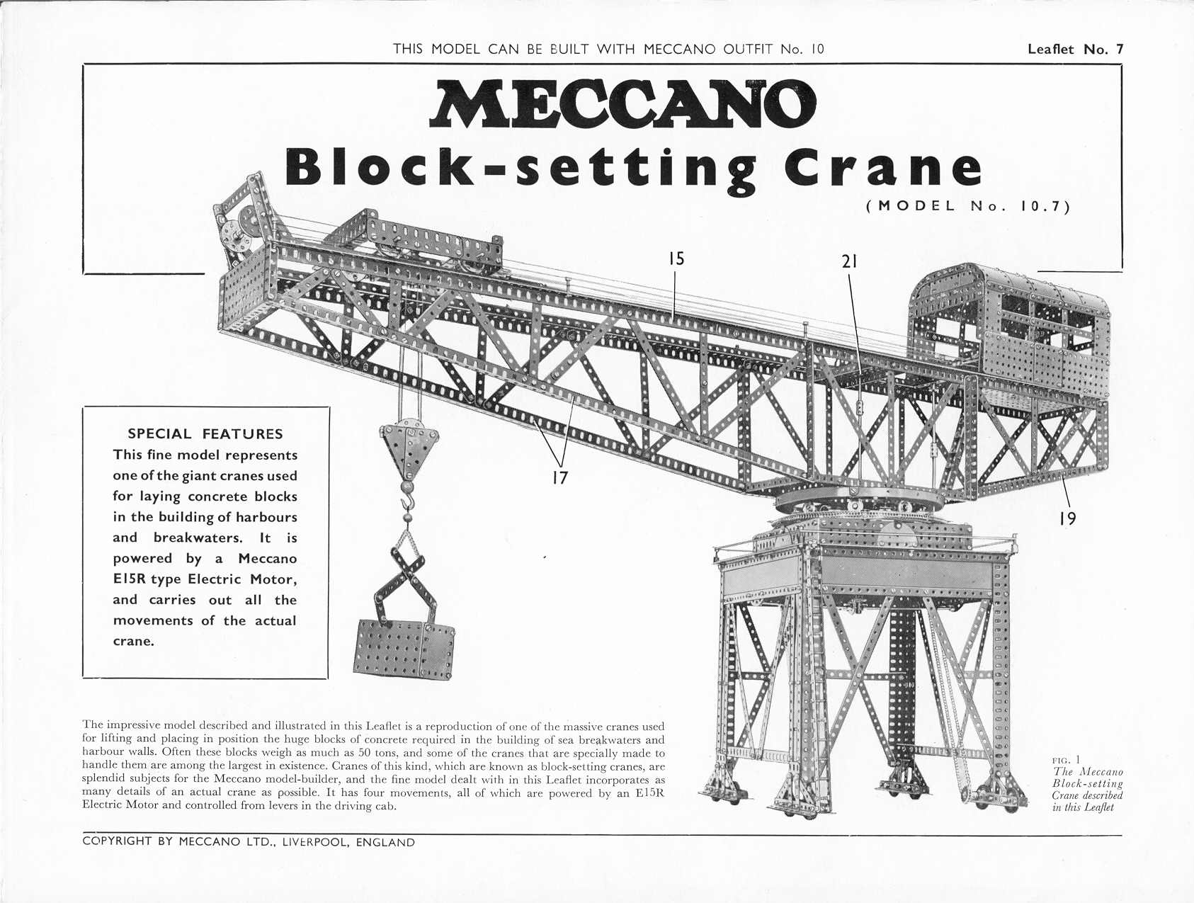

Here is a site, with actual complete plans for several models of cranes. The link is just one set I looked at, there a bunch of others, likely more crane models. This set has three crane models, with enough detail to build the models if you have the set. You can use this to copy the mechanics to suit your resources and needs. Focus on the function not the form, unless you want it to look realistic and spend the time and money doing so.
Explore the site, maybe you will find something simpler, or more to your likiing. But you will at least learn more about motors, placements, gears, pulleys, the how's and why's.
Edit: Found more detailed instructions, modern, more pictures...
