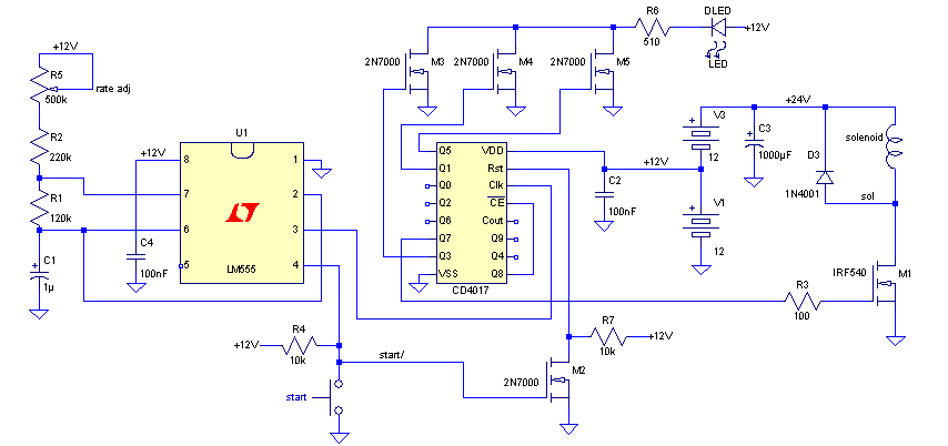

Hi guys. I know bugger-all about designing circuits and could do with your help. I'm making a pneumatic bazooka to fire baseballs for my son to practice hitting. The commercial unit (Zooka) has a microprocessor for all sorts of controls. The thing I want to replicate is the count down to the firing of the ball. The sequence is, for the first 3 seconds an LED and a buzzer is momentarily activated each second or there abouts). At the fourth second a solenoid is activated to open the valve (irrigation type) and the bazooka fires. Essentially: beep,,,beep,,,beep,,,Bang. So it's really a count down circuit I guess. It would be powered by a 12V battery. The solenoids are usually 24v. Would the 12v car battery be sufficient to operate the solenoid? I've Googled for hours and been to electronics shops without much luck. So I need some help. Does anyone have some ideas? Thanks in advance.

I would think this could be accomplished with a relatively simple sequencer using a 4017 and a 555, with a power transistor or SCR to fire the solenoid when the end of the timing cycle is reached.

I wouldn't expect a 24v solenoid to work too well on a 12 volt supply. However, instead of a single 12v car battery to power things, two 12v motorcycle batteries in series would give 24v and plenty of current to operate the solenoid valve. Together, they would probably weigh less than the car battery, too.

I've got a circuit for you, unless your solenoid draws a lot of current. Do you know how much it requires (at 24V), and how long it has to be energized in order to pitch the ball?
Ron H, I believe the solenoids draw a max of 1 amp though most only draw 3/4 of an amp and are open for a second or so.

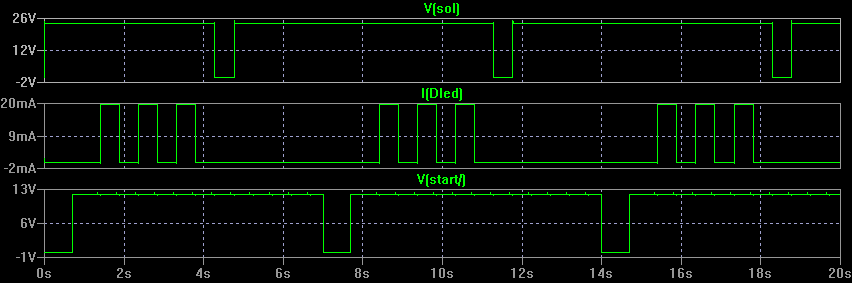

Here is the schematic and waveforms for the start switch (bottom trace), LED current (middle trace), and solenoid voltage (top trace).
You can use a different MOSFET for the solenoid driver, as long as Rds(on) is less than about 0.5 ohms. The other MOSFETs could be replaced with NPN transistors, each with a base current lmiting resistor. Alternately, the LED drivers could be NPN emitter followers, which would save you the base current limiting resistors. I just happen to like 2N7000 (or 2N7002). 8)
The rate of LED flash and the time until the pitch is adjustable with R5, and could be changed to basically any rate by changing C1.

Wow, Ron. Your circuit is nearly identical to the one I have drawn up, with a few differences. My circuit uses bipolar transistors instead of mosfets. I also diode OR'd the Q1,3,5 lines and use only one transistor to drive an led and a beeper. I also have a transistor driving a "ready" led on the Q8/-CE line of the 4017. I let the 555 free-run and use a momentary switch to reset the 4017, starting the sequence. With those few execeptions, our circuits are virtually the same. What sim program are you using?

Jeff, I drew and simulated it on LTSpice (SwitcherCAD III). Great minds think alike. :lol:
I reset the clock with the switch so the delay time would be exactly the same each time you release the start button. I forgot to put in the buzzer, but it can just be put across the LED/resistor.

Mr. EM, For my info, I take it those inverted triangular icons at the ends of the "wires" are just a different symbol for earth or a common (-) bus of the circuit?? :?:

Yep those inverted triangles are for earth. Now you mention you're going to Jaycar so I assume you are in Oz. I find it pay to look at the prices of the components and compare them with Dick Smith, Alltronics then Jaycar. I just got the new jaycar cattledog and man have they ramped up the price on most stuff so I tend to give them a wide berth where I can. Depending where your located there might be some other shops that kill the big 3 electronic ripoff merchants for price so it will pay to look around. I know the component count won't cost too much but this advise is for the longer term mainly.
