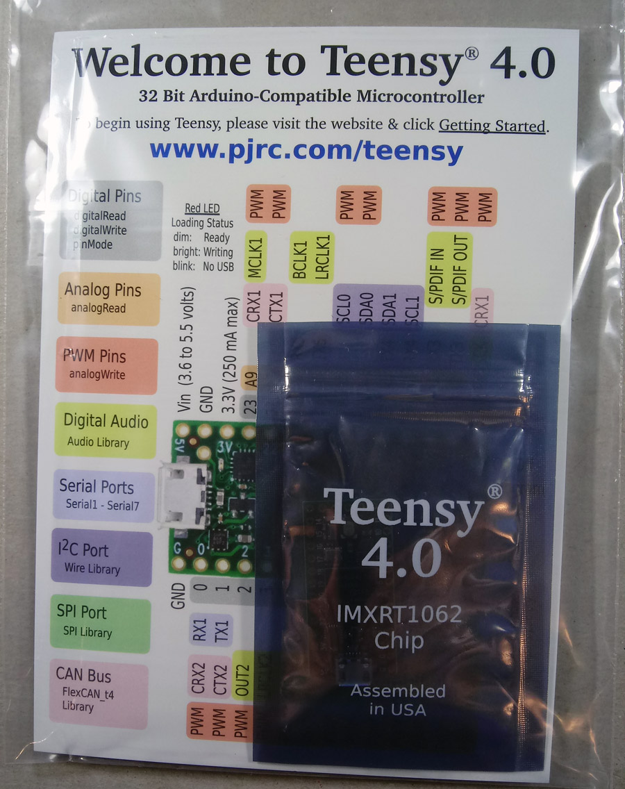

Couldn't resist ordering one of these [Teensy 4.0] today.

I don't know what I will do with this it but it does appear that I will be doing it faster than I would without it [Is that a reason? Yes, I think so]. I don't care, toys are fun.
It does look impressive.

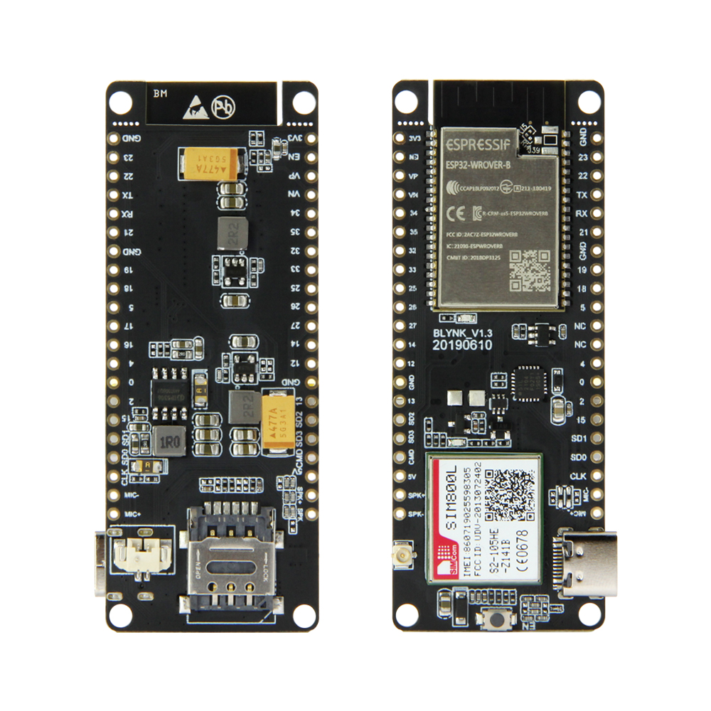

Well I couldn't resist these, so I ordered 3 :D arrived today - but they use USB-C :banghead:
I don't have a USB-C lead :arghh: - so 've ordered one of those, from RS Components, so it'll arrive Monday. However, I've fitted a SIM card, soldered a couple of 18650's to the end of the battery lead - and admired it a bit :D

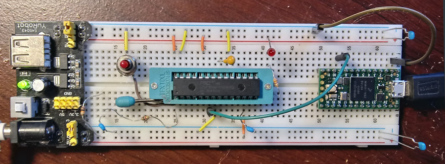

Today, I decided to check out the Teensy 4.0 and I had something particular in mind.
Intermittently, I have been exploring the PIC32. In particular the MX270F256B. It is available in a through hole DIP in both 40MHz and 50MHz maximum clock speeds. I was exploring using the internal RC oscillator rather than an external crystal. You have to set up some multipliers and dividers to get the speeds. Specifically, I was testing using both 40MHz and 48MHz clocks (there is no way to get 50MHz using the RC as far as I can see).
I wanted to see if I was setting the oscillators correctly for 40MHz and 48MHz.. Not the absolute accuracy but was I doing what I thought I was doing with the oscillator set up. I should mention that I don't have a real frequency counter.
I used a simple program that toggles an IO bit on the PIC. Then I used the Teensy 4 to measure the frequency (there are actually a few example programs for frequency measurement).
So: 40/48=0.833. At 40MHz, I read toggle frequencies of 3337142 and at 48MHz, I read 4002718 (the last 3 digits will vary but those are typical values that I saw.
3337142/4002718=0.833.
Nice.
