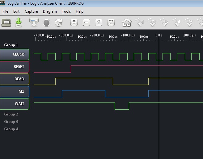

As far as I can see the 16 address bits are stuck .. possibly all at 1's ...
Yes, this is exactly the problem.
All address lines are set to 1 after a few clock cycles have passed, and remain at 1 indefinitely. There is no counting so the CPU does not increase the program counter.
Still here ... I have the Z80 pensioner :) under PIC control, signals more or less as DS ... the Reset ( PIC generated) shows how first instruction fetch is achieved ,(M1 & Read ) the wait (PIC generated ) allows control over memory access. just in the process of designing a better control circuit... ( Bus Pirate is ace )
Z80 clock at +- 20khz
HE if your reset switch bounced during or after zero state , or not low for the 3 clocks , then Z80 = unknown state ?
What is zero state? The state the CPU enters when RESET is held low?
