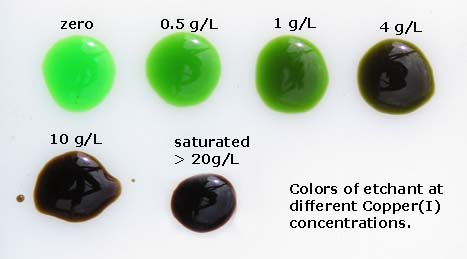

When the solution is active, it is bright green. If the solution appears olive drab or has any brownish character to it, it is not completely oxidized to cupric(II) chloride. A small drop against a wjite background will show the brown. Have you seen Seychell's how to do it? Unfortunately, Chrome gives a warning for the site now. This picture is from that description. The upper left dot is fresh cupric(II) chloride. Copper(I) is not active. So the more copper(I) the more exhausted the etchant is.

As for air regeneration, that is what I use, and I just go by color. Overnight bubbling will probably work. I have never timed it. At this point, however, I suspect you have very little cupric chloride and will need to depend on the peroxide to get etching. That is why I suggested starting with figuring out the type of peroxide you had.

The colour is of the 2nd one so 0.5 mg/l? Do you have a link to Seychell's?
