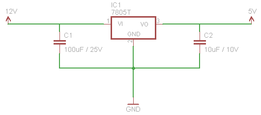

hi. i just wanted to build a travel charger for my psp. i want to use the 12-volt supply from a car. i already searched the net for the schematics and now i'm having problems with the output rating of the circuit. i saw on my psp charger that it outputs at 2000mA while the rating i found on the net has only a max output of 600mA. how could i get it to up to 2000mA? another question, will the input current rating of the 12-volt supply from the car affect the output of the circuit?

Yep, LM7805 can handle up to 1 amp without a heatsink.
Once you add a heatsink, you can go up to 2+.
Its very easy to use, only three pins: Input, Output, and Gnd.
You should also place some smoothing capacitors befor and after the regulator, to make sure your device gets nice smooth DC.

It's the 2 amps that's the killer. The 7805 is the best bet. Circuitry is simple - any number of examples on the 'net - and with a decent heatsink will manage the current just fine. If you fit it inside a metal case (tobacco tin, etc) you can use it as the heatsink.

The 7805 already has a little metal tab on it. That's why you can take it up to 1A without a heatsink.
After that, you need to dissipate more heat. I have taken a 7805 up to ~3A, its really just a matter of dissipating the heat!
Here's a typical setup for a 7805.
The capacitor are there to smooth out any ripples in the DC.
You could also add an LED to show it's working:
And for heatsinks, here's a link to some that may work.
Bigger is always better when dissipating heat.
TO-220 Heatsinks
The 7805 can only carry 1A without a heatsink if the voltage drop across the device is not much more than a volt. In this application it will drop up to 9V, which will generate up to 18W when supplying 5V at 2A from a 12V (14V with engine running) source. Thus it's going to need a pretty healthy heatsink, probably one with no more than about 2.5C/W thermal resistance to air.

I think you should try to modify the original Black Regulator for 2A.
Change Q1 to another PNP with a 6A or more rating (such as TIP42), D1 to a higher rating, and get an inductor rated at 3A or more.
Use LTSpice to test your changes before building it.

This is still destructive to all components involved unless the design allows for safe removal of 18+ watts. I see no good reason to build a 35% efficient power supply when it's not so hard to build one that's 90% efficient.

I'm not so concerned about waste as I am of the problem of finding a safe location for an 18W heat source in an automobile cabin.
