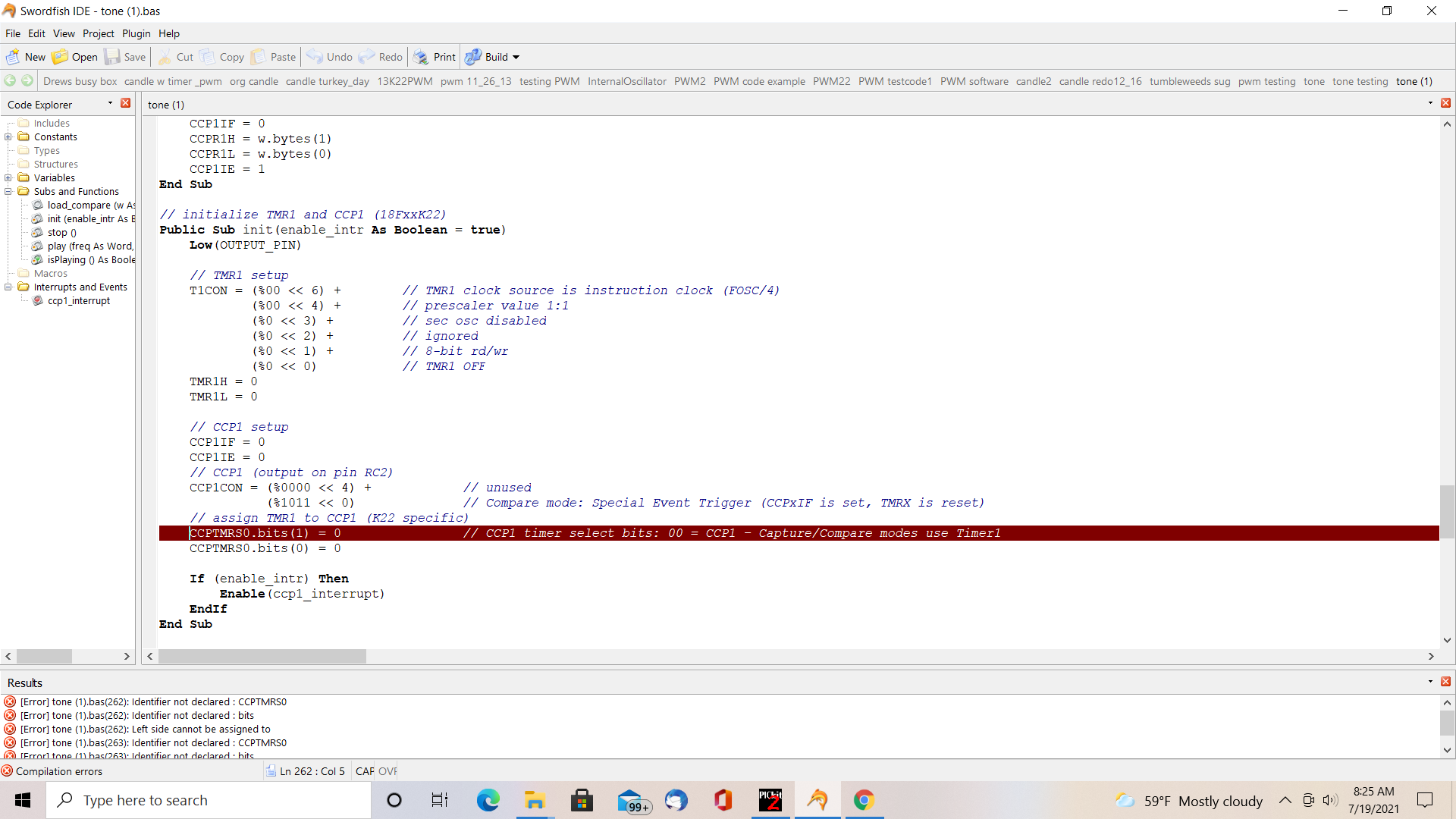

Here is a port of the arduino Tone library for the 18FxxK22
tone.bas:
// port of arduino Tone library for swordfish
// (device = 18FxxK22)
module tone

// initialize TMR1 and CCP1 (18FxxK22)
public sub init(enable_intr as boolean = true)
    low(OUTPUT_PIN)
    // TMR1 setup
    T1CON = (%00 << 6) +        // TMR1 clock source is instruction clock (FOSC/4)
            (%00 << 4) +        // prescaler value 1:1
            (%0 << 3) +         // sec osc disabled
            (%0 << 2) +         // ignored
            (%0 << 1) +         // 8-bit rd/wr
            (%0 << 0)           // TMR1 OFF
    TMR1H = 0
    TMR1L = 0
    // CCP1 setup
    CCP1IF = 0
    CCP1IE = 0
    // CCP1 (output on pin RC2)
    CCP1CON = (%0000 << 4) +            // unused
              (%1011 << 0)              // Compare mode: Special Event Trigger (CCPxIF is set, TMRX is reset)
    // assign TMR1 to CCP1 (K22 specific)
    CCPTMRS0.bits(1) = 0                // CCP1 timer select bits: 00 = CCP1 – Capture/Compare modes use Timer1
    CCPTMRS0.bits(0) = 0
    if (enable_intr) then
        enable(ccp1_interrupt)
    endif
end sub

I downloaded Tumbleweeds code and module but the module won't compile?
Made suggested changes as per Visitor and will give it a try.
What version of swordfish are you using (open IDE Help | About...)?
If you're up to date it should say "Version 2.2.3.6 - ICC 1.2.0.7"
What error message(s) do you get?
I'm going to go out on a limb and assume you have an older version that doesn't support
declarations with initializers.
Try using the attached version instead. It compiles fine for me using the 18F43K22

IT won't compile
anything with CCPTMR

I still get the same errors.

If you are getting the same error, you didn't follow exactly the steps in post #36. Follow those steps exactly as written.

Have you copied the example code shown in the post, save it to a file, and compile it?
What device do you have it set for? The CCPTMRS0 register is in the 18F43K22 (all of the K22 devices, actually)
If you downloaded the SE version you got SE 2.2.3.6, and it compiles ok there too.
