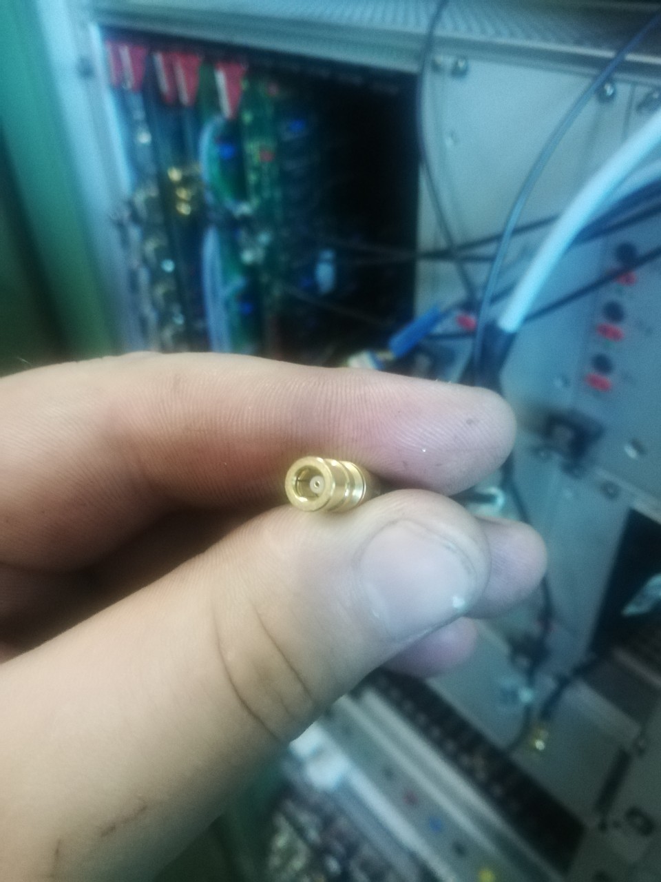

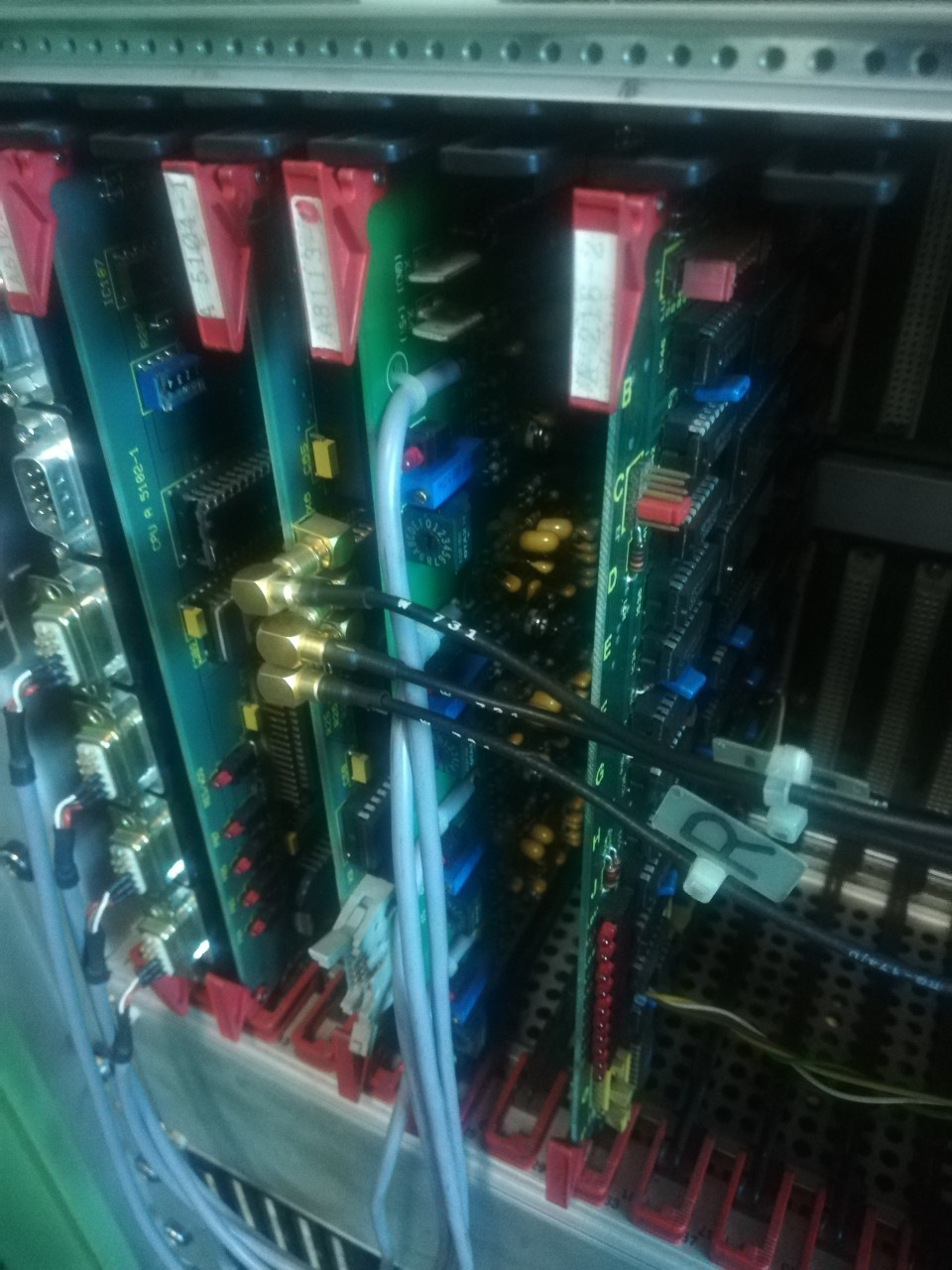

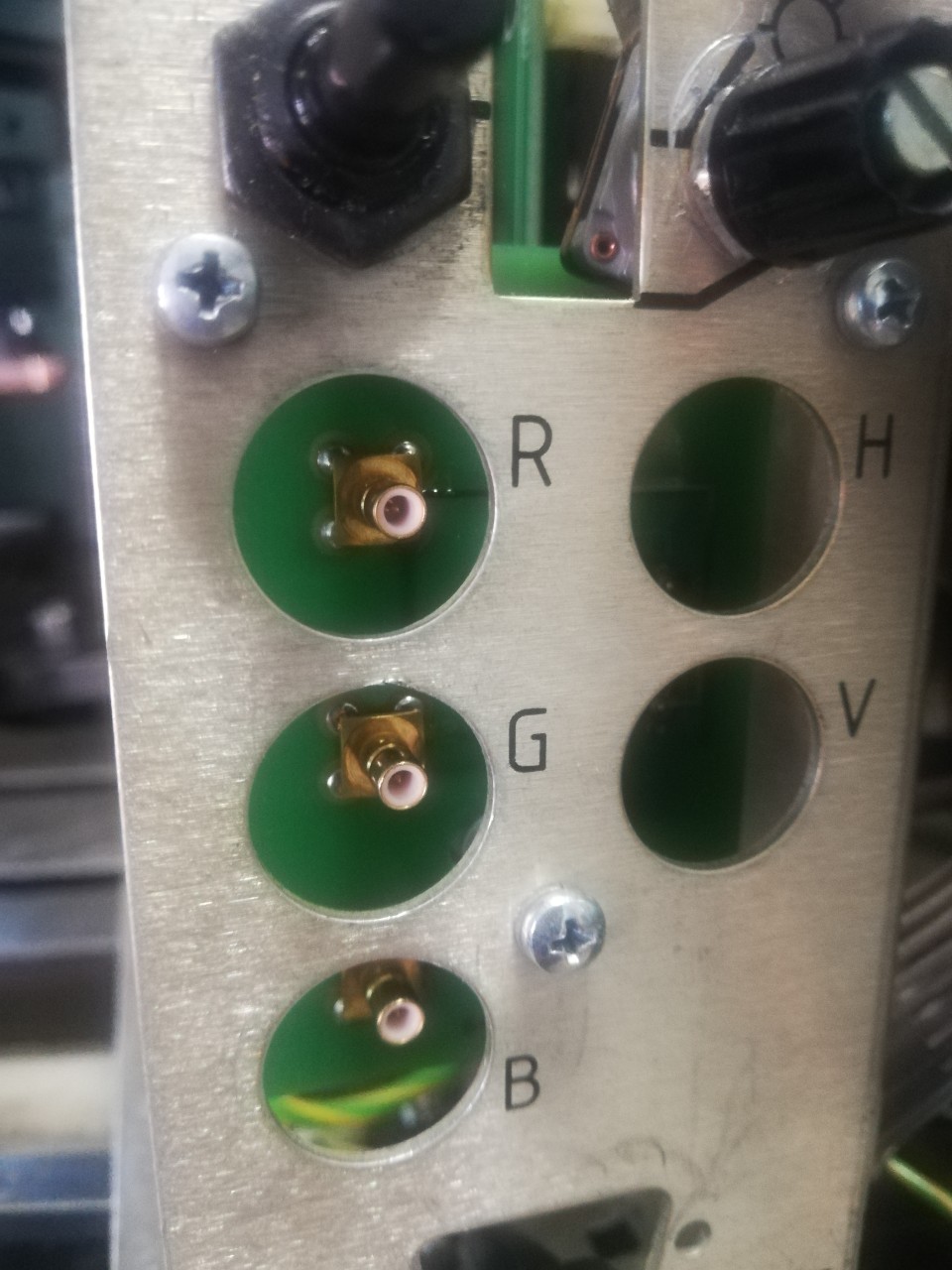

This is pictures of output connectors from machine (Connectors_on_machine.jpg), connectors which are connecting to monitor (bnc_connectors_for_monitor.jpg ) and input connector on monitor (Input_on_screen.jpg)

OK, it's using SMB coax connectors - I've never seen those use for video before.
Do you have access to an oscilloscope to see what the line and frame synch frequencies are, looking at the green video signal?
