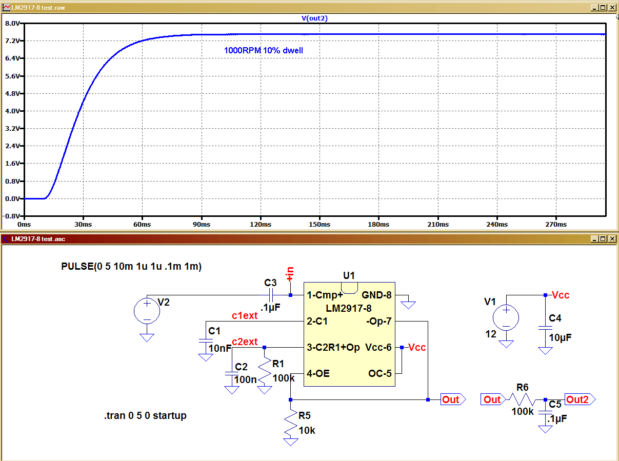

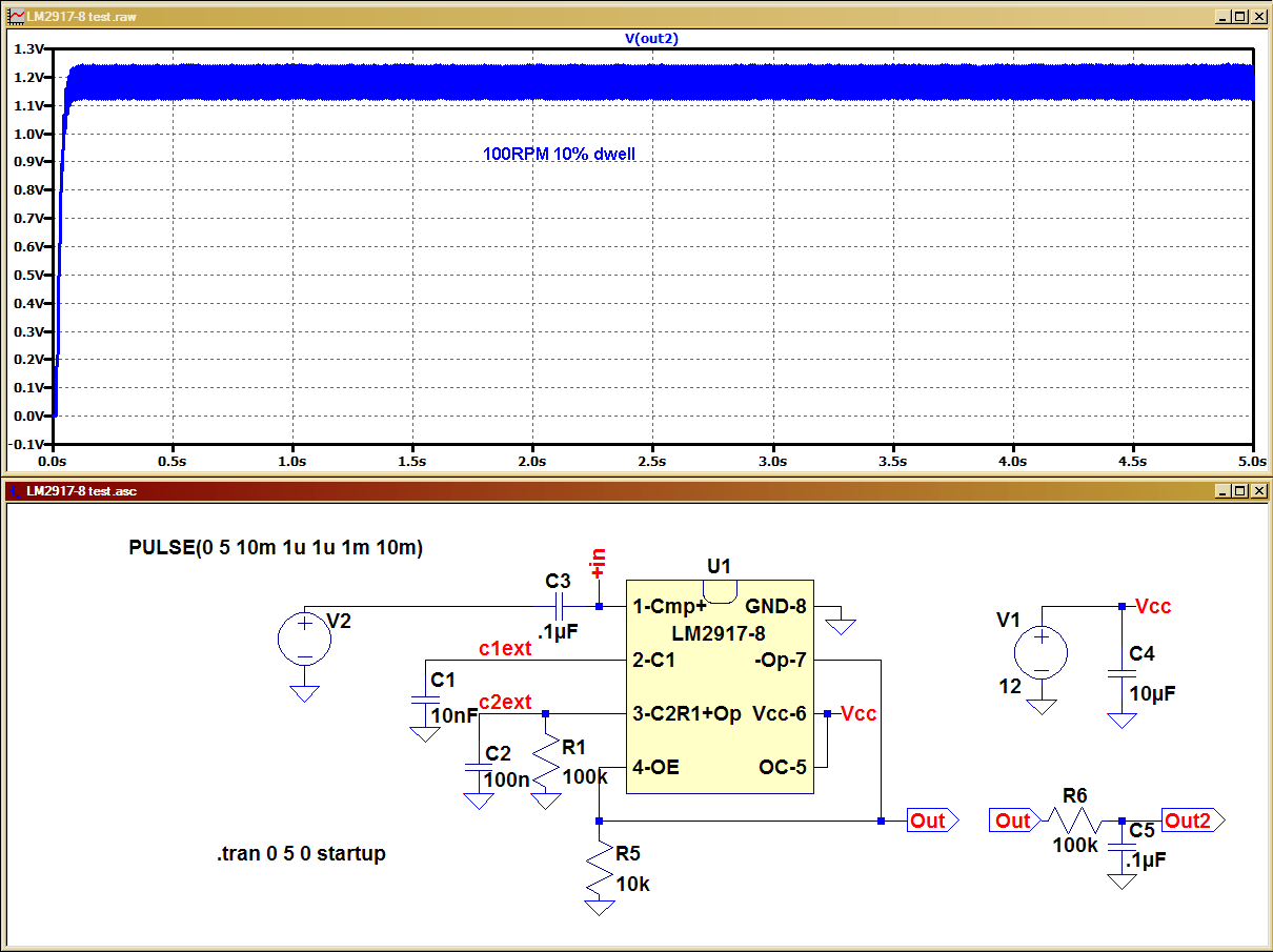

hey forum. i have a hall effect sensor, measuring the RPM of a wheel, with one magnet attached to the wheel. every time the wheel magnet passes from the sensor, it goes low.... so, one pulse per revolution...
i want to convert that signal, to analogue... 0 rpm = 0volt, more rpm = more volt (max 5v)... any ideas how can this work??
i have found LM2907 , which is an Frequency to volt converter, but it is supposed to work with VR sensors (who outpout -V as well). do you think it would work with a hall effect sensor switched to ground??
what else could work?? thanks!

The LM2907 should work OK, do you have a datasheet to post for your Hall effect sensor.?

If the Hall effect works with a 5V supply and its output swings from approx 0V to ~5V, it should not be a problem driving the Lm2907
its something like that for sure. BUT , the otpout is 5v, and swings to 0v ... (so its 5v most of the time )

after all, i managed to find, lm2907 with 16pins, and Lm2917 with8 pins.... do you think that the wire up should be the same???
The datasheet for the LM2917 shows similar circuit examples as the LM2907.
So either type should be OK.
Have you considered the 555 option.?
This is a rough idea of the Vout you will get, the actual Vout will depend upon your components.

i cant seem to be able to get it to work.... i could see the lm555 as well, but i dont seem to be able to find a a good circuit describing how... :/
Please post your circuit and if possible a photo on how its connected, it should work.
its like the one you posted, but :
i give direct dc to pin one, with a pushbutton (although i tried with a 22pf cap)
c1 = 2.2uF
R1= 100k
and i also have no C2, but i think that this is for ripple only....
