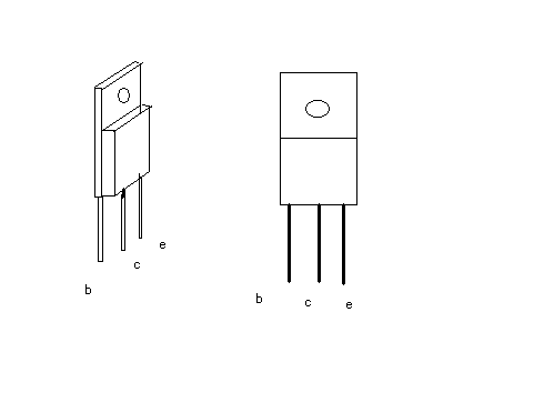

It will work just wire it up right look at back of the box the pin out is not the same as the 2n4401 The tip 120 is base collector emitter make sure you don't ground the base to any thing
Here look at this

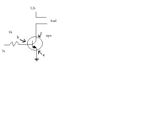

Just use the drawing I made you and hook your tip 120 up b to b e to e and c to c
