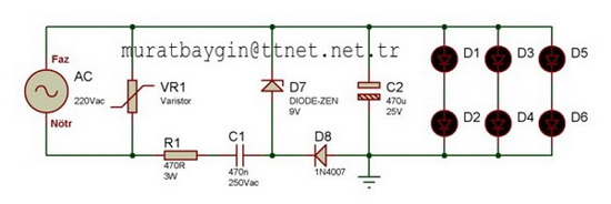

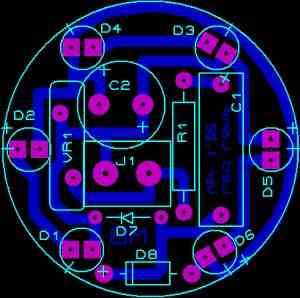

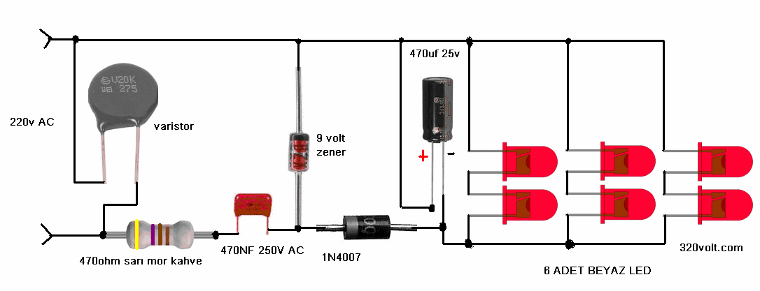

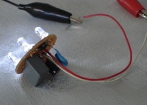

Hi I found one circuit

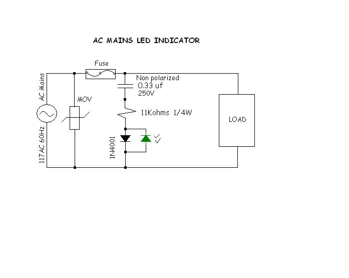

Hello guys, I was looking the treads to see if someone has made a simple Ac monitor led, is for my power supply that is a little far away from me and I need a led monitor to see if the PS is working.
I saw the formulas for Xc and I'm interested to know why you not considered the dropping of 0.7v of the diodes and also the input AC voltage should be considered RMS or peak ac voltage?
My AC line is 120vAc at 60Hz.
Could someone can explain me why?
Thank you for your time.
You should calculate for RMS unless the peak voltage will violate the electrical specs of your LED. Why don't you use a simple incandescent bulb? A small night light bulb would work nicely.

Thank you Sceadwian for your kind input and advice, but the room of my power supply is too small and I need something smaller.
I imagine that for the type of led and for the purpose the diode voltage should be insignificant but I think if we make calculus for peak voltage of 117vAc the led will long last, don't you think?
In my calculus 117 rms x √2= 165.46vpp
Current for the led 16mA
therefore R= 165.46vpp/0.016A
R= 10341
So R=10Kohms commercially.
I do not pretend to show off, I just want to know if this could be correct in order to be safely and a long life of led.
Please, if I'm wrong let me know, I would appreciate your input and everyone here will learn about our mistakes right?
Greetings
P.S. Excuse my english and spelling, I'm still learning.

I'm sorry guys, I did not recieve any email notification so I did not write to tell you that I have the right circuit for my power supply.
Thank you all for your help and inputs.
I have the circuit and I will upload so everybody can see it.
