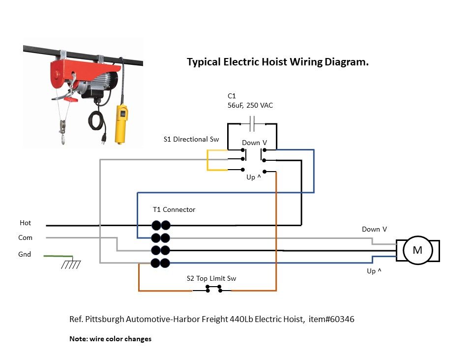

And this is a diagram for a smaller Pittsburgh hoist, probably quite similar to yours:
Although it is drawn very differently, the actual wiring is the same. The capacitor is permanently across the top and bottom motor wires, the centre wire is neutral and the live/hot is connected to either the top or bottom motor wire via the control switch.
Though yours may have contactors or power relays in the motor junction box, rather than the full power going through the pendant switches. If it does, you could use the garage door controller relay contacts to emulate the pendant button contacts.

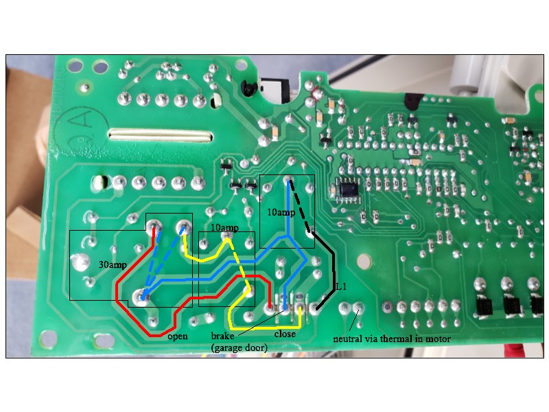

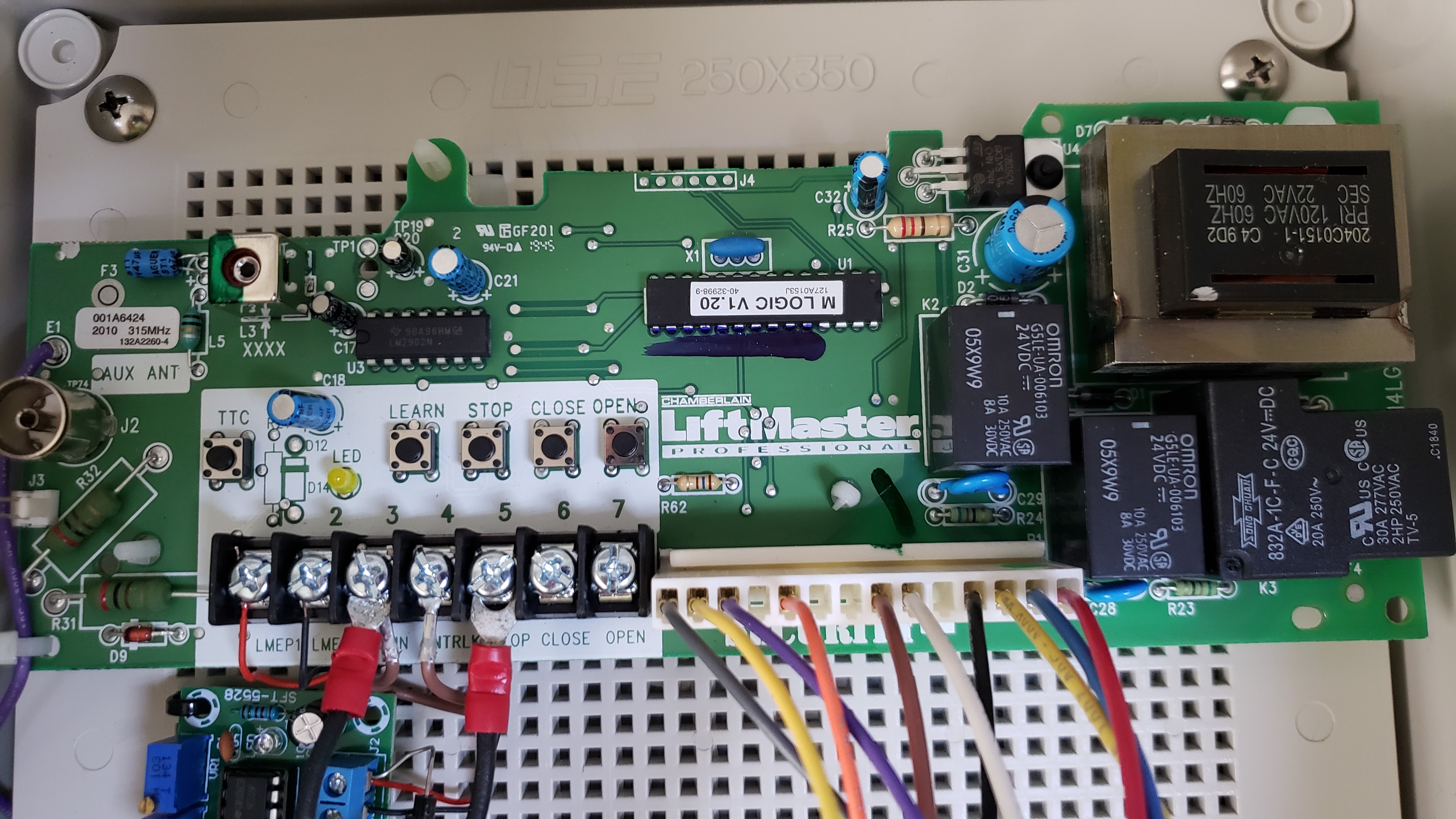

If I am reading this control board correctly, it appears that it already has a 30A relay for the open (lift) circuit and a 10A relay for close. Possibly the 10A relay assumes a no-load start and run condition. I would think the hoist would be similar, but I'll check the no-load amps prior to connecting. The capacity of the hoist is not an indication of the proposed loads. My platform and carriage assembly weighs about 50lbs. and because of its low profile design, 250lbs. positioned in the center of the 3'x3' platform is about as much load that I'm comfortable with. It's original intent was to lift construction material to a second floor deck of my house for a renovation project and became so handy that I decided to upgrade and make it permanent. And yes, I'm sure my wife and I will occasionally ride it, as well. For safety's sake, there is an emergency power shut off switch that will not not run through the control board, and I've been mulling over ways to incorporate an automatic braking system that would engage should the carriage start to descend to quickly.

Relays and contactors have different capabilities based on the type of load being switched.
Thermal rating - how much current they can stand with the contacts close.
AC1 rating - for switching resistive loads such as heating.
AC3 rating - for switching inductive loads and specifically motors.
Looking at the big relay, it's rated 20 / 30 A resistive load; ie. what it can stand with the contacts closed.
It also has a rating for when switching motor loads (AC3 class) and that is 2HP; 1500 watts, at 250V, so about 6 - 7A rating for a motor.
The smaller relays do not have an AC3 figure given.
However, (if I've found the correct Chamberlain manual) the garage door motor is only 400W and the PCB tracks & wiring connecting the relay power circuits are likely to be sized based on the expected current load for that motor; the tracks are not particularly large.
An induction motor typically takes around 5 - 6 times its rated current for a short time as it starts and accelerates to working speed.
It will also give a significant inductive "kick", a high voltage spike that causes contact arcing, if the contacts open while current is flowing. (The board has R-C snubbers across the two sets of motor windings to damp the voltage spikes.)
That means motor control relays/contactors generally seem over-sized in well designed equipment, so they can cope with the current surges and spikes without problems.
I'd use the garage door board to switch a couple of properly rated contactors, a "reversing pair" setup fitted with electrical and mechanical interlocks, plus a thermal overload to protect the motor if something jams.
