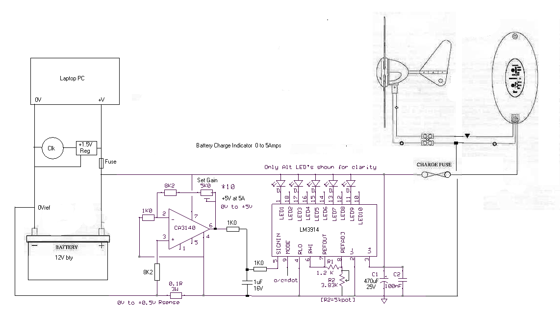

hi Dave,
Have a look over this circuit.
Any questions please ask.
The LM3914 is configured as a DOT display and when set up correctly it should indicate as follows.
No wind, no charge, no leds lit.
Charging at 0.5Amp, led#1 lit, charge 1Amp led#2 lit and so on upto 5Amp when led#10 is lit.

Sounds great - Yes, I use veroboard - is it too difficult to change it so that it is a barchart rather than a dot display -from where the kids will see it routinely (the project is based in a courtyard in the middle of the school and the kids won't be allowed in unsupervised) a dot display won't be as impressive, though if it is an issue (current drain, circuit complecity etc) I can make a very visible scale at the side of the LEDs
As my granny used to say - "bugger me": I've just looked at the diagram - stunning! DAve
Its easy to change to bar, a single wire repositioned.
I opted for a dot just to keep the current to a minimum.
You could use high brightness leds, blue looks cool.!
Do you think you can build it OK.?
If you want to proceed, let me know I'll sketch a vero layout.

One concern - Will the regulator mess things up by limiting the current we are measuring as the battery approaches full charge?
I'm really looking forward to assembling the circuits. The last couple of circuits I built have been running (as they say) 24/7 x 365 for 20+ years - being flashers controlled by 555 chips in alarm boxes - I'm not being cocky, just amazed at the reliability of electronic components! Dave
Yes, I would assume the regulator reduces the charge current as the battery becomes charged. You could perhaps instead monitor the generator current but that depends upon how the regulator controls the battery charging current; whether it just dumps the excess current into a load resistor or actually reduces the generator current.
Dave
The regulator is designed to reduce the voltage/current to the battery as the battery becomes fully charged, thats what its supposed to do.
If the regulator kept pushing current into the battery when it was fully charged it would over charge, cause gassing and possibly damage the battery.
As one would expect the current will reduce as the battery nears its fully charged state and the LM3914 leds will indicate this reduction, which I would expect is what you want.??
Im assuming the battery is a sealed lead acid.?

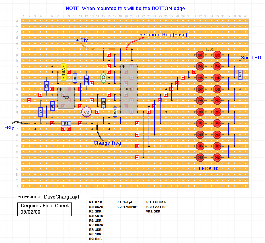

hi Dave,
Look at this image, check it thru.:)
Attached is a LM3914a.txt file, download it and then change the name to
LM3914a.diy, it will then be readable with DIY Layout Creator, have a play.!:)
Are you going to use Blue LED's.???
Note: you cannot place 4mm LED's on a 0.1inch pitch.

Downloaded and converted! I'm now trying to relate the schematic to the layout :)
A couple of queries: R9 is coded as RxR
C1 is coded as 1uFpF
C2 is coded as 470uFnF
- I'm assuming u = micro(n), p = pico and n = nano so is, for example, C1 a 1 microFarad or 1 picoFarad or am I missing something?
I'm also unsure about the wires:
Is -B to the negative battery terminal?
Wire 3 (looks red) to the positive battery terminal?
Does wire 2 connect track s to track v or is it connected to track s and supposed to connect to something off the board? Track v doesn't seem to be connected to anything else
Similarly for wire 4 (pale orange) does it connect tracks e and f?
Dave :)

hi
R9 will be determined when we know the LED forward volatge drops.
The coding on the program has gone a little strange.!!!
C1 = 1uF
C2 = 470uF
-B is the battery neg - terminal [green] track 's'
+B is the battery pos + terminal [brown] track 'f'
The -Charge Reg wire goes to the 's' track , end of the R1 resistor
The +Charge Reg [fuse] goes to track 'f'
I always put the wire 'label' at the free end of the wire,,, the end that goes off the pcb.
Hope thats clear.:)
When we finalise the design and layout we will make the component labels correspond on the dwgs.

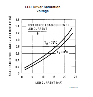

IMO the LM3914 would be well over stressed at 30mA for all 10 LED's in bar mode.
The circuit I suggested is not suitable for the revised application.
OK - I'm flexible! What LED's could I use? I only wanted the biggest because they would be the most obvious, but I can happily go for smaller/less bright! What aspect of the LED's is too much? The standard 5mm LED's that Maplins sell are 2.5V and 25mA. Could we miss out some of the LED's and just have 5, 6 or 7 etc? Dave
Its the current thru the leds/LM3914, look at this graph, I would suggest we stay within the 20mA limit.
Im using high bright Blue leds at 12.5mA and I can see them very clearly in daylight from about 5 mtrs.!
I think if you limit the number of leds to 5, its only going to show 1 amp increments.
EDIT:
you could do a bench test with a resistor set to give 20mA thru a 8mm or 10mm Superbright red LED.
From say a 12V supply, use a 470R resistor to one red led, see if it meets the brightness required. Dont forget you could have two in series on the LM3914

The current thru the leds is fixed by that R1 [2K0] at about 10mA at the moment.
Having two leds in series will have the same current.
The LM3914 is a constant current output.
The resistor isnt to limit the led current, its to reduce the heating of the LM3914.
