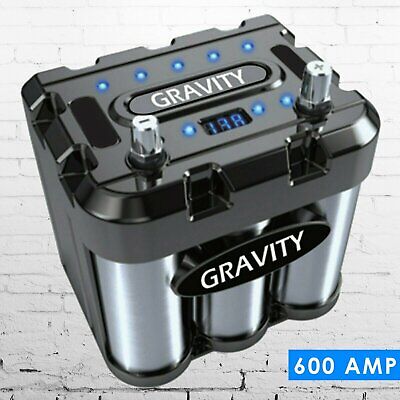

Would this work for my battery Gravity Audio GR-800BC 800A Car Battery Capacitor WITH LED & Black Chrome
118592
That appears to be a capacitor sold to gullible audiophiles. You need a battery.
A 12V 18AH battery is able to supply approx 200WH and so that battery will power your 80W motor (at maximum load) for about 2 hours. Is 2 hours long enough? Paralleling will add more hours.
