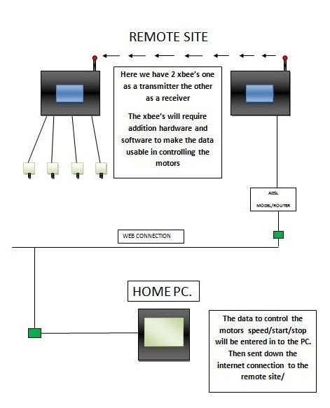

Hi
Please correct my assumptions.?????
So lets assume for now that the Xbee is the tool for the job and I would require two, one set up to send the data from the remote site Internet connection and the other to receive the data and feed the motors.
Again clear up my thoughts each xbee will also require additional hardware and software to make any sense of the data.
The Xbee that will be connected in to the remote site modem will require a breakout board and some other kind of hardware that is able to do the sorting out of the data from the net connection.This will also require software to enable the secure web connection from my home PC.
The xbee at the motor side will also need a breakout board and again additional hardware to feed the motors with the required data.
Cheers for helping, just a few questions to clear any thoughts.

The XBee modules will require a PC or some other device to connect to the ADSL modem, and can be USB or RS232 depending upon what ports you have avaiable on the PC or other device. The only way to do what you are asking (control motors over the internet/LAN) without using a PC is to use the XPort or something similar. Check out the XPort, SitePlayer, Microchip's Ethernet PICtail daughterboard, etc. You will most likely need to program a micro-controller or micro-controller like device. I believe the Xport is an ethernet to rs232 bridge type device, you would then connect that device to a separate micro-controller to control the motors, or for completely wireless operation the bridge device to an rs232 based XBee module.
My suggestion, since you stated earlier that you were more interested in learning how to do this than in just buying a product you can plug in and use, is by some micro-controllers (PICs since you say you have a programmer), download or buy a compiler (Basic, C, Pascal), some h-bridges, momentary switches, and other various components, and learn how to control a motor from switches connected to a micro-controller and work up from there. It will be much more rewarding to turn that motor on using something you built yourself.
If you decide to go this route just come back here with any questions and people will be glad to help.
Hi Mike
Cheers for the info.
I have looked at the Xport as suggested by Bill and that does look an interesting tool.I have now looked briefly at the your other ethernet suggestion and am quite interested in the siteplayer.
I'm sure that connecting up a siteplayer ethernet to rs232 to an xbee should be doable.
I take your advice and will look deeper in to it.
