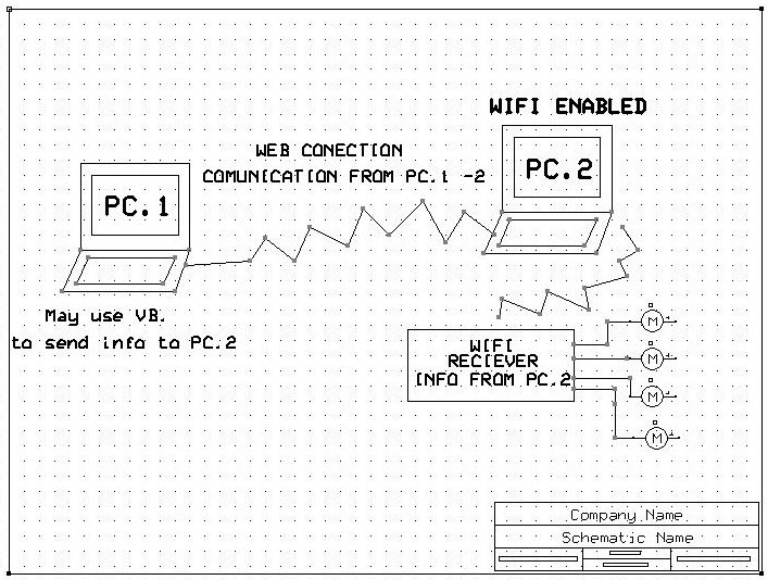

I'm looking for advice and suggestions for a project I have in mind.
I'm looking at controlling a group of small motors (around 4) from my home PC. but the motors are situated away from my house.I require full control of these motors, speed ,start and stop all independent.
The motors won't be hard wired to any PC. or phone line,I want these motors to be controlled wirelessly by wifi connection.The remote side will have a PC. and an Internet connection and wifi enabled.
I've been googling looking for inspiration and I've come up with a couple of suggestions on how this might work.
To get a platform to control the motors I could create a programme in VB.(visual basic) and at the remote side I could use the Wiport by Lantronics and a breakout board to my motors.
WiPort - 802.11b Wireless - 802.11g Wireless - Lantronix
Any other suggestions on what software and hardware to get the communication between my home PC. and the remote motors would be welcomed.

If you are going to use WiPorts then you do not need a PC at the remote location. They will connect to the WiFi router. You will then write a webpage that is stored in the WiPort and accessed from the PC in your house. From reading the advertisements for this product in magazines it appears that they come with sample applications that should be modifiable to do what you are talking about. Download the Product Brief and documentation and read it to determine if this is not the case.
It says it does serial or ethernet? Have you look at the Xbee? They are low in price and have a pretty good range. And have some control on the boards as well.
XBee & XBee-PRO 802.15.4 OEM RF Modules - Digi International
You will still need a PC to signal the remote modules. The set I am using is going 50+ feet through walls in a commercial building.

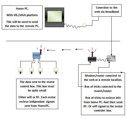

Hi
After looking at the Wiport and the xbee I think both have a downside.
If at all possible I think the best route for the remote side would to be created a device that could be hooked up to a modem/wifi router that would receive the data from my home pc.This device could either send the data to the motors either via RF. or wifi,
The xbee if I'm not mistaken does require a pc.? so a downside on that.
The Wiport seems to suit all my requirement but at £113 just for the prot it seems a little steep.
requirements-
Visual Basic/ java or similar (home pc. side)
box of tricks connected to the net via modem/router with either wifi or Rf. transmitter.
Box of tricks hooked up to the motors again either wifi or RF. receiver
I think the box of tricks connected to the net would decode the data from my home pc. making the components connected to the motors to a minimum.
Cheers Mark

I have 4 stages I want to cover-
1. what software I use on my home Pc. ie.VB.
2. A device connected to the remote net connection (distance not an issue as going over web) that receives the info sent from my home PC. and then sends the data out via RF. or wifi to no.3
3. A device hooked up to the motors that receives the info and manipulates the motors accordingly.
4.The coding within the remote device (2) that will allow it to accept the data from my home pc and then send it out.
Hope this helps.
Cheers Mark

Hi Bill
So to simplify for my benefit you suggest use an XPORT.This as I see it would require a PC. at the remote side? and when up and running would basically act as a very long serial link ie. from my home PC. over the web to my remote pc. ?
Only trouble is if your suggesting connecting these to an H-bridge then to the motors I want to control all 4 motors from one output but independently.
So could I connect the Xport up to say an RF. transmitter and then put a receiver and a PIC. with the motors?
