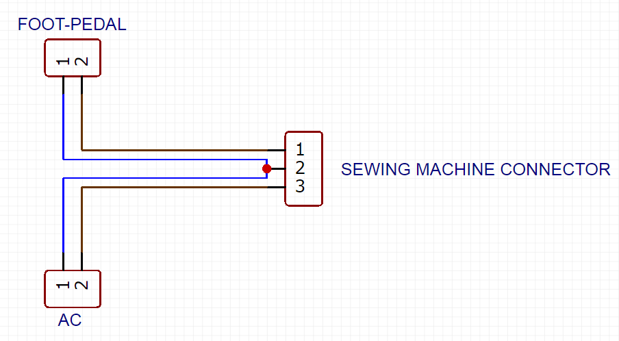

Hello,
First of all, please apologize for the potentials language issues, English is not my native language but I'll do my best :)
For a little project, I'm trying to control the speed of a sewing machine with an Arduino but I can't make it work...
The first thing I did was to try to undestand the wiring of the connector with a multimeter and this is what I found :

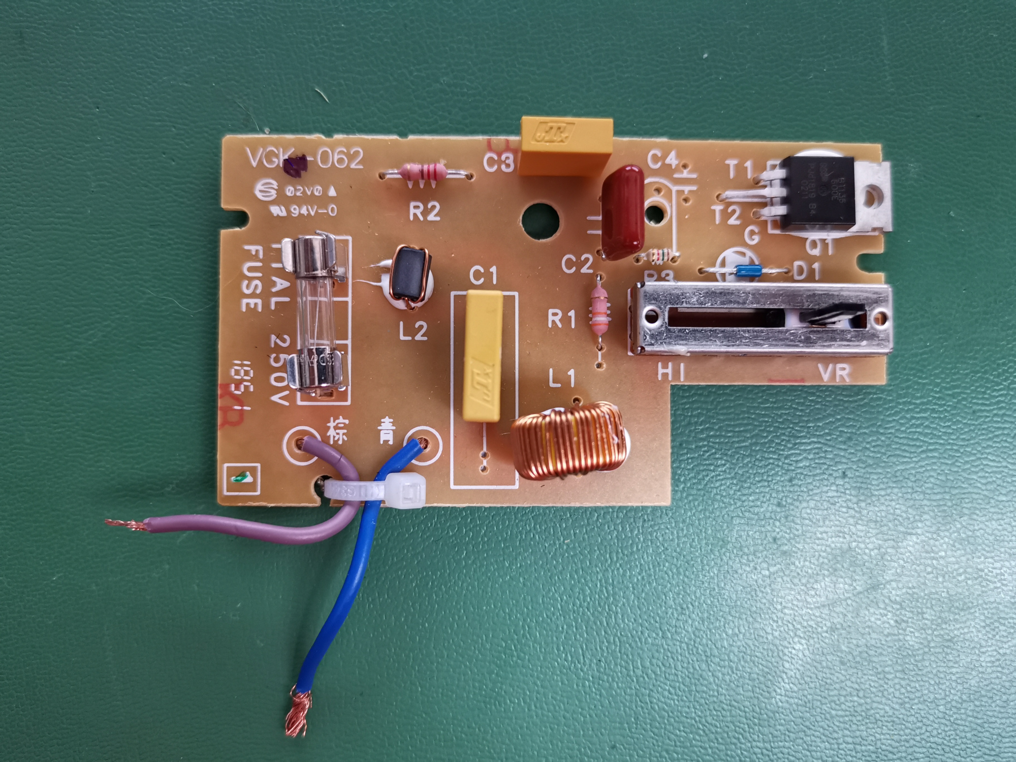

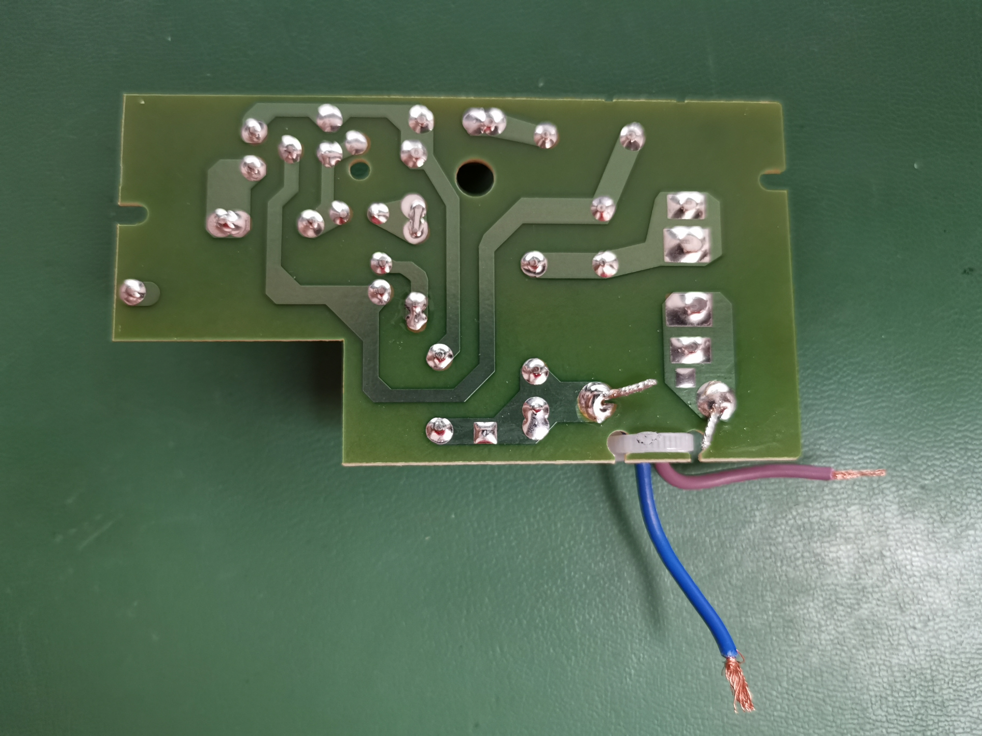

After that, I opened the foot pedal to know how the speed was controlled and here it is :
I'm a software developper and this circuit is far beyond my electronics knowledge so I googled the ref of the top right corner component (BT136) and I've found some topics about TRIAC dimmers and, correct me if I'm wrong, this is what this circuit is, right ?

Appears to be a simple Triac controller, you could convert for Arduino use using an opto, check out Fairchild AN-3006 and AN-3003 and also Picmicro has a processor controlled Triac circuits on their site.

I see your point, but the OP has already identified a triac (BT136) on the existing pedal motor control, so I would assume that speed control of that motor can be accomplished with a triac.
The module he has also has a triac and zero-crossing capabilities. That is not to say that it will work or that it will work as well as the pedal has worked.

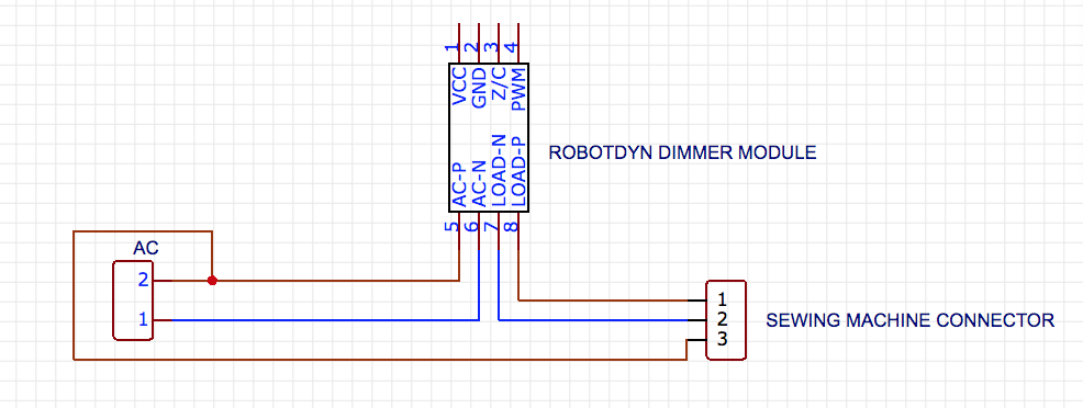

Thank you, so if I understand well, this is how I need to wire the module :

It rather depends if the original controlled in the live or neutral, I suspect from the connection it might be in the neutral? - which was why I suggested feeding the motor directly, rather than via the three pin connector.

Thank you but I can't feed the motor directly, I need to find a way to control the motor without modifying the machine just by replacing the actual foot pedal control. I thought that if it was possible to control the speed of the motor with the foot pedal, it would be possible to control it with a micro controller too...

If the diagram in the original post is correct then the switching is in the brown line. Is this correct? Is brown live in your country?

I created the diagram in the original post by checking which wires were connected with an Ohm-meter so I think it's correct. In France, brown is phase and blue is neutral.
This is exactly why I asked for help, I don't understand why there is only 2 wires going to the foot pedal and not 2 coming from AC and 2 going to the motor...
There are two going to the motor, but one of them is joined to one of the incoming mains wires, allowing them to use a three pin connector instead of a four pin one. The problem is we don't which wires are joined together.
Alright, the blue wires are joined together as shown in the schematic in my original post. (Or at least, that's what I determined because the resistance between these 2 wires is null)
Think of the foot pedal as a switch. It is and it isn't.
A light in a house might be wired with power to the fixture. Then, white and black are wired to the switch. The white wire should be re-coded black with tape.
We have trouble when trying to connect automation devices because there is no neutral in the switch box.
The triac or back to back SCR is the basic power controlling element. They need a minimum load on the order of say 50 mA. They can "appear" broken because of the lack of a minimum load.
They "shut off" when the gate current is removed AND either the load drops below the miniimum load (call it zero current) or zero voltage (actually a few volts).
