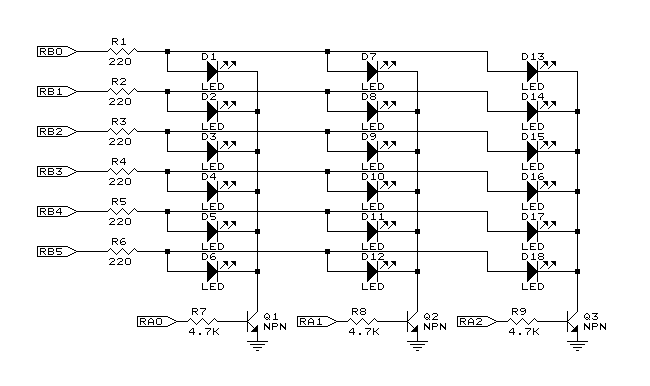

How would you control a row of LEDs using one output pin? I've seen this done (and have even bought/built the Velleman kit **broken link removed** (KIT: MK124)) which is controlled by ONE PIC.
I want to make a 6x3 matric of LEDs (for the newer version of my binary clock) controlled by one PIC.
The LED matrix will look like:
[] = LED
Each set of six LEDs will be controlled by one pin. Is this possible? I'm sure it is!
Here is how I'd do it. I'd multiplex a row of LEDs a time. The eye is not fast enough to see the LEDs alternately being turned ON. Using ultra bright LEDs and with a lower LED current, you might get away not using transistors.

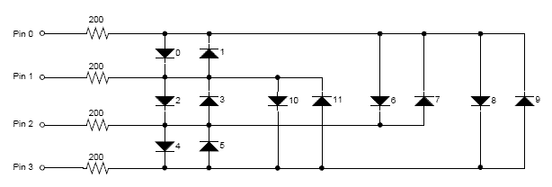

Why not to use Charlieplexing. For example you can controll 12 LEDs from just 4 I/Os...

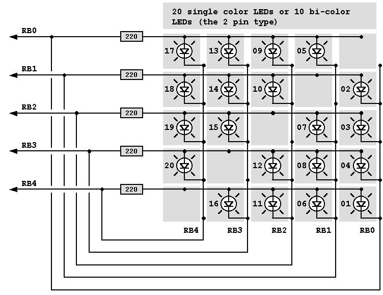

Presumably what you're asking is how the Velleman kit actually works?, motion answered that early in the thread!, the LED's are multiplexed across a number of I/O pins. As it's a 6x5 matrix, it requires 11 I/O pins to drive it.
If you check my seven segment LED tutorial, I use exactly the same technique to feed two seven segment displays off only 8 I/O pins.
As the Velleman kit drives the LED's directly from the PIC, it severely limits the available brightness - a matrix of 6x5 LED's restricts the maximum average LED current to only 5mA - with a maximum of 30mA per I/O pin.
Charlieplexing is a viable option but it'll require 5 pins -- this is sometimes referred to as the N*(N-1) scheme where 4-pins will yield 12 distinct circuits, 5-pins will yield 20, 6-pins will yield 30, etc.... Charlieplexing takes advantage of the tri-state or input-state of an I/O pin, when the pin will neither sink nor source current...
The "5-Pin 20-LED" example circuit below is the same circuit Jay described but drawn a little differently (and for 5 pins)
The "7-Segment" circuit shows 8-pins driving four 7-segment LEDs but if you look closely at the little inset drawing you'll see this circuit will actually support eight (8) 7-segment displays with 8-pins...
Search the "Digital I/O" section of Forum.Microchip for "Charlieplexing" discussions and sample interrupt code for driving the LEDs...
Regards, Mike

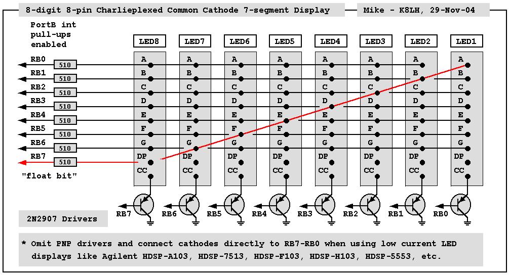

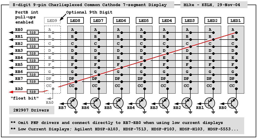

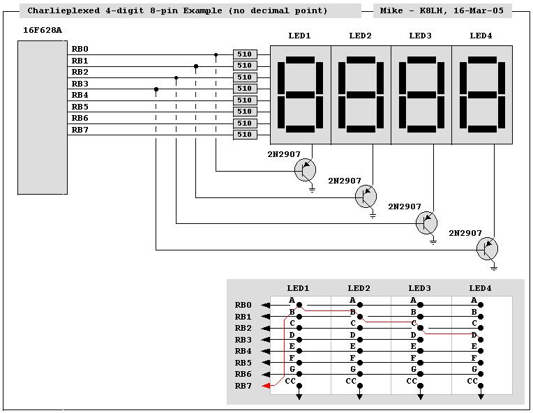

More Charlieplexing examples for 7-Segment displays, for those who may be interested...
These drawings are quite different but will hopefully be a little easier for analyzing actual circuit paths and for visualizing the "float bit" concept required for Charlieplexing...
Have fun... Regards, Mike
Ok... well i've decided to simply show 12 LEDs for now (hours and minutes in binary). It'll look like the following:
Hours> [][] [][] <Minutes
 +-Hours-+  +-Min's-+
 |[]11[]8|  |[]5 []2|
 |[]10[]7|  |[]4 []1|
 |[]9 []6|  |[]3 []0|
[]=LED
However, I read through the Charlieplexing pdf file, and it seems to state that only one LED may be on at a time? I may need more than one LED on at a time :shock: :?: :?:
For example, the time 23:55 in binary must look like:
010111 : 110111
Where the 1's are LEDs that are ON, and the 0's are LEDs that are off (obviously).
Any "bright", pardon the pun, ideas?
To the software only one LED is ON at a time but to the person viewing the clock, any number of the LEDs will appear to be ON. As I said, the eye is not fast enough to tell the difference. Not only will this limit the brightness the LED can shine but the software has to be more sophisticated.
This is specially so if you have to add the timing software for the clock. The delay routines you are using just can't cut it. You may have to rely on TMR0 the get the right amount of delay regardless of how complicated the display part of your program becomes.
