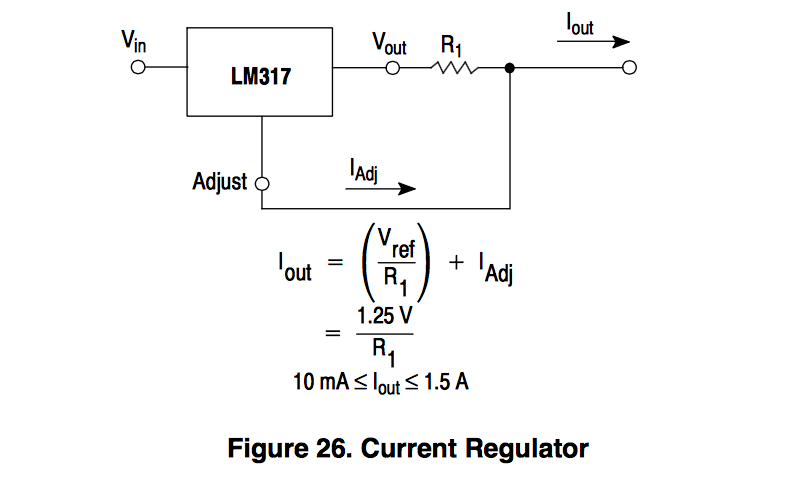

Hi all. The subject says it all. How do I use a linear regulator as a constant current source.
Thanks very much.
Not knowing your requirements, or compliance needed, or accuracy or....
we have a simple example -
Regards, Dana.
Would help greatly to know your requirements so we can give a better answer.
That LM317 circuit has a voltage drop of about 3V when operating near the limit of the current-limit setting.
Is that okay for your application?

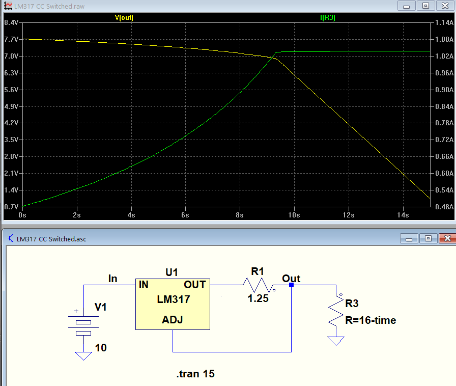

For your possible interest, below is the LTspice simulation of the LM317 circuit set for a 1A limit, with the output lead resistance decreasing with time until the limit is reached.
