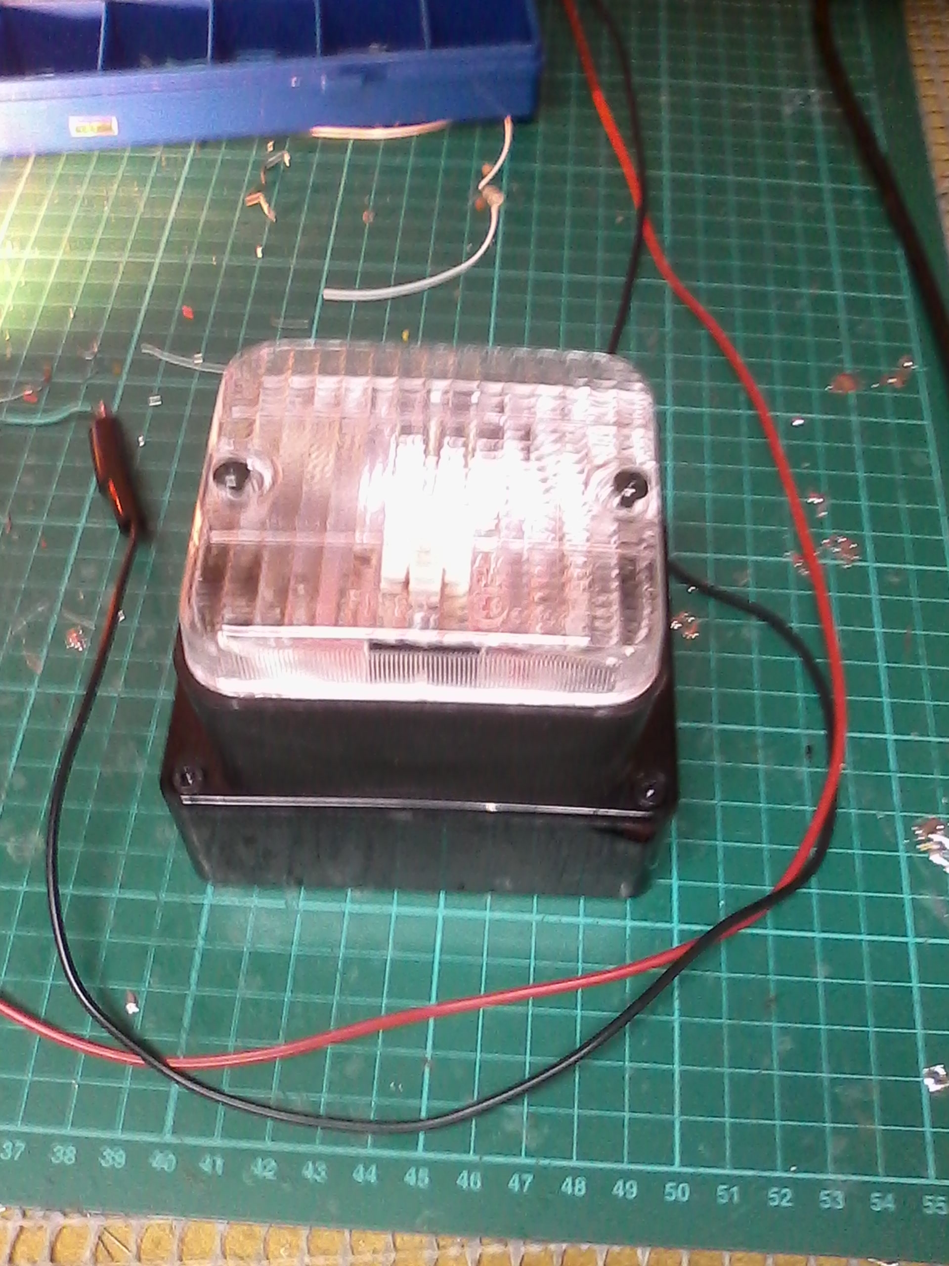

I made a couple of these for my and my wifes push irons, but I'm afraid they are a lot simpler than your thinking.
While riding the dyanamo powers a 10w red led, but its not driven at 10w, its just nice and bright, and when stopped 2 ultra bright red leds flash for a minute or so.

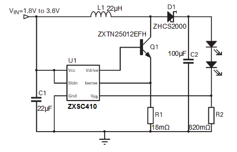

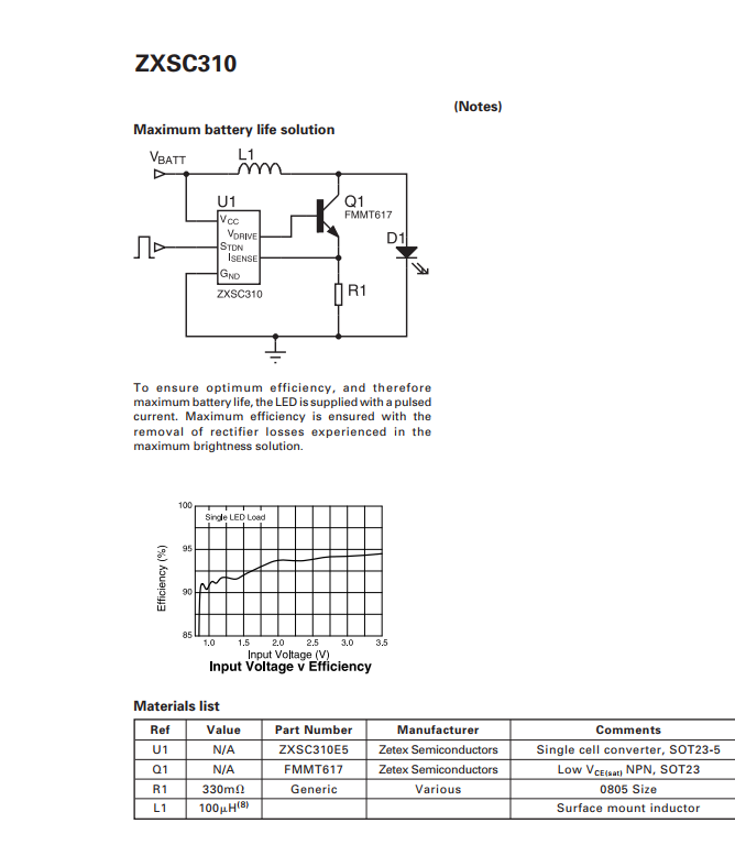

ACharnley,
The IC (TPS61220) regulates voltage. You should use a "LED" driver that regulates current.
Here is a boost LED driver that measures current not voltage.
This is a very old part that we have used millions of. There are better newer parts.
Because it is boost only, the input voltage should not get higher then the LED turn on voltage. So if you added a third LED then the input voltage can go up another 2 volts.
Looks better ... if I can get one working down to 0.7v. I am assuming of course that the supercapacitor will be able to supply enough current at ~1v.

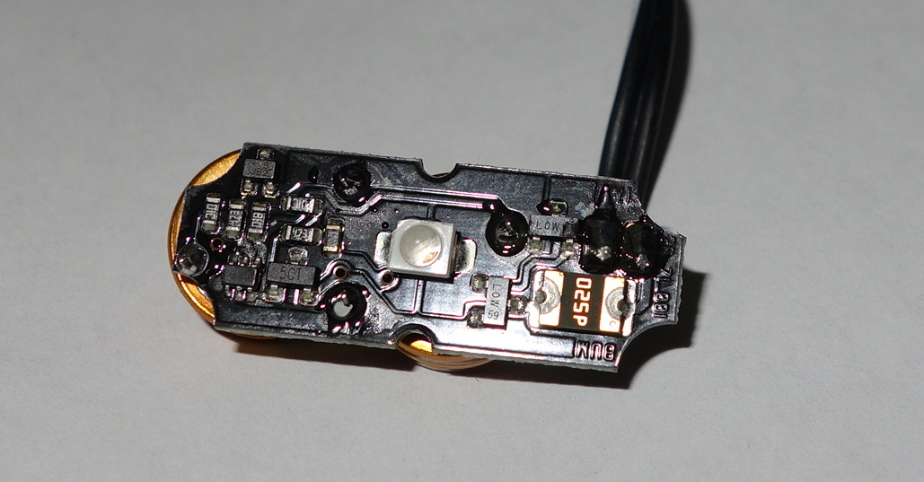

I took apart the Germany device from above to see how they went about it. It's a single LED and as soon as the power goes off (rider stops) the light dims significantly. It is then retained for a couple minutes by 4 x 0.47uF 5.5v caps.
The PCB is double sided and way more complex than I expected with further IC's on the rear. Can anyone identify the 0256p component? It's unusual, not seen one before.
