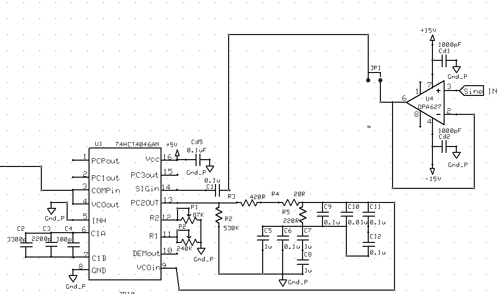

You may be totally true, I was just thinking about the noise in the sine wave itself that might give rise to the 1us jitter even on the TTL from the AGC circuit of the source driver. Now the question is about an efficient schematic using a 4046 with sine wave or can I still use the TTL from the AGC and get it tuned even better to reduce the jitter? I am currently using the TTL with a 4046 on the schematic that I had above and it still has jitter in it. I am wondering if I can ever get the PLL output to be stable/close to the input sine wave (which is what I am looking for).

.............................. Now the question is about an efficient schematic using a 4046 with sine wave or can I still use the TTL from the AGC and get it tuned even better to reduce the jitter? I am currently using the TTL with a 4046 on the schematic that I had above and it still has jitter in it. I am wondering if I can ever get the PLL output to be stable/close to the input sine wave (which is what I am looking for).

I uploaded my design rather than my schematic, its in Post#15. Actually I have 2 versions of my PLL design. Will upload other one soon.
thanks
Here is my alternate PLL schematic which has tuning control of center frequency and this works with a sine wave input where as my other design is a fixed one and works only with TTL input.

I'm puzzled as to why you have all those caps in parallel/series? Isn't that likely to make the circuit less stable?
