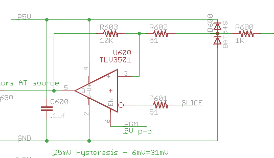

The comparator you like can work to -0.2V on the inputs. (I think)
Here is a circuit I am using on a product.
Input on right side.
R600 limits the current if the input is too large. In your case you might want to change to 2200 or more.
D600 protects the IC.
R602, R603 adds Hysteresis. My IC has some and I wanted more.
The (-) input set the "slice point" which you want to be 0 volts.
I don't have time to think whats wrong with this circuit right now.
I am using this where "slice" is 0.5 to 2.5 volts. Some voltage comparators will work to -0.4 volts on the inputs so having "slice" at 0V should be fine. (look for common mode input voltage range)
If the input is above 0V the output will be at 5V. If the input is below 0v the output will be 0V.
I tried what you suggested and its working only when I use 3V as V+ for TLV & btw, the shutdown pin should be connected to GND rather than 5V for it to be active. The jitter in the output is not any better than the TTL output that comes out of my source sine wave driver. I am trying to get the jitter as low as possible. Maybe I should just keep using a PLL in my circuit and maybe better it.

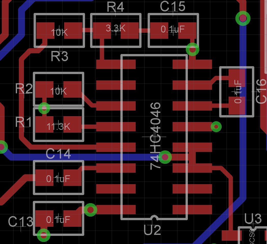

Probably it might be better for another thread, but while we are here, currently I am using the TTL coming out of my driver as input and the output as reference to a 4046 IC and the results are not as better as I expect it to be. This time I would like to try using TTL signal as input and the sine wave as the reference to a 4046. Could that be done?
Here is the circuit that I am currently using, the input TTL is via C14 and the output is across Pin11&12.
Any suggestions to modify the same circuit to use TTL as input and Sine as reference?
I am following this guide (among others)
