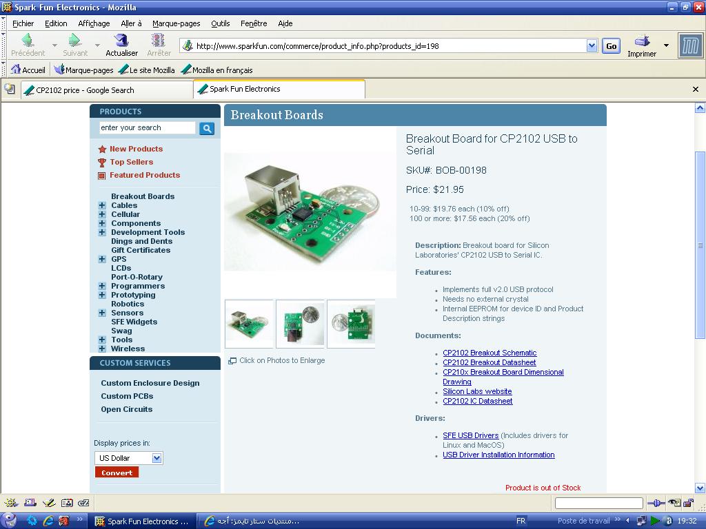

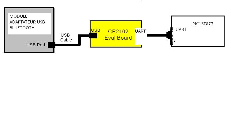

hello, as you see it in the title, I like to connect an adapter usb bluetooth with a pic16f877 via port UART (important flow) I used an adapter usb uart CP2102: bluetooth - >cp2102-->pic16f877 my question is as follows: since we connect a module bluetooth to the PC we need a driver, is it the same thing for my project? and what I must make because I did not know anything about micro controllers PIC and thank you for your assistance.
You can't use a bluetooth USB dongle on anything less than a computer with a USB host (ie PC or Mac). A USB host is somehat more complex than the client.
Like justdiy pointed out you need a bluetooth adapter with an rs232 interface which are generally more expensive than their USB counterpart.
Some rs232 bluetooth adapters have TTL signal level options, that's what you want.

i do not know of any way to have a microcontroller preform the role of a USB host (the role the PC plays) is that what you are asking?
