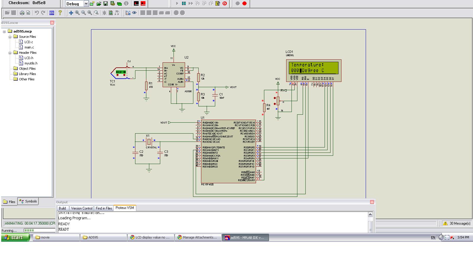

im newbie in programming.....
im using hi tech compiler, pic18f4520 and 16 x 2 lcd.....
after simulation is ok....but in real device, my lcd is blank .....
i dunno how to configure my code.....can anyone here helps me to solve it??
here is my code:

Post your LCD.h file
my LCD.H file as shown

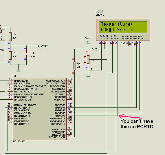

haowhaow the way the LCD module works with Hi-tech you can't use E on PORTD.
It writes the lcd data as one byte to PORTD and then shifts it for 4 bit mode

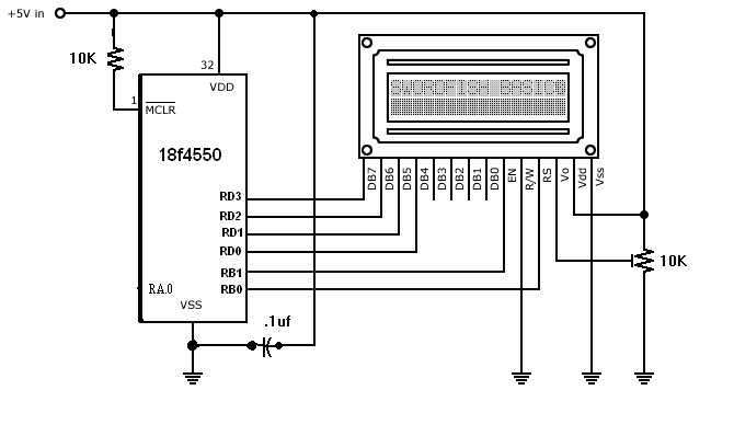

in the lcd.h file
#define LCD_DATA LATD
#define LCD_DATA_PORT PORTD
what it mean??
how to connect lcd data with port D?
lcd_d0 with LATD0??
lcd_d1 with LATD1??
lcd_d2 with LATD2?? and so on???
No you have data on PORTD 0 to 3 and E, RS, RW on say PORTB
