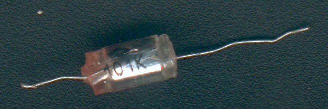

I need some help, I'm trying to fix a circuit and I've come across a component I can't identify. It is cylindrical in shape and the only markings on it are a diamond, and 101k. Please see attached.

This is a 100pF condenser. Dielektricum:stiroflex, small lost, also good in HF oscillator use.
