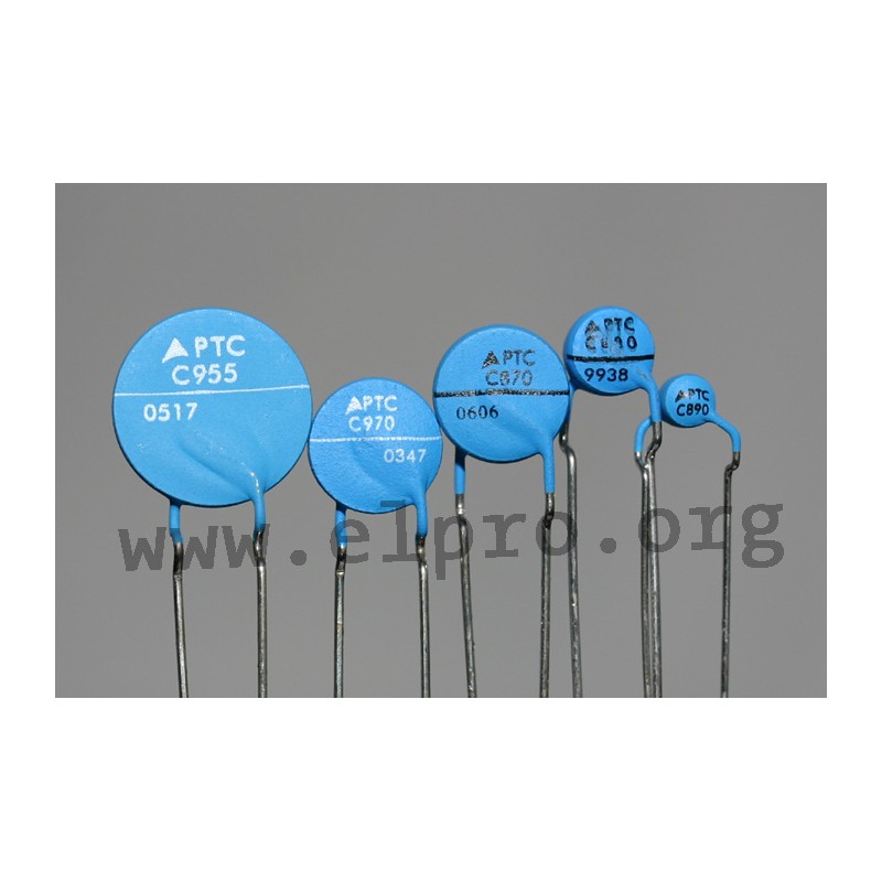

I need help identifying a component so I can source a replacement to fix an audio crossover.
I have a set of JAMO Cornet 175 speakers and they sound Beautiful that was until transport damaged the internal crossover board breaking the component I asking about and a few other bits that I can fix.
I will upload a pic of the component and one of how it is utilised on the board from the unbroken speaker.
Any help is greatly appreciated and I appreciate any feedback, Advise etc

Thank you both for your replies can’t I ask another Question I’ve now found a Replacement TDK C955 Thermistor does the last 4 digits refer to anything ?
Like I can find thermistors that have the C955 numbers on but not with the 0020 and wondered if I get the one Marked C955 would that work?

As per the data sheet it's just a date code, YYWW

Read #3 again. I would have mentioned anything else if it was important.
