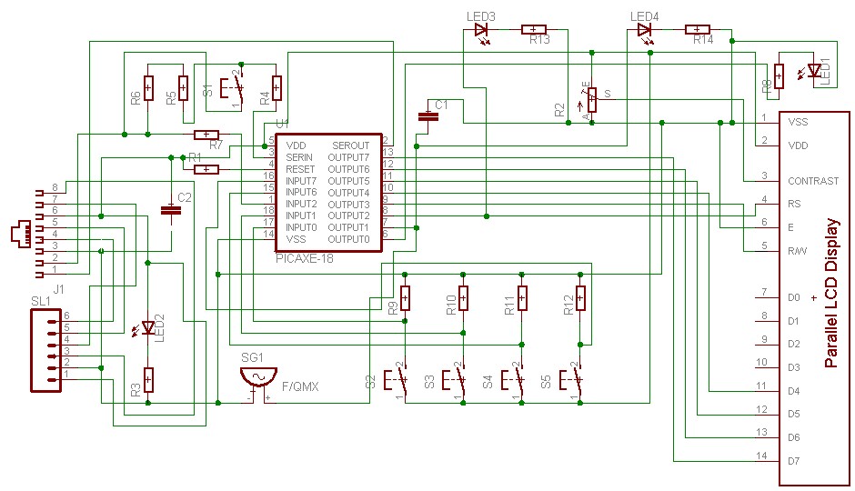

I have a circuit I'd like to get made on to some PCBs and I can't find any low-cost places I can get it made up properly in the UK, so I'm going to have to try and etch it myself using either a steady hand or some sort of press-n-peel.
The schematic is attached and as you can see its quite compled. The main bits are the PICAXE and the LCD. Also a 6 way header and an ethernet socket.
Anyone here think that it's possible to get that done on two single side copper boards, 65x65mm max? If so what do you suggest for layout the best? I will use ribbon cable to connect the two boards. The top one needs to have 16 pins at 2.54mm spacing along the bottom-left edge somewhere for the LCD (14 pins + 2 for the backlight - shown by LED1 on the diagram).
Any tips are welcomed. Many autorouter tools fail to manage to route it!

One thing I've learned is that the autorouter tool is just that... a TOOL. I've never been able to use autorouter alone, except for very simple boards. Usually I can get the autorouter to pull off about 80-90% of the connections, and I use that as a starting point... adding and removing traces as I see fit. (autorouting usually ends up with a few totally stupid traces, such as running all the way around the edge of the board to reach a pin 1/4 inch away, instead of just using a jumper)
I think the biggest reason autorouter isn't a perfect solution is that it depends heavily on where you place the parts. unless you can find a package that does placement AND routing automatically, then you have to experiment.
it looks like you're using eagle. if you send me your SCH file maybe I can work something out with it... honestly it doesn't look that complicated... take a look at: https://eegeek.net/electronics/projects/function_generator
bear in mind that a lot of the connections in that diagram are done by labeling the nets, rather than running the wires, to make the diagram less cluttered... such as the 12 wires going from the lower part of the PIC to the chip shown on the right. Autorouter certainly couldn't handle the layout on its own, but as you can see I made a single-sided board for it. I think I had to use about 6 jumpers in the design. When it comes right down to it, there are often times that you could probably reduce the number of jumpers but it might take a half hour to eliminate a single one, whereas it only takes about 1 minute to solder in a jumper, at the most.
Here's the Eagle SCH file.
If you can work out a solution that'd be great. Ideally it needs to be something like 1 or 2 65x65mm max size boards. I can connect them together with some 10core ribbon cable I have. The LCD needs to go on the top board as well as the LEDs. The switches at the bottom will be on short wires so just need pins.

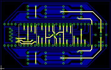

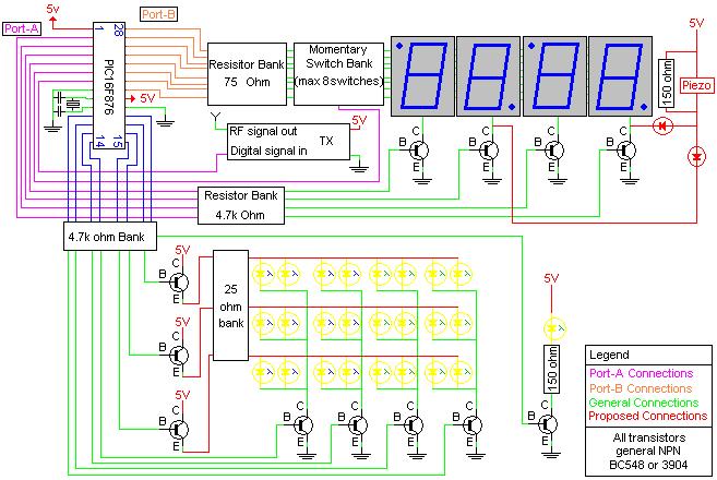

you think thats complicated!!!
try fitting this circuit into a 70mm x 50mm x 30mm (UB5) box.
it requires a second board behind it using 12mil tracks in some parts!!
Computer Wrote: Any tips are welcomed. Many autorouter tools fail to manage to route it!
I don't think that board would be all that difficult to do, and I wouldn't use an auto router.
Quite sure I could draft it and make it, But I wouldn't attempt it without having the parts to varify the Physical layout, pin spacings and sizes.
Also not sure if those are surface mount or through hole types of parts.
Gary

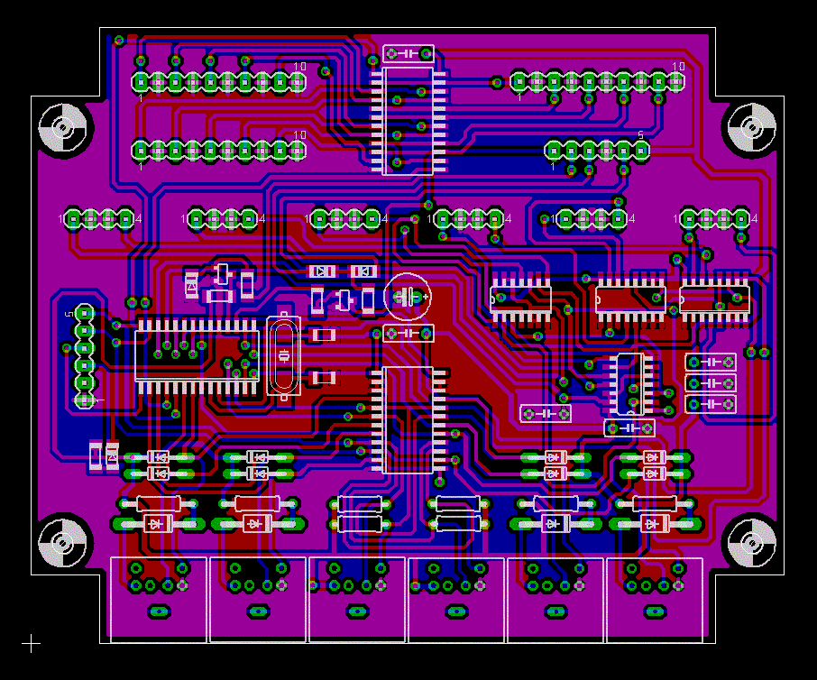

I make boards like this all by myself ! with simple stuff, a UV light, 2 cheap chemicals and a little water ...

I also draw them by hand 'cause the autorouter isn't that good at routing.
This requires a lot of patience an retries, but i always seem to get it done (the board above took me 11 hours to route :lol: )...
Also remember your limitations, for example i can't do plated holes. So for parts wich u cant solder on the top side of the board (ic sockets, connectors,...) try to route as much signals at the bottom and if you do require them at the top, start at the bottom towards a open space , then a via to the topside and so on...
Dont forget to draw a frame around your design with the exact size as the board it needs to get transferred to (10x16cm for example) this is used to get the top and bottom side aligned.
Then i print it using a laserprinter, its 1200*1200 dpi wich allows me to use traces 0.08" thick with 0.10" spacing. (thinner gets printed well but doesnt work, i guess the uv light creeps under it ruiing the trace)
Then tranfer it to a photosensitive pcb with a UV light. 2.5 minutes of exposure is what i always use.
Use the frame you drew to align the upside and downside. U may need to try a couple of times, but once u get the hang of it it works great. The board in my previous post succeeded first try.

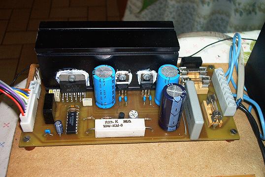

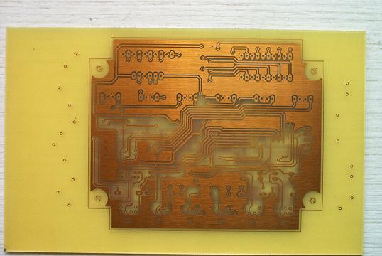

pictures of the board i posted above when etched, sorry i can't show a finished board with parts on it cause it's already been sold, this is a second spare board i made. Of course u can do single sided pcb's to, in wich case it's even a lot easyer (3rd pic).
