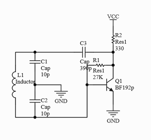

I have to make a Colpitts oscillator working on 1.1 GHz, and another Colpitts oscillator on 1.5-2 GHz.
Here is the circuit:
https://imgur.com/a/4irBu
The frequency is about 880 MHz, and i've already tried a lot of different values for L1, C1,C2 but i can't increase the frequency to 1.1 GHz. My professor said that there is no problem with the circuit, so let's try again and again, but i've no more ideas. I've already calculate(Thomson formula) that if C1=C2=1 pF and L1=5 nH, the circuit has to work on 3,1 GHz(??).
So, what do you think? What is wrong, what should i do?

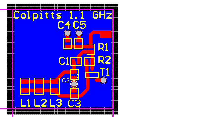

Considering the Low Capacitor Values, You also need to Consider Circuit Layout.
Poor Layout May be Adding a Lot of Capacitance.
I can not find a BF192p transistor data sheet. Can't find where to get the part. Is this the transistor you are using.
Can you attach a picture of your circuit. (taken with your phone/camera)
Good picture, thanks.

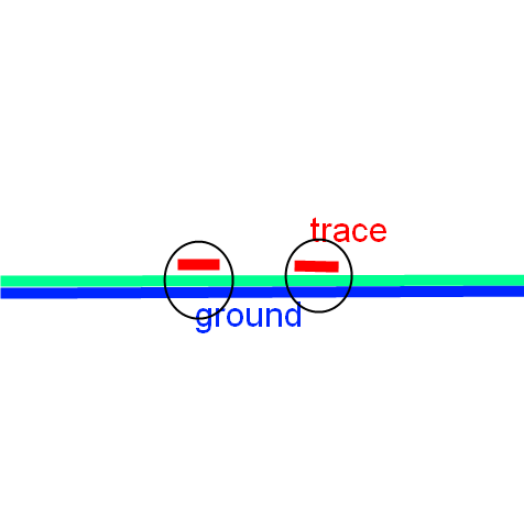

Every red trace makes a capacitor to ground. Every inch (cm) of trace makes a inductor.
Look at the red traces going to L1,2,3. They have capacitance to ground.
Populate L3 and remove the traces going to L2,1. This will increase your frequency a little.

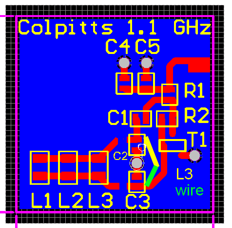

Sorry, the transistor is BFR92P, C1=C2=1 pF. I can buy just 15 nH inductor, so i had to use 3 parallel to reach the 5 nH. But i can't understand, how design it to 1,1 GHz. I calculated this formula: f=1/(2pi*sqrt(LC)), C= C1XC2, and it is 3 GHz, if i use 1 pF and 5 nH. But i built the circuit, and it's 800 MHz now, and i can't decrease the capaticance to increase the frequency
Putting 3 Inductors, Close Together in Parallel will Not give a Correct Inductance.
Close Together will cause them to Act Against Each other, Adding More Inductance than calculated.
Your printed circuit board is making capacitors.
A capacitor is two plates of copper with a insulator in between.
You have xpF of capacitance from inductor to ground.
I made a black circle around the two capacitors in the picture below. You do not know about these capacitors.

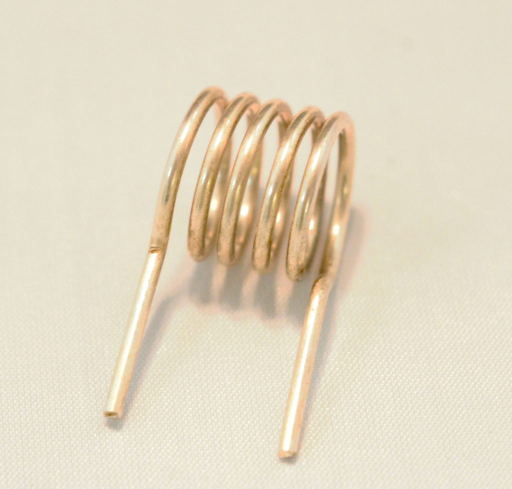

I make inductors by using wire and winging around a pencil. Then remove pencil. Maybe 3 turns.
I have a good meter that will measure 5nH. Spread the wires to decrease the value. Push together to increase the value.
