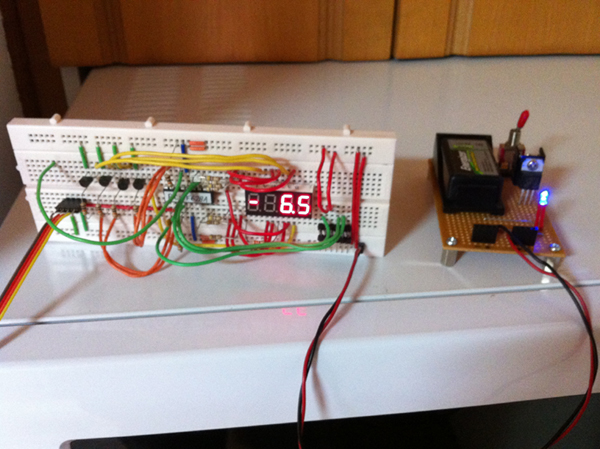

Hi everyone.
I have finally just got the code working on my DS18B20 Digital Fahrenheit Thermometer after disussion with a few very knowlegdeable people in another thread.
Here it is below after a couple of minutes in the freezer with the themostat turned all the way down :p
-6.5F = -21.4C
fahrenheit-jpg.54538
There ASM file has too many characters for a post so here it is here:
http://www.jakeselectronics.net/fil...orbasic/digitaltemperaturesensorbasicFasm.php
What I have done is take my old Celsius program and add the C to F Conversion in.
What I am looking for/asking/wanting to discuss, is code optimisation or better ways of doing things from line 313 down.

Hi Jake,
Your bin_to_dec_f routine looks like a very nice extension of your original and very novel 8-bit (0..255) routine from long ago. I'd just like to mention that, like your original routine, you could take advantage of the -10 value in WREG to subtract ten instead of one during each loop, which would improve execution time quite dramatically.
;  Jake's modified 13+ bit 0000..9999 bin-to-dec algorithm
;   input: binh:binl -> 0x0000..0x270F (0..9999)
;  output: thou -> 0..9
;          huns -> 0..9
;          tens -> 0..9
;          ones -> 0..9
;  19 words, 4 or 5 variables, 14..8330 cycles  (Mike, K8LH)

Mike, Im interested to study the modified routine because I dont quite understand your worded description. I just started a new job, so Ill take an in depth look on the weekend.
I wanted to leave the other thread, becasue I've gone from 'how the hell do i make this work' to, 'how can i do this better'...
Anyway in the other thread you stated:
While this modified version of your routine is much faster, it's still pretty slow compared to some of the alternatives. If that becomes an issue, please let us know.
Its not an issue for this project, but im allways interested in being able to do things better.. Please expand on the/your alternatives.
