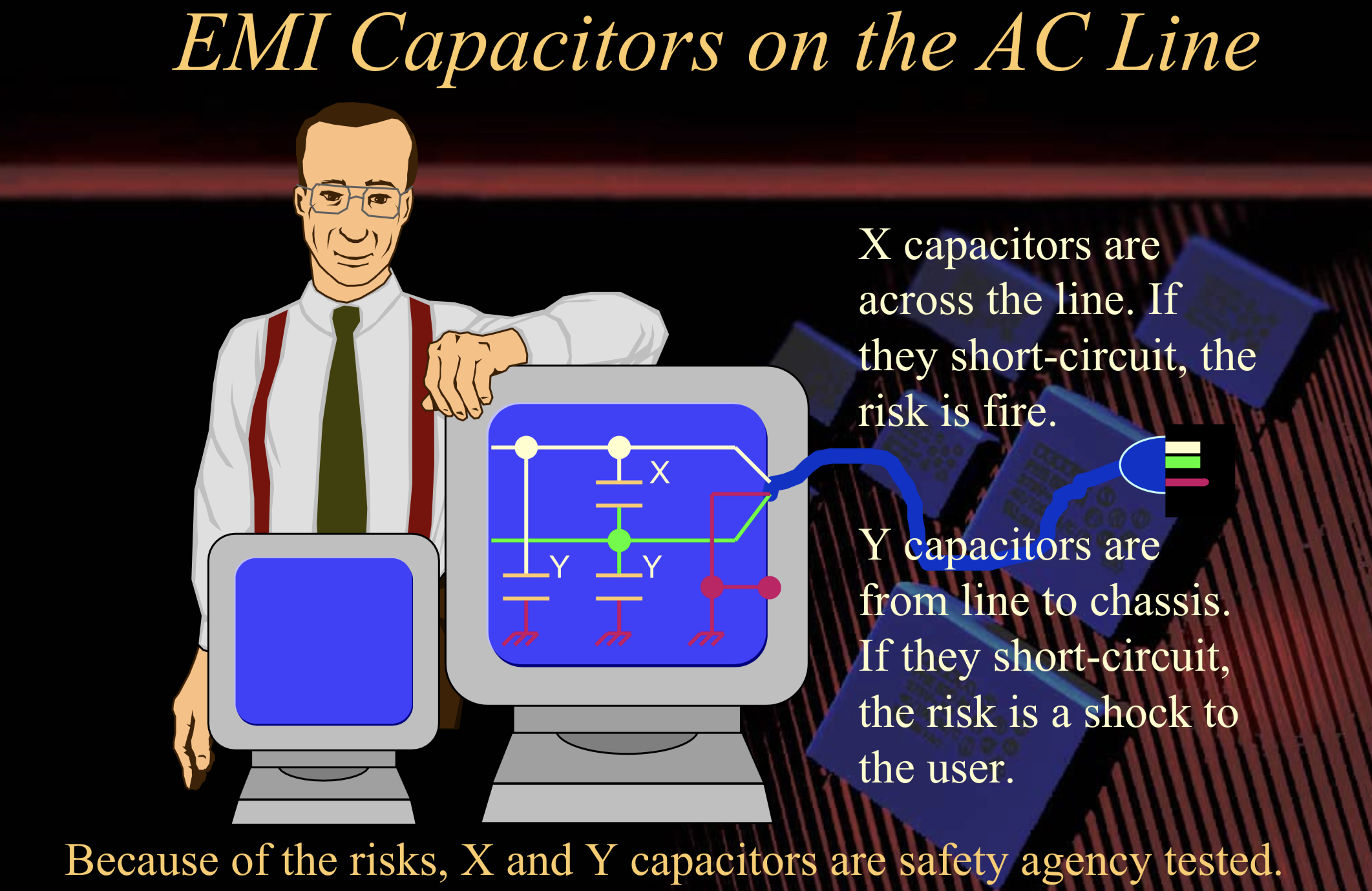

As far as I know, class Y caps must not fail short, so that they don´t endanger human lives. Class X must not fail in such way that they cause a fire. This does not mean they have to fail shorted.
Yes I think your correct kubeek.
So if one fails short and the other open I dont see how one cap can replace both.
Which one fails short?
let me google that for us.... and the answer is, obviously,...
Neither. The two cap classes are certified for two different purposes, according to KEMET.
