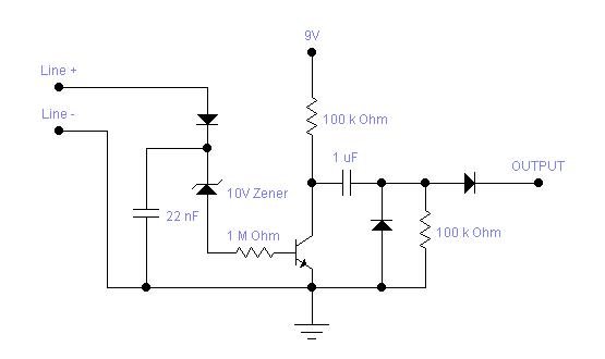

I needed a circuit that would count the number of times a telephone on the line was picked up. I built the circuit below and fed it into a ripple counter with some logic for the output alphanumeric displays. But whenever i lift up the handset nothing happens!
Whenever a handset is picked up, line voltage is dropped to about 9v. The input to the circuit is from a diode bridge attached to the line. The 22n smoothes out any ring voltage (90V RMS). Have i missed something obvious?? is there a better way to do this??
Thanks in advance
Thanks in advance

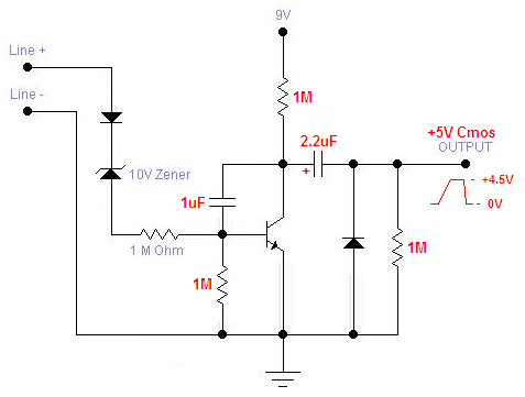

Hi Megamox,
EEK! A fuzzy Jpeg.
Your circuit had nothing to turn off the transistor. The 22nF would remain charged at the threshold of the transistor conducting slightly.
The 22nF wouldn't be a filter for 90V ringing anyway, it would just charge to the peak voltage.
I added a capacitor from the base to collector to try stopping the 20Hz ringing voltage from activating the transistor. It is very difficult to stop a frequency with only a single-pole filter. It results in very slow edges of the output pulse, requiring a Schmitt-trigger input to the clocked counter.

ahh i never thought of using a capacitor in the feedback like that, ill try that thanks!
Well i was using the 22n to actually hold the supply from going below the 10V threshold because thats what triggers the transistor into turning off and sending a pulse. I figured if the handset was picked up after a ring, the top end of the diode would be about 9v or thereabouts, and the 22n being fully charged would try to hold the rail but would discharge pretty quickly meaning the transistor would turn off and the collector would jump up to 9v clocking the rest of the circuit.
I could use 2 CMOS not gates on the end for the schmitt triggers right?

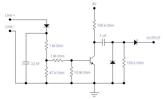

Yeah, you have a good idea to rectify the 90V ringing to keep the transistor turned on.
All you need is a resistor to turn off the transistor and your circuit is fine.
The output diode isn't needed because the very low current going to -0.6V won't hurt Cmos.

Im always forgetting the pull down resistors, somewhere in my head absence of voltage = ground - duh. Thanks.
The circuit simulates fine too, i guess ill have to pick apart the connections and see whats up with it.
Thanks for the help guys :D

I think i know why the circuit isnt working. From my measurements i noticed that if the input voltage was about 7v, the end of the zener was about 1v when it should have turned off the base of the transistor. Looking at the characteristic of the zener diode it shows that its reverse bias voltage is only maintained when a minimum current is flowing through it. So as the input voltage lowered, the end of the zener connected to the base would fall and turn off the transistor, this would gradually stop current through the zener, and its characteristic shows at less and less current its reverse voltage decreases. So this would mean the end of the zener voltage would start to rise and it would turn the transistor on again so that current would again flow, which would make the zener voltage again try to fall to maintain its zener value and try to turn off the transistor again etc etc. I had to take the input voltage down to about 5v to actually turn off the zener!!
This is the only way i can think to explain the measurements. Or am i completely wrong.
Sounds OK to me, zeners aren't a good choice for doing that. Bear in mind you're looking for a HUGE voltage drop, not just a volt or two. A simple potential divider would be enough to sense it.
As I recall, it's quite common to use an opto-coupler to sense the phone being off hook?.
Just made an adjustment and added the divider. I dont see any problems with it, simulates okay too.

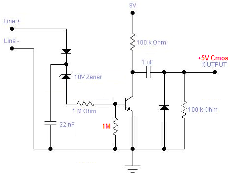

Tested the circuit above, works fine :D
The 22n stops ringing from being counted, so whenever any handset is lifted the counter clocks up the count.
But am using an LDR now, just looks a little messy with wires from each phone trailing along the floor to the counter, oh well!
