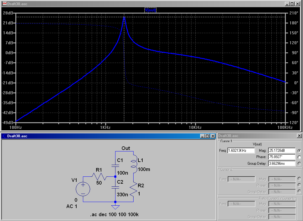

LTSpice, downloadable from linear.com. I use it extensively on this forum to explain how circuits work. For example:

Its a pretty good simulator of passive circuits, too.
