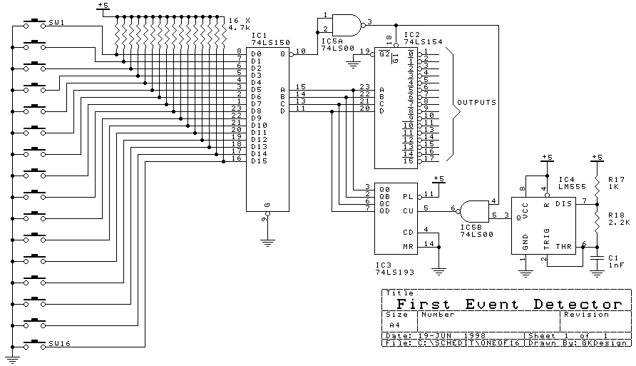

hi everyone,
i have made first circuit of my life,i was very excited while making it.but really depressed after i saw that it deostn,it works the way it should.
this is the link to the circuit
wat this circuit is doing
its simply tells which out of the 16 switches is pressed first. .
i have connected LED's on the putput terminal of the IC2 (Dmux)
and neither of the LED lites up when any of the switch is turned on. . .
what i think is that there might b some connection which is missing in the circuit might b the connection from ic4 to ic3. . or do i have to connect +5 volt to IC1 on its 24th pin
2nd question is that can some one suggest me a circuit simulator for
this circuit. . .
pls help
Why don't you attach the schematic "up side up" here, instead of posting it sideways on a different website?
Show how you connected your LEDs.

i connected the +ve terminal of led to the positive of battery and negative terminal to the output pin(any of the 16) of IC2. .the led lites up only wen connected with the pin 12 of ic2. .
I have never seen a 5.0V battery. What is its voltage?
The max allowed output current of a 74LS154 is only 8mA. An LED without a series current-limiting resistor is like a dead short and probably the outputs and the LEDs are blown up.
I cropped your huge schematic and attached it here.

Wait a minute.
You connected the negative of an unknown battery to the output???
You never connect a voltage to an output.
The positive of a 5.0V power supply connects to the positive terminal of the circuit and its negative connects to the circuit's ground.
The circuit diagram you have linked to doesn't show the power supply connections (except for the 555 timer). The supply connections are assumed and so to answer your question yes, you need to connect VCC to pin 24 of IC1. You will also need to connect ground to pin 12. The same goes for the other ICs - look up the datasheets to find out what pins the power supply is supposed to connect to!!!
With regard to operation of the circuit, if you're going to connect LEDs to the outputs then you'll need a current limiting resistor. Also, be aware that the 74154 has inverted outputs. In other words, they output high normally. Personally I would suggest you use transistors to buffer the outputs of the IC.
I've had a look at the circuit and I can see how it's supposed to work. Basically the tripple-5 is going to clock the counter continuously and the mux will select each of the button's in turn. It does this very quickly so that as soon as you press a button the output of the mux goes high. This is inverted with a NAND gate (setup as a NOT) which presents a low to one side of the NAND gate connected to the tripple 5. This stops the counter counting, and the Demux on the other side shows which button has been pressed.
Only trouble is, as soon as you release the button the counter will start up again won't it? Which means you only see what button was pressed for as long as you hold the button down?
Someone please correct me if I'm wrong - because that seems a bit pointless!!!
Brian
I simulated the circuit in multisim and it ran exactly as I described in my previous post. The only difference between that circuit and my simulated one is that I used a 7493 instead of a 74193 (because the 74193 wouldn't work for some reason)
The circuit works, but it only shows you which button has been pressed for as long as you hold the button. Therefore, it will only show you which event occured first as long as the original event stays valid.

The stupid circuit doesn't have a latch to remember which button was the first one depressed??? Then it is a very stupid circuit.

I am not suggesting you should use a 7493 instead of a 74193 in practice. The only reason I changed to a 7493 was because, for some reason, the 74193 model within multisim didn't want to work. I spent about 40 minutes messing about with it but couldn't get it to count so I substituted it for a 7493 which, when you link both sides of the device together, does the same thing as far as your circuit is concerned.
Please find attached the working circuit. It's a multisim 8 file (zipped up) so you'll need a copy of multisim 8 before you can use it. I substituted push buttons for normal throw switches, and I've named them A-P so when you simulate the circuit you can press a letter on the keyboard from A-P and, after some time (the circuit is MUCH slower in simulation!) the relevant indicator will light up. Press the key again to release the switch and the indicator will go out.
I still don't see what practical use this circuit has - I'd be interested to find out what you intend to use it for?

I need to make a slight correction in what I've implied there. The circuit WILL show you which event occured first as long as the original event stays valid OR other events occur after it. But as soon as all events have cleared, you will lose the information regarding the first event.

actually the project is to provide a switch in each flat of a society and the main led panel at the gatekeeper room. so wenever any switch is turned on the gatekeeper will get to know which flat is calling him.
this circuit will decrease the no. of wires used

i hav made the circuit and its working very nicely now whenever i push any switch the corresponding output of the dmux goes low. . .
now there is one very simple problem left
the output remain low only till i keep pressing the button . .i want to use a latch,which can hold the output till it is manually resetted. . .
can u suggest anyway or an IC for this thing . .
thanks in advance
note:using push button is mandatory

how about connecting a (s-r latch) IC74ls279 at the output.
datasheet:
https://www.electro-tech-online.com/custompdfs/2007/10/74LS279.pdf
we get low signal at the corresponding output pin of the input applied. . so when the pin gets low the output of this IC (SR latch) will be high and remains high till we manually reset the IC. . .
i think this will work
