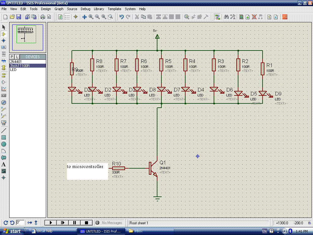

I would drive the 9 LEDs from the collector of a 2N4401 transistor. Each blue LED needs a 100 ohm resistor in series from the +5V supply and the base of the transistor should have a 330 ohm resistor in series from the output pin of the microcontroller.

The emitter of an NPN transistor (use a BC337) connects to ground. Each LED is in series with a current-limiting resistor and connects from the collector to +5V.
The base has a series current-limiting resistor and is turned on when its base resistor goes positive.

You didn't post a schematic showing how you connected the transistor (maybe it is connected backwards) and which base resistor value so I don't know what is wrong.

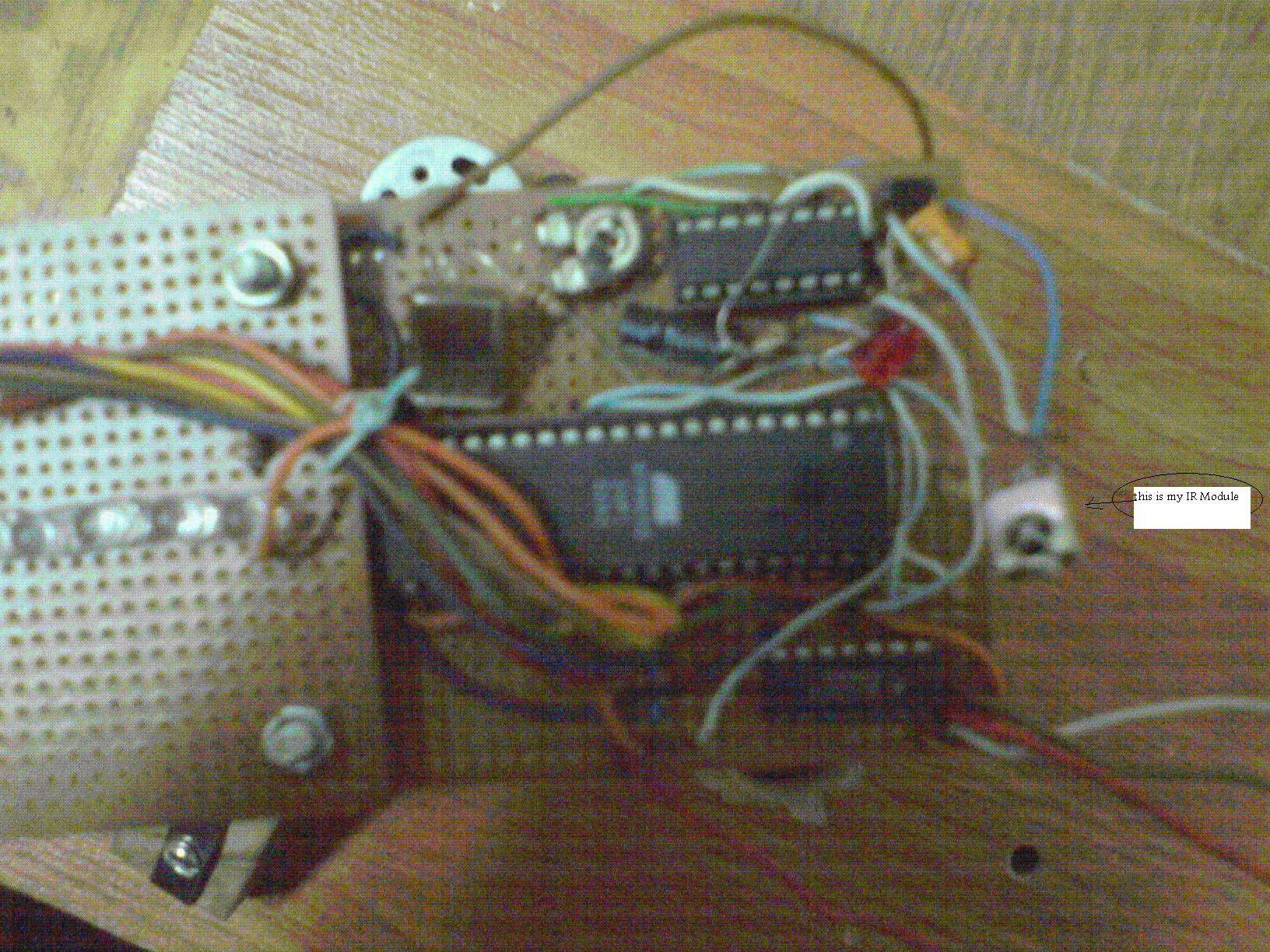

I am attaching the REceiving module and the 9 LEDs circuit which i connected.
and the circuit of whole project and remote is on page 1 of this fourm.

Now your blue LEDs will have a current of about 16mA each and will be bright if they are turned on continuously.
But they are not lighting at all !!!
When the base of the 2N4401 transistor goes to a logic high voltage then the transistor will turn on and light all 9 LEDs.
Maybe the pins of the transistor are connected wrong.
Maybe the pins of the LEDs are connected backwards.
Maybe the input to the base of the transistor does not go to a logic high voltage.

i have checked all things. i have disconnected the base resistor from the base of the transistor and checked the votages at the end of the resistor, the voltage is 0. and while the base of the transistor is not connected to anything, i shorted the base and collector of the transistor then all the 9 LEDs are glowing till base-collector is shorted. mean LEDs are fine and transistor is also fine. But the output from the microcontroller is always low (this seems to me). But when i first time turned the analog mode on, the 9 LEDs were glowing at that time very lightly. But now They are not glowing. please check it? i have uploaded all the things on page 1 of this forum.

If you short the base of the transistor to its collector without a series current-limiting resistor then you risk blowing up the transistor because then its base current will be extremely high.

A transistor can blow up in one instant. You did not limit the base current when you shorted the base to the collector so you are lucky that it still works. Instead you should connect the base resistor to the supply voltage of the microcontroller then the resistor limits the base current.

Maybe you burnt out the output circuit of the microcontroller by overloading it by trying to directly drive the very high current for the LEDs.
Maybe the pins of the transistor are connected backwards. You did not test the transistor correctly so maybe it is also burnt out.

The output from the microcontroller should go to a logic high voltage (+4.5V to +5V if its supply is +5V) to turn on the transistor.

I told you already. Disconnect the 330 ohm base resistor from the microcontroller and connect it to +5V to turn on the transistor which will light up the blue LEDs brightly.
when i am connecting a 330 ohm resistor in series from +5v to the base of the transistor, the 9 LEDs are all glowing. mean the LEDs are working fine and the trasistor is also OK. so result is, the problem is in the program. am i right? or is there anything remaining before i come to the result.?
Hey! i tried by changing the bit for the 9 LEDs and thank God the 9 LEDs are glowing now :) But very light. now tell me how increase their intensity? this time the 9 LEDs are glowing through transistor.
If the output from the microcontroller turns on and off at a frequency that you do not see and with narrow pulses then the LEDs are dimmed. If the pulses are wide or if the output is continuously high then the LEDs will be bright.
