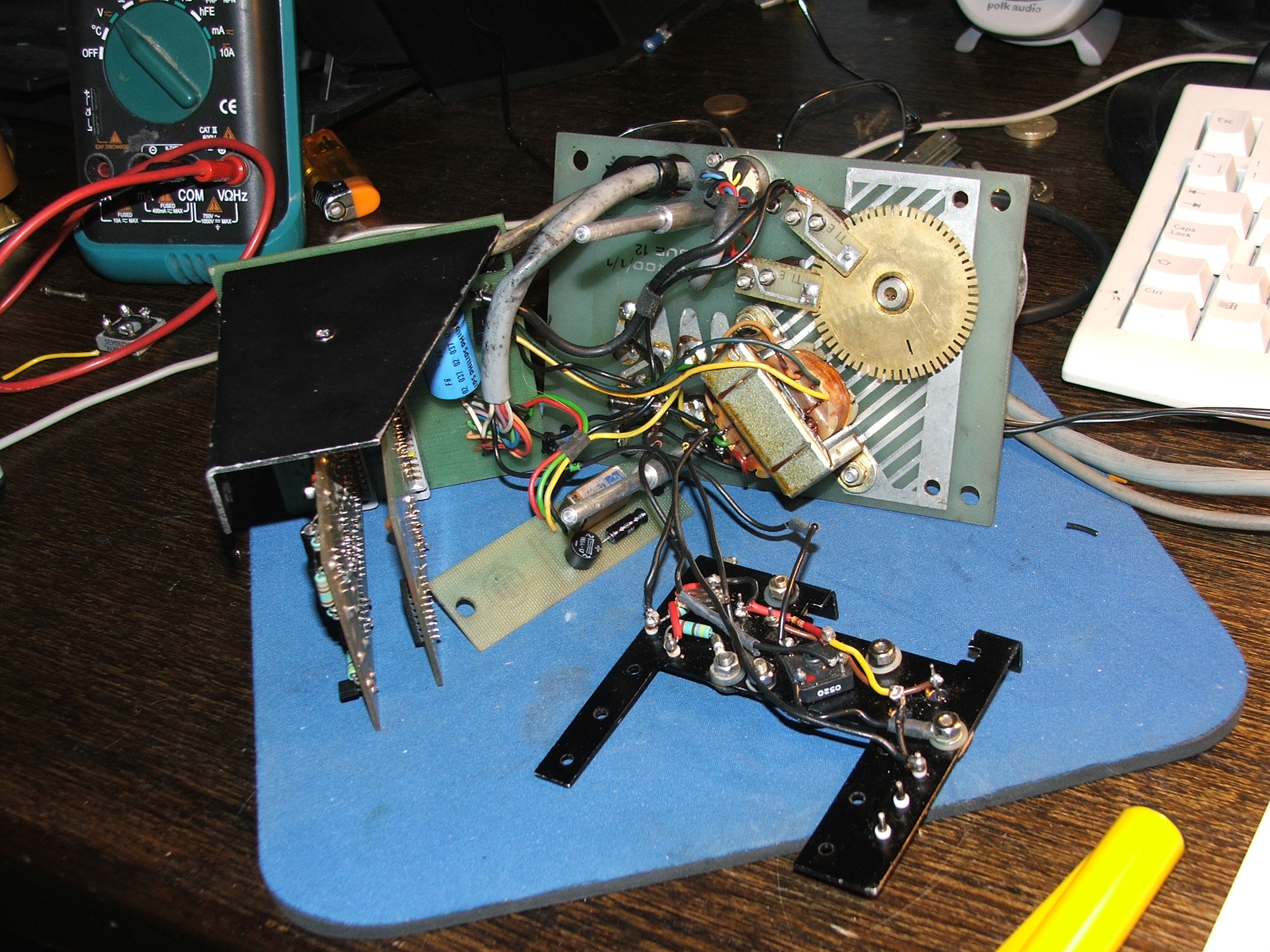

I tried to send photo of counter to show you what it looked like,but i cant seem to work out how to incert it.

Photo enclosed
The 12 pin on (7473) is high, there is a high on pin 9 (7460), so pin 8 (7460) is low, dont i need a low on pin 12 (7473)?.The other thing is there is no pulse on pin 5 (7473), i'm begining to wonder if the (7473) is no good, all though i've just replaced it.

Pin 12 on IC4 needs to go low.
However, there might be more than one cause to look at.
Pin 14 of IC4 needs to switch on and off, as a result of TR2 switching on and off, when the start button is pushed ....
Pin 1 on IC4 is the clock pulse pin, and needs to change state in accordance with the output of TR1 .... taken from its emitter ...input to pin 9 of IC2.
The clock pulse is generated when the slotted brass wheel is turned.
Check to see if pin 2 (marked 'clear') of IC4 is high ...It looks like pin 2 is supposed to toggle between high and low, as the count progresses.

Pin 1 ic4 changes state with clock pulse.
Pin 2 ic4 remains high all the time.
Pin 1 ic2 is high no change.
I am getting a pulse from pin 5 ic4 all be it very slow.
Pin 14 ic4 goes high when start button is pressed, but there is no change to pin 12 or 13 ic4.
I have not changed anything else yet, i still suspect ic4 though.

Interested to see if you are getting a pulse ... a change of state.... from pin 8 of IC4.... even a slow pulse.
This should cause pin 2 to toggle, and pin 12 to go low.
If pin 8 does in fact toggle, then problem might be IC2, an SN 7413, or possibly C1, the 22 µF electrolytic capacitor.
Pin 8 ic4 does toggle very slowly, pin 2 does not move.
