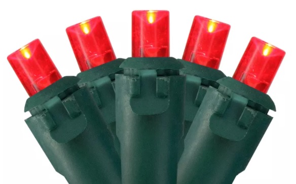

They look like this.

Indoor only I hope?.
The box says "indoor/outdoor".
