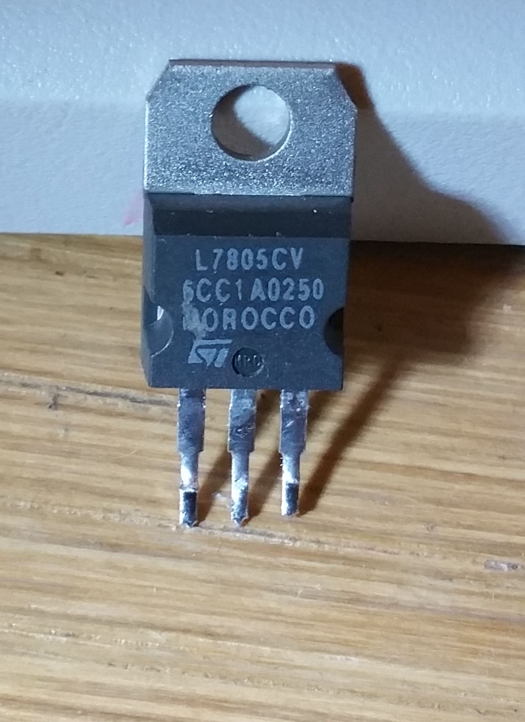

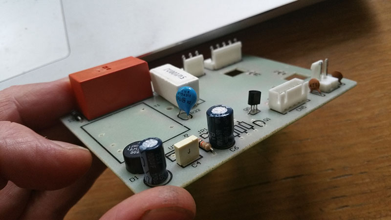

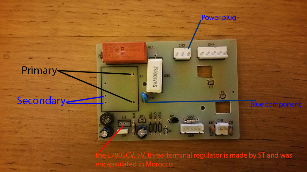

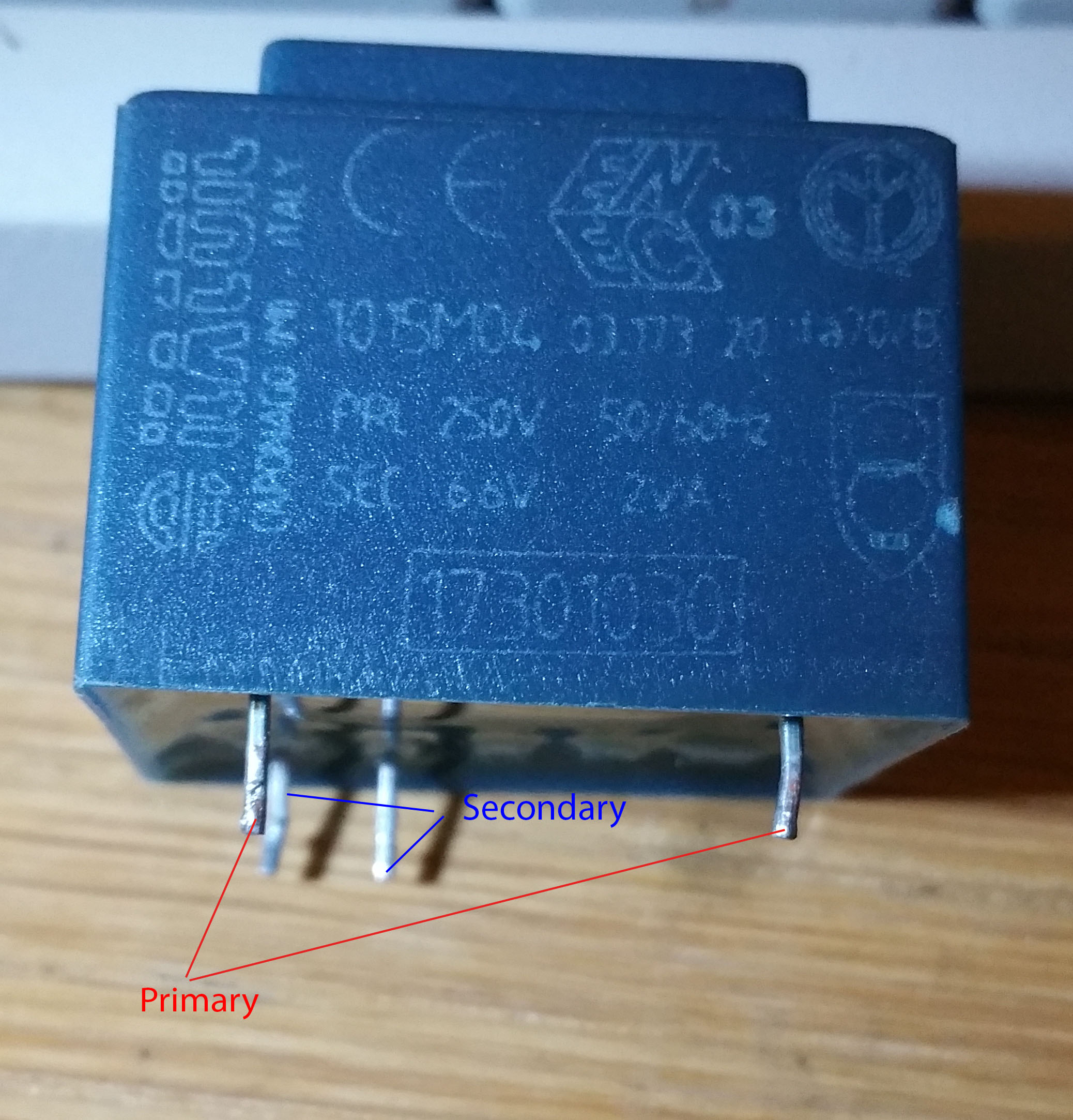

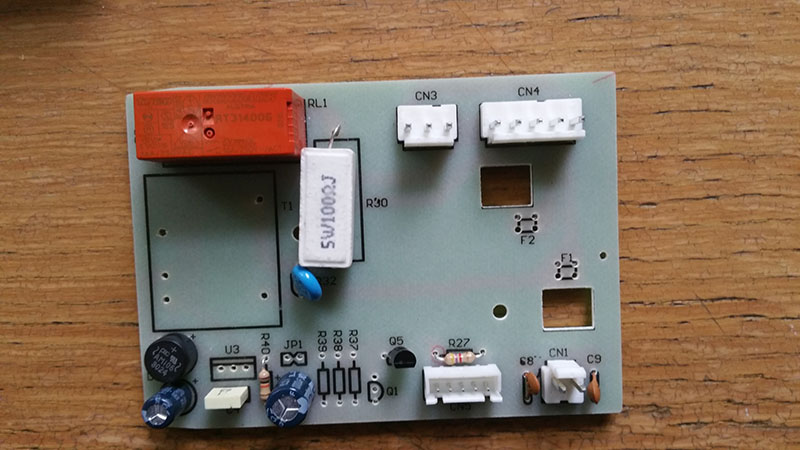

Hello,
Please can anyone help me identify this PCB transformer, shown in the attached photo. (The large blue transformer)
The Chest FREEZER Whirlpool AFG 605 DGT was bought in France.
It states on the blue transformer that the secondary output is 66V 2VA............but this seems very strange to me ?????
Very high voltage for a PCB board ?
Is it possibly 6.6v ???
The Borocco L7805 CV Voltage Regulator (which is downstream of the blue transformer) states that the voltage IN is between 7.5 and 35v
so the secondary output on the blue transformer does not make sense !!!
Any help would be much appreciated, especially on where to get a replacement transformer.
(From the markings on the transformer I can see it was made in Italy, but cannot make out the name of the Company)
Thank you
John

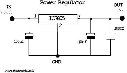

6V 333mA 2 watt.
That will put 8 to 9 volts on the capacitors.

Bonjour John,
Welcome to ETO. Which part of France are you from? If you put it next to 'Location' on your user page it will show in the box at the left of your posts.
If I read you correctly, you suspect that the blue transformer is faulty. Why do you think that?
I haven't investigated a replacement transformer or analysed your circuit in detail, but I suspect that the circuit simply comprises a mains transformer, rectifier, reservoir capacitor, and three-terminal voltage regulator (L7805) to provide a 5V supply line, just as you imply. The only complication that I can envisage is that the transformer secondary may feed another circuit, like a zero voltage detector, for example.
Those small low-power (2W) mains transformers have very fine primary windings which are prone to go open circuit. The bad news is that it may be impossible to get an exact replacement transformer, but the good news in that, with a bit of ingenuity, you should be able to fit another model of transformer that will do the job well or even better. But I would advise getting a sealed transformer, like the original.
A replacement transformer would need to meet the following requirements;
(1) Primary: suitable for the mains in France (230V AC RMS at 50Hz)
(2) Secondary voltage: 6.6V. If you cannot get this exact voltage, a slightly higher voltage will be fine.
(3) Power rating: 2W. Any power rating of 2W or greater will be suitable (but the transformer physical size will be the limit)
There are many transformers on the market that will probably suit. I will investigate but if I can't find a suitable replacement transformer there are many ETO members who surely can.:)

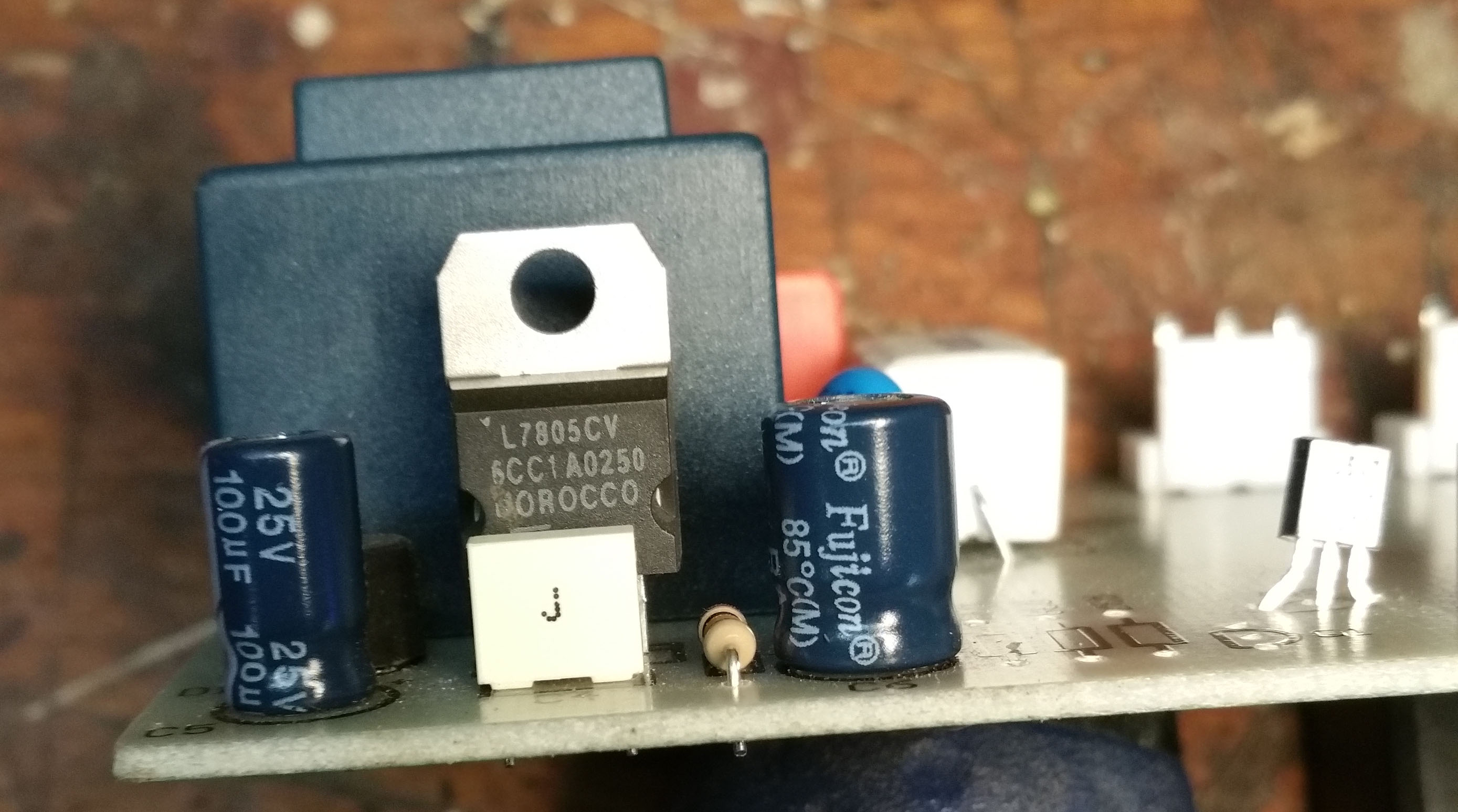

Incidentally, the L7805CV, 5V, three-terminal regulator is made by ST and was encapsulated in Morocco.:) https://www.mouser.com/ds/2/389/l78-974043.pdf

8) Whirlpool Freezer : I believe the L7805CV, 5V, three-terminal regulator is OK (not blown), but I am not quite sure how to test it with my meter. Obviously until I repair the Blue transformer, I cannot see if it outputs 5volts. I have removed it from the circuit board, and there is a resistance between all three terminals (Terminal 1 (input), Terminal 2 (ground), Terminal 3 (5v output)) . Resistance between terminal 1 and 2, 1 and 3, 2 and 3. Not quite sure how this regulator works, so what the ohm readings should be, have no idea.
The regulator is a standard component and freely available for about $0.50US, so teat it with care if you want to avoid further heavy expendature.:D You can't make any meaningful measurements with a multimeter, except to check for dead short circuits.

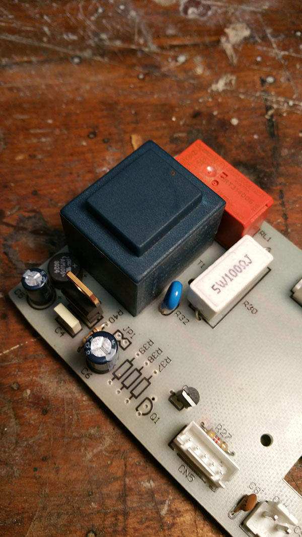

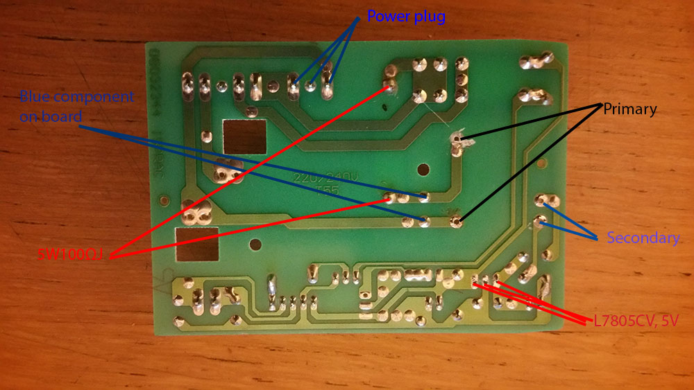

Hi Spec,

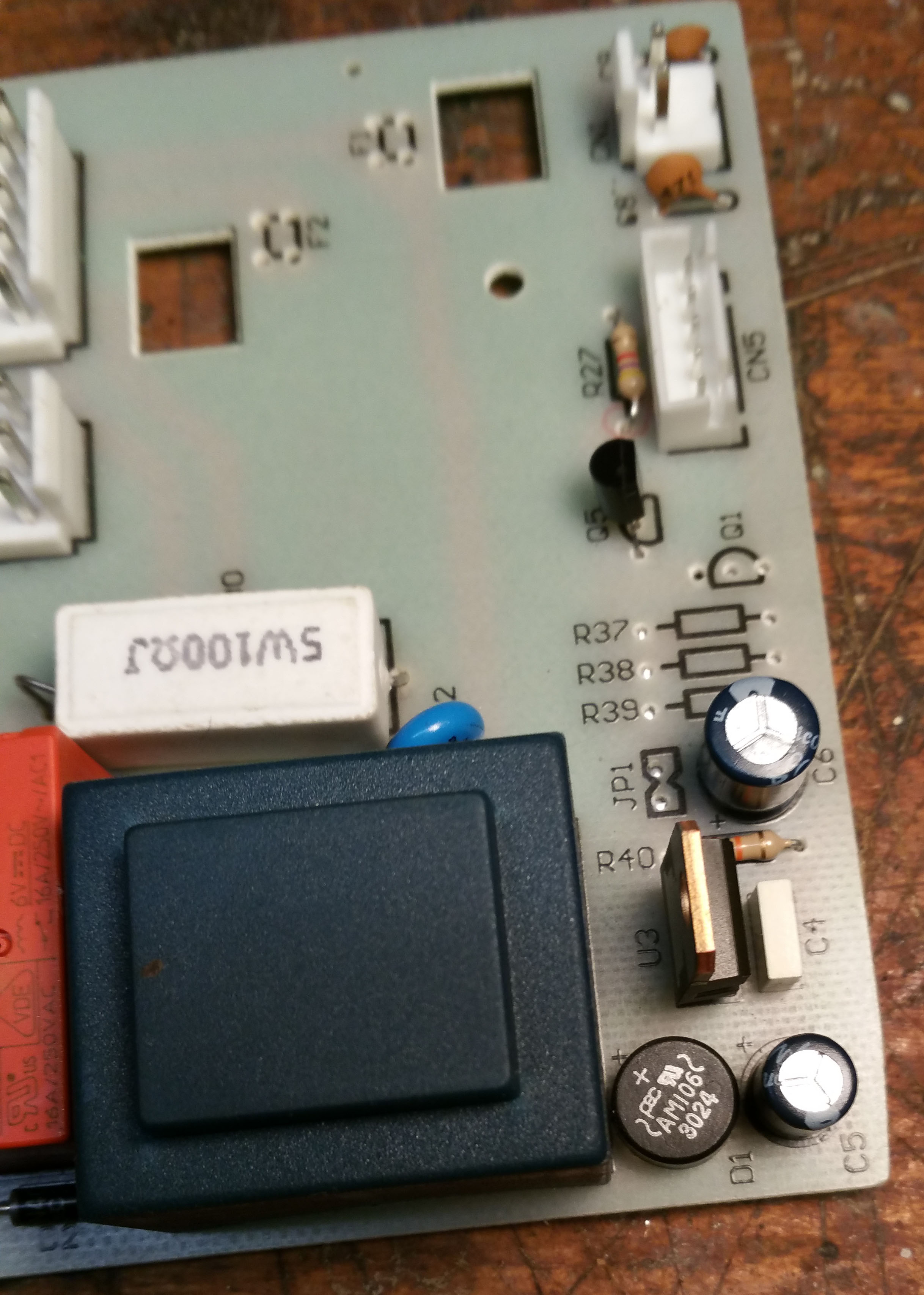

I have photographed the circuit board, and the photos are attached.

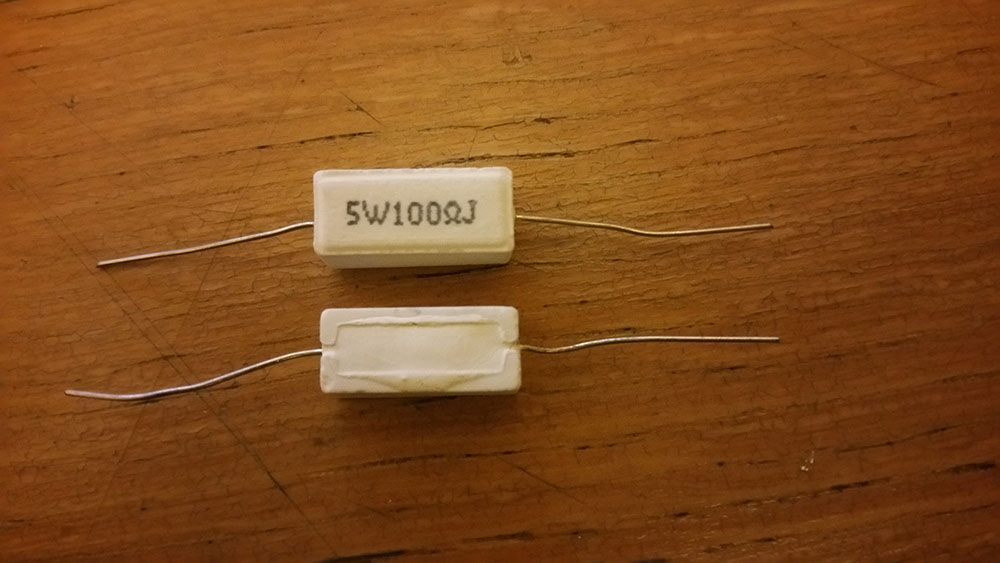

The resistance R30 (5W100ΩJ) is on the input primary side of the transformer. It has blown. I replaced it hoping it would just be that, and the new one blew as well. (this was with everything left on the board).
The photos now show the board without the blue transformer, and the 5v voltage regulator which I have removed.
On the output of the blue transformer............it passes directly into the little round black component (AM106 8024)......no idea what this is.
From there it goes to the 5v voltage regulator with the capacitors on each side of the regulator.
The Orange component is just a relay.
Interestingly this freezer has remained running ...........the compressor runs all the time.
I believe the electronic part actually switches it off when it has reached the correct temperature (rather than the other way round, where it would switch it on)
That way if the electronics fail, as they have done, the compressor continues to run and you do not waste all the food in the freezer.
Does any of what I have written help you to make any assessment and recommendation please ?
On the primary 250v side of the transformer, when I switch the ohms to x100 or x10k.......it shows a reading, but it should show continuity on a x1 which it does not.
(The secondary coil shows continuity on x1 with no problem at all.)
My conclusion.........The blue transformer is faulty on the primary coil side.
My only question is why would the R30 (5W100ΩJ) blow again on the normal 250v AC
Many thanks,
John
Great. Thanks

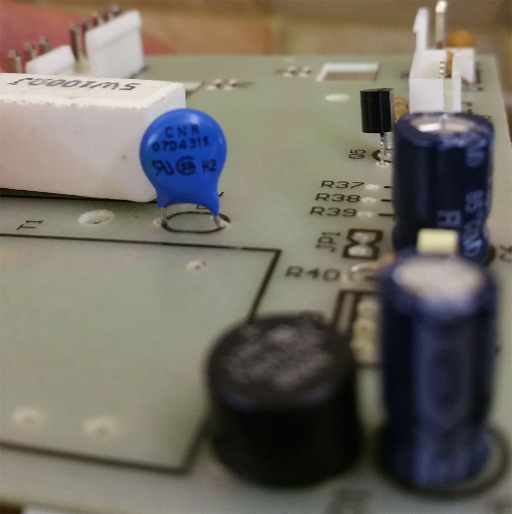

Hmm. That means that the 100R resistor must be connected directly across the mains supply.
On the output of the blue transformer............it passes directly into the little round black component (AM106 8024)......no idea what this is. From there it goes to the 5v voltage regulator with the capacitors on each side of the regulator.
Good. That black component is a bridge rectifier (as you said in the next post)
Right
Sounds like a good approach
Certainly does.:)
On the primary 250v side of the transformer, when I switch the ohms to x100 or x10k.......it shows a reading, but it should show continuity on a x1 which it does not. (The secondary coil shows continuity on x1 with no problem at all.)
The primary will be a relatively high resistance and the secondary will be a virtual short circuit. Can you measure the primary resistance and give me the reading from the multimeter? Can you also measure any secondary winding terminal to first one primary terminal and second the other primary terminal. The meter should show a complete open circuit on x10K.
I am not so sure.:)
Could be an overvoltage protectors blown short, rather than the transformer.
I will digest what you have said and get back.
In the meantime, can you measure the resistance between the printed circuit pads that previously connected to the transformer primary?

Hi Spec,
Hmm. That means that the 100R resistor must be connected directly across the mains supply. YES, CORRECT
It is a high resistance. The primary on x10k goes right across the scale. On x100 it goes half way across the scale (Analogue meter and I cannot make out the figure on the scale. My digital meter is broken !)
There is no short across any of the primary and secondary terminals..........have tested all combinations.
If there should be a high resistance on the primary.............the transformer may be OK.
Yes...........when I bought the new 5W100ΩJ ..........it was marked as a voltage regulator.............which I found odd for a "resistance" ??
Fortunately I bought 5 of them...............so I still have 4 spare.
If I have read the scale correctly on the analogue meter........it is 300 ohms. The light blue resistor (R32) which is next to the 5W100ΩJ is across the terminals of the Primary.
Thank you
John
Hi John,
I suspect the blue component marked R32 is in fact a metal oxiide varistor. these are to protect the circuit from transients. I suspect this has failed almost short circuit causing the new 100 ohm resistor to fail. I think R32 is connected directly across the transformer primary. Can you photograph the etch side of the board and one of the new "100 ohm resistors" (So we can confirm that it is a 100 ohm resistor.) It is nice to be helping someone that is prepared to help themselves and answer questions about their problem. Too many posts start out something like "Tell me what to replace to fix my fridge" I will see if I can identify the varistor. (I think I will be able to read the part number as your pictures are so good.
Les.
Hi John,
I have found the datasheet on the device. It is a varistor. Farnell stock them. If it is connected in the way that I think it is then the board sould work with it removed but you should replace it to protect other parts. They are also sold on ebay. this is **broken link removed**.
Les.
Hi Les and Spec,
Thank you for all your help. It is most appreciated.
This is absolutely correct, it is.
The 5W100ΩJ is between one side of the primary (on one pin)................and the power wire ...........have tried to show all this in the attached photos.
For the Varistor...............I have marked 'Blue Component" in my photos !! Sorry !!!
Should I unsolder the Varistor from the board.............is there any way I can test it with a meter ?
That is the least I can do !
I have taken another photo for clarity.
Please refer to the photos, I have tried to make them as clear as I can
Many thanks,
John

Hi John,
You have already measured the resisistance (In post #15) of the varistor by measuring the resistance between the tracks that went to the transformer primary. You said that the reading was 300 ohms. As I can see nothing else in prrallel with the varistor this must be it's resistance. You can remove it and test it out of the board and if it is still reading 300 ohms it is faulty. (I have just tested the resistance reading of some similar varistors and they all read greater than 20 megohms.) I think if you replace the transformer and 7805 you will find that you get the regulated 5 volts output. The board is just the 5 volt power supply and relay with a driver transistor. In post#12 you say that the compressor still runs. I suspect that the relay on this board controls the power to the compressor. As there is no 5 volts the relay could not be energised so I think the contacts may have welded together on the relay. (Unless thy are normaly closed contacts which is umlikely.) Can you measure the resistance between the square pad under the relay with 4 pins comming through it (Directly below the word plug of power plug.) and the track just to the right of it. Do not test the board out of the freezer unless you feel confident working on a board with open live mains on it. If you have a low wattage (15 - 25 watt) mains bulb (Old fashioned filiment type bulb.) connect it in series with the live side of the mains to the board.
Les.
