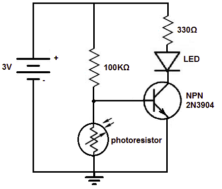

The cheapest... I would try a LDR glued to the back side of the glass and a transistor to drive the LED. Sort of a night light lamp, which is available to the public for 99cents and has more (housing) parts. -Battery not included-
The finger shade/blocking light will do the trick. No complications.
Borrowed from the web:
120507
Unsure about 330 Ohm, but if it is an optocoupler instead of the LED, multiple possibilities open.

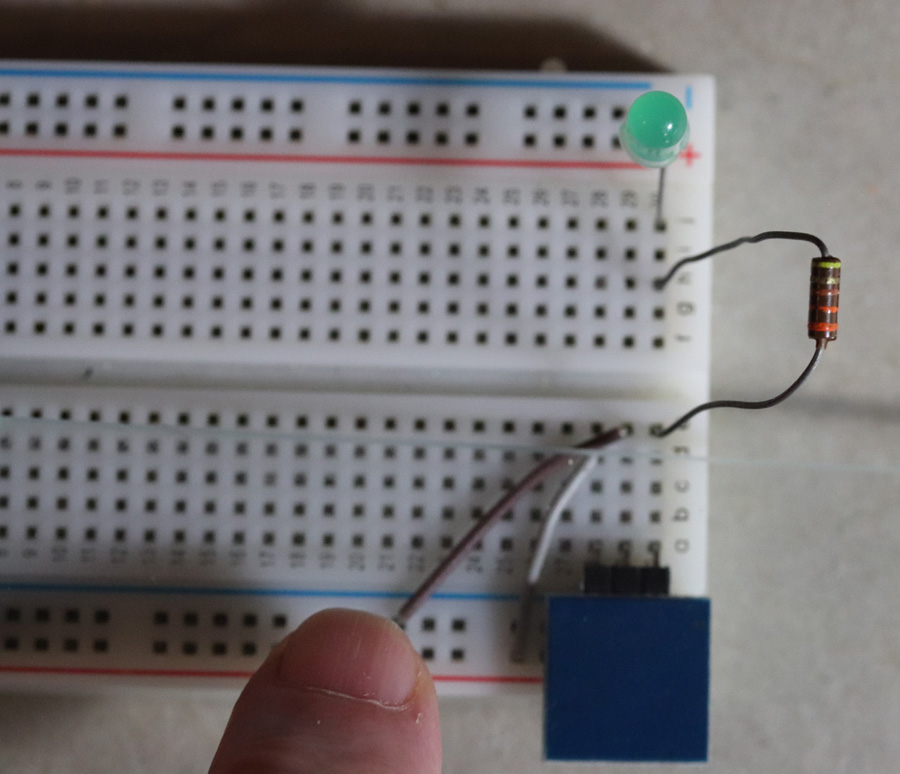

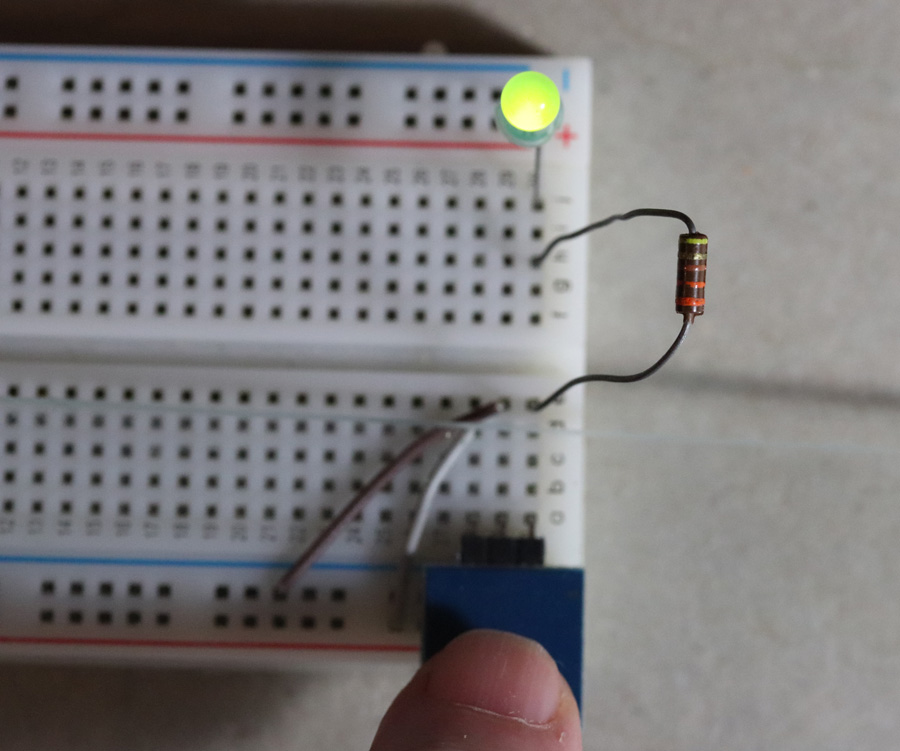

I don't know why you are trying to do this or what all the details are...frankly, it sounds like some kind of an assignment and I feel like I (we) am (are) doing it for you. Not crazy about that and it would help if you communicated something along the lines of understanding what is going on.
Nonetheless, here is what I just did.
120518
I put a 5V power supply onto a common breadboard. The TTP323B sensor board is wired as Vcc to 5V, GND to Ground, and, Out goes to a 330 Ohm 1/4 w resistor. The other side of the resistor goes to the anode of a green led and the cathode of the led goes to ground.
I put a glass pane (from a small picture frame - probably 1/16 in or maybe 1/8 in thickness) over the sensor as shown in the picture.
I turned on the power. When I touch the glass by the sensor or hold my finger near the glass by the sensor, the LED lights and stays lit as long as my finger is in that small area (see pic below).
120519
When I move my finger away from the area, the led turns off (see below).
120520
Note that in this example, the OUT signal of the capacitive sensor board is driving the LED through the 330 ohm resistor. It can source enough current (probably dropping voltage to supply it) to light the led.
