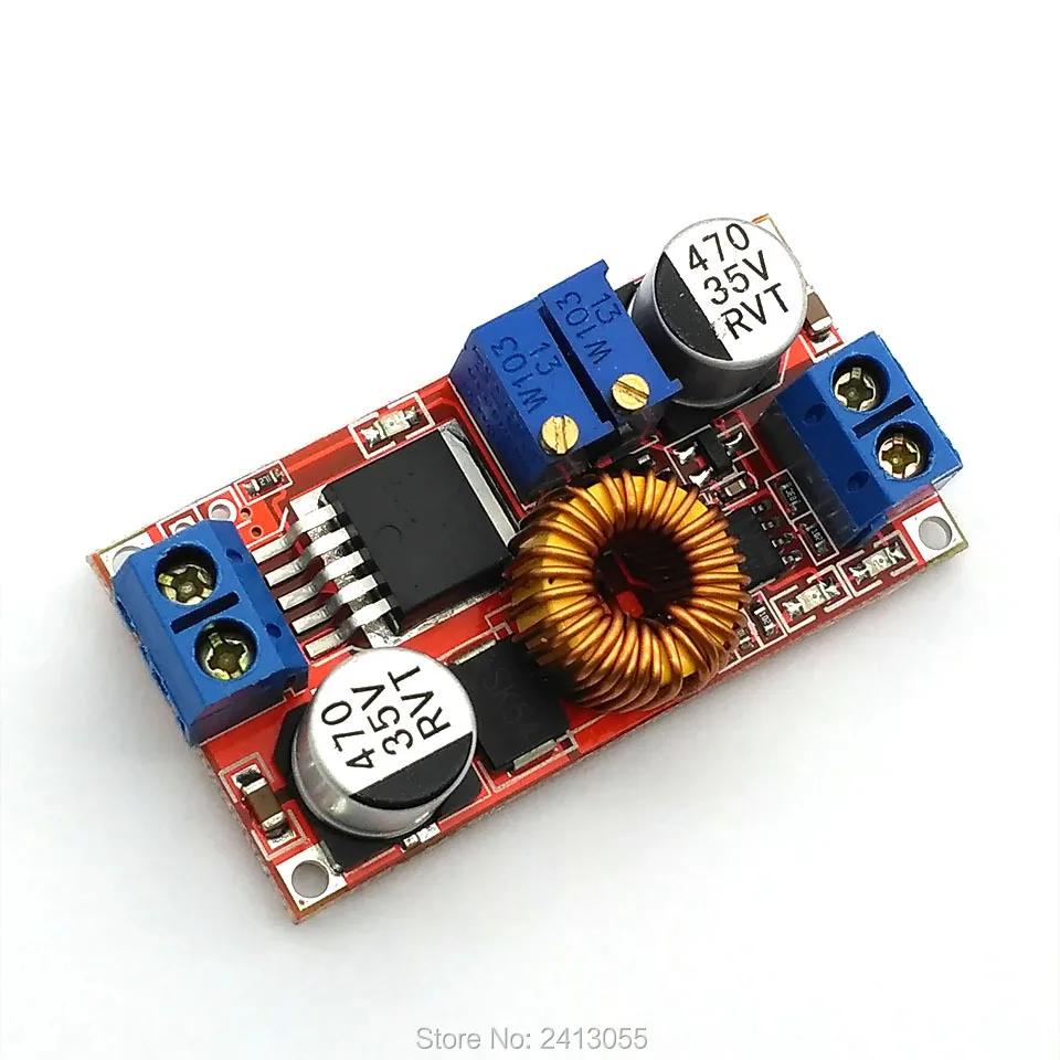

Pommie is correct, a power-bank does not care about data lines, ever. What you need is a module were you can select a precise output voltage matching your battery characteristics and also limit the current. Powerbanks are usually marked at the USB plug what current they can supply. The link shows a module with both voltage (CV- constant voltage) and current (CC=constant current) adjustments. that one will work from a 4 - 38V in and can put 1.25 to 36V out. You can also browse for other devices with LCD showing both voltage and amps, but they add an additional load.
