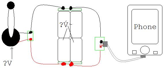

I attached my pathetic attempt to further explain my (hopefully not) failed project. Tell me if what parts I need to make this work. I'm thinking of using rechargeable batteries (like those found in airsoft guns and rc cars) and a different hand crank.

The phone has a charger circuit inside it. Your hand crank thing is a generator, not a charger circuit. If you feed your phone 5.0V at up to 1A then the charger circuit in the phone will safely charge its battery.
Your hand crank generator doesn't provide enough current to charge the battery in your phone unless you crank for a very long time.
Rechargeble Ni-MH batteries make 4.8V, not 5V. 4.8V might be too low.
They would need to be charged by a real charger, not your hand crank generator.

Its 1.2 times the number of cells, right? So if I get 5 cells and have a 6V output, use a linear regulator and solder the charger cable to the 'creation', would this work (Im not picky about how much I have to crank YET)? Also, would the current be a high current?

A "6V" Ni-MH battery is about 7.5V fresh out of its charger.
An ordinary 5V regulator doesn't work if its input voltage is less than about 7.5V.

Your phone's charging circuit is designed for an input voltage of 5.0V. It might fry if a Ni-MH battery presents it with 7.5V which is 50% too high.
The output for that charger is 6.2V. How does that not fry cellphones?
For mine, if I use the 5 Ni-MH batteries @6V (7.5V off the charger lol) with this 5V regulator (**broken link removed**) could I POSSIBLY get this to work?

6.2V is 24% higher than 5.0V. The charger circuit in some cell phones might fry if it is designed for 5.0v max.
The 7805 has a minimum supply voltage of about 7.5V. Its output voltage is lower than 5V if its input voltage is less than 7.5V.
Some 5V regulators are called "low dropout" and work fine until their input voltage is less than about 5.5V.
Ah, so basically I would have to have a low-dropout 5V regulator with a supply of over 5.5V in batteries? Therefore, I could have my mystery hand-crank, 5-6 batteries and an LM2940 between the batteries and the charging cable? (well, knowing my luck, I have it completely messed up)
