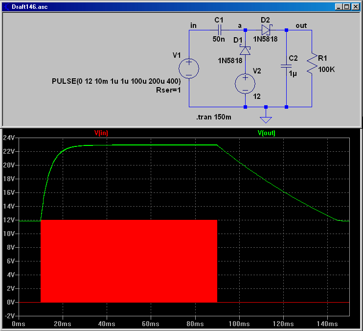

Are you talking about the two-capacitor, two diode charge pump that looks like this:

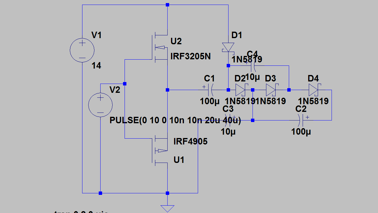

Here's the drawing of the .asc , I may have some components in my library that I have modified or that others don't have.
As I try different combinations in Spice, it appears that starting big and going small gives the quickest charge time.

The thing in your posts looks like a voltage tripler. What I posted is a doubler.

You said that it looked like I had a voltage tripler, it seems each stage only adds 50% of the supply voltage.

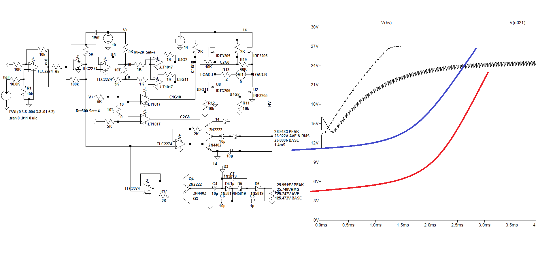

Do you see any problem of using the same oscillator for every thing as I have done in post 4?
Your Mosfets are not switches, instead they are source-followers (they do not invert) with +10V peak input and maybe only +5V or less peak output.
YES, my design was not working when tested, so I dug through the old post and found a design posted by alec_t (Thank You)

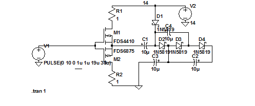

.....which is precisely the circuit shown in post #2.
Although the post #2 circuit provides fast FET switching it does gobble current during the pulse edge transients, when both the NPN and PNP are conducting at the same time briefly. By swapping the NPN and PNP positions in the totem pole that transient current is eliminated, at the expense of slower FET switching. Attached are the two arrangements for comparison, plus the .asc file (as requested by Aaron in post #9).
Headed for the garage to see if it works in reality as well as it does in Spice.
