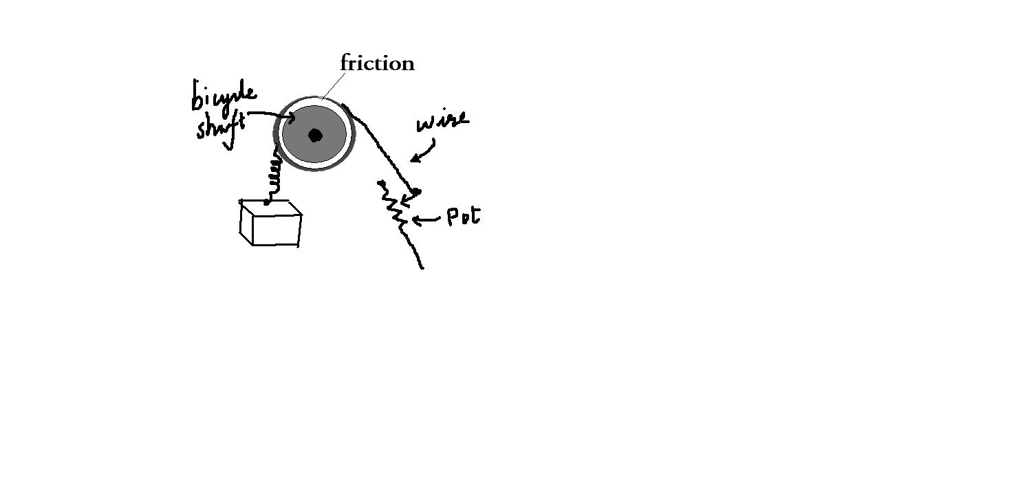

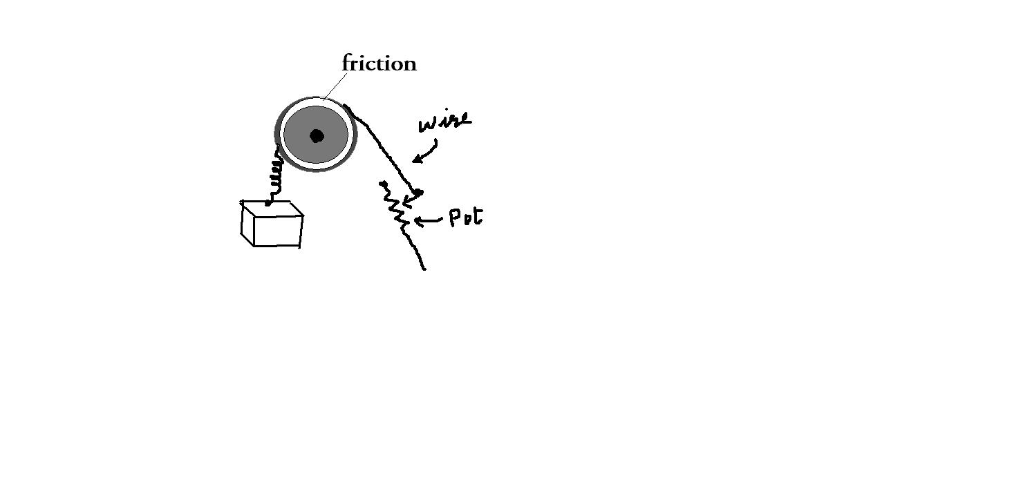

well, you are a mechanical engineer right? cant you device something that converts rotations to linear motion? in my mind there is something:
it may not be a solution, but its better suited for you (i think)

If you use a friction device it won't work. The friction force does not go up smoothly with speed. Mechanical speedometers use magnetic induction, but they rely on the needle having little friction.
