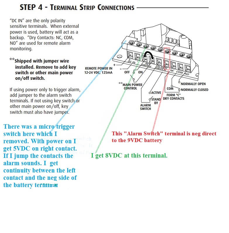

I have a **broken link removed** Select-Alert alarm. The alarm trigger is NO and is activated when the circuit is closed. I need to reverse that. I will be using a NC loop as the trigger so if the loop is cut the alarm will be activated which is the reverse of how it operates now. The only thing I can figure out is to use a relay. Any other suggestions and/or how to wire in a relay? Here are all the specs that I can find. TIA **broken link removed**

Thank you for the fast response. Most of my electronics training and memory have long been lost so please bear with me as I try and recover it thru out this project. This is what info I have in response to your questions. I know it doesn't answer them all but hopefully it is a start.

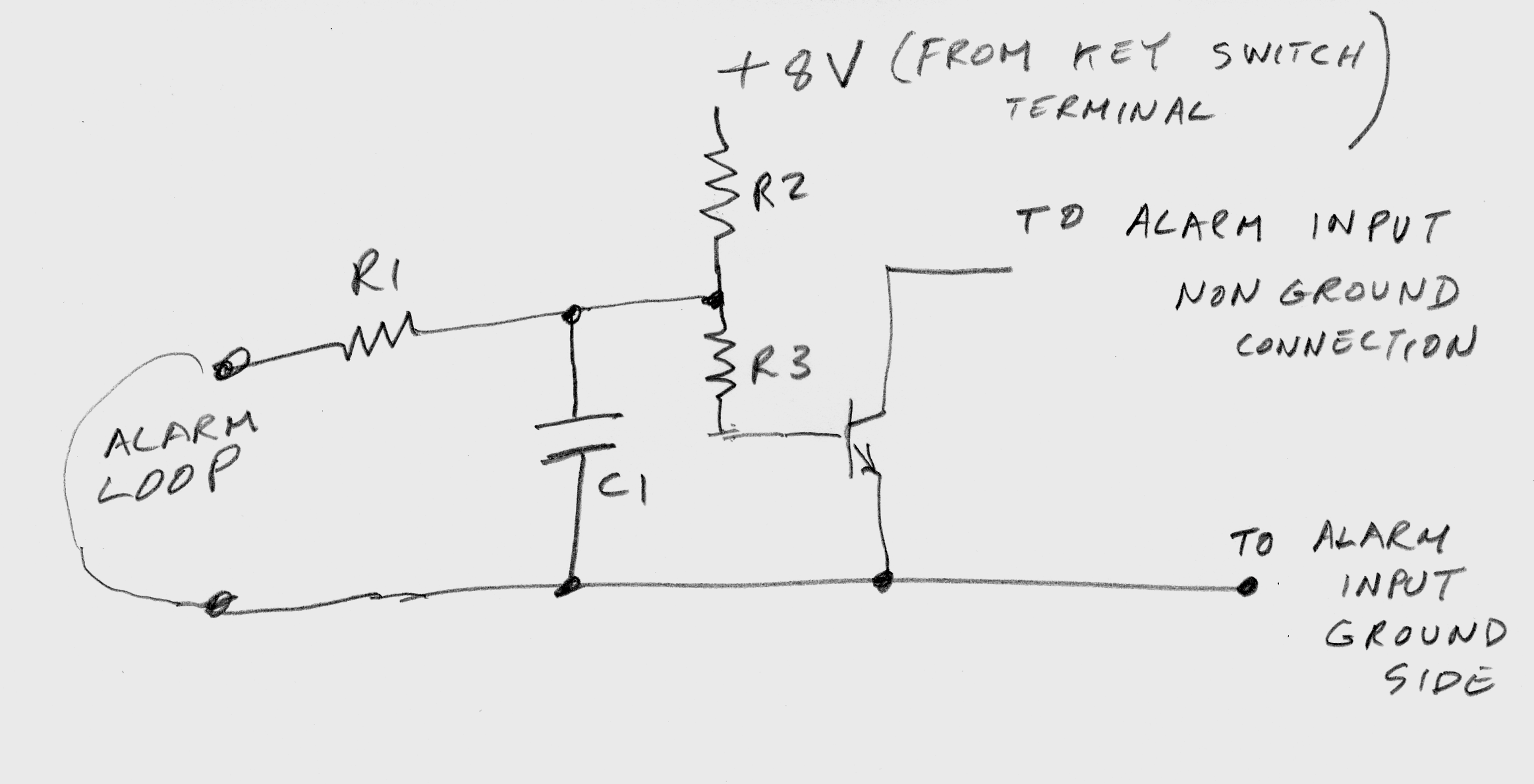

I suspect something like this should enable the unit to work with a normally closed loop.
You will need to answer the unanswered questions from post #2. (What is the voltage on the non grounded terminal on the existing open loop input and what is the current between the two alarm input terminals.) When you answer these questions I will suggest resistor values and suggest some suitable transistors that you can use. R1 and C1 only provide some protection from RF interference being picked up by the loop and possibly causing false triggering.

Tried...If I jumper the "alarm switch" terminals the alarm triggers. The COM and NC and NO terminals do nothing. I think they are looking for a trigger voltage from a remote alarm. The only way I have been able to get the alarm to trigger is using a jumper to "connect" rather than the "disconnect" I am looking for.

I get 5VDC at the non-ground alarm switch terminal. I forget how to interpret current readings ..... but my meter is set to 20m and the reading is 0.50

Make R1 100 ohms, R2, 15K, R3 150K, C1 100nF. Almost any small NPN transistor should work. (2N3704, 2N3904, BC337) You could also use a small mosfet such as an 2N7000. (Source would connect in place of emitter, gate would connect in place of base and drain in place of collector.) You could leave R3 out as it just limits the base current to about 50 uA which is more than enough to saturate the transistor. I am assuming the current you measured is 0.5 mA so I have set the current in the alarm loop to be about this value.

I got the parts in yesterday but didn't test until this morning. BINGO!!!!!!! We have a winner!!! At first it wouldn't trigger so I re-read your specs again (20th time) and replaced R3 with a jumper. Tested perfect. I thought maybe I misaligned a pin so I replaced R3 but no-go. Back to the jumper and BINGO again! Thank you so much. I have spent too many hours thinking about it and should of posted here weeks ago.

I'm pleased that it solved your problem. The reason it does not work with R3 in could be the hfe is lower than the value I used for my calculation or the current that you measured was more than the 0.5 mA I thought it was. The only effect of not having it is the circuit will take about 450 uA more when the alarm loop is open. As this situation will only occur for a very short time it will have almost no effect on the battery life.
