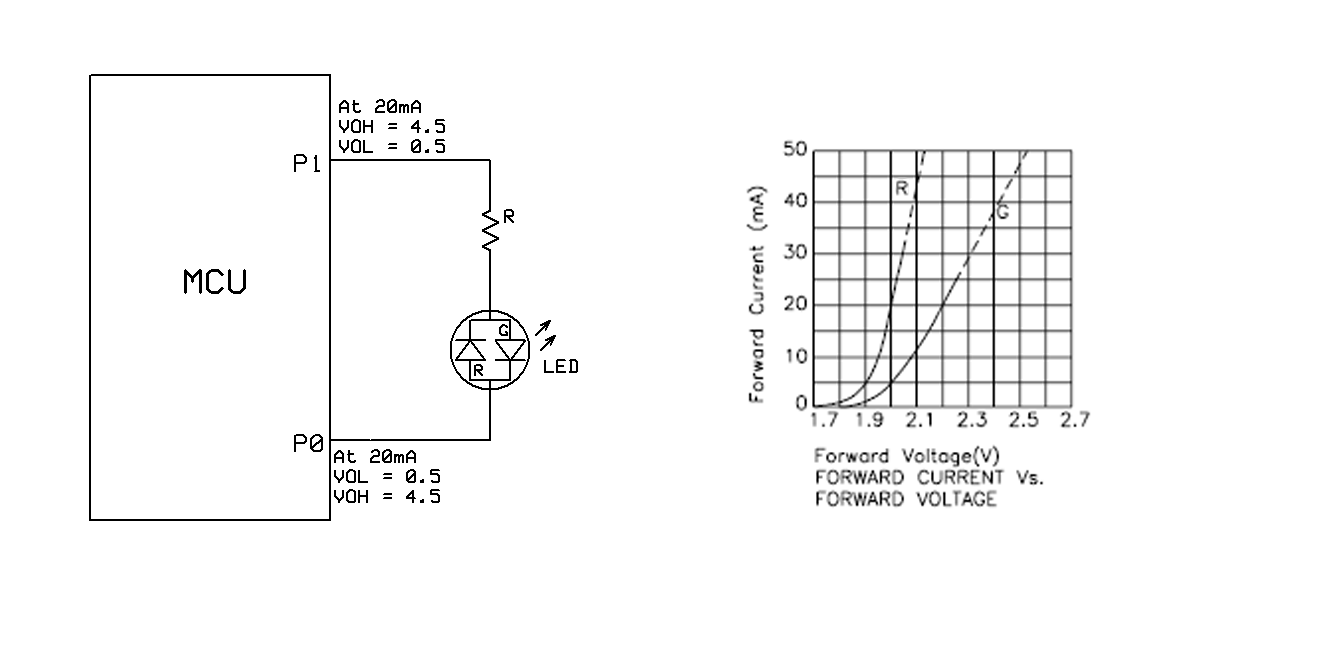

Given the following schematic and datasheet :
I would have normally calculate R as such :
R = (Vsource - Vled) / I
R = (Voh - Vol - Vled) / I
R = (4.5V - 0.5V - Vled) / 20mA
Normally, I would simpley get Vled at 20mA from the datasheet.
In this case, I'm not sure which value of Vled one should pick and what would motivate his choice. I know it probably doesn't make a big difference, but I'm interested in understanding the theory/best practice behind the choice in that situation.
Thanks !

I just said that at 20mA, one port will be at around 4.5V while the other will be at around 0.5V. So the voltage available to drive the LED will be around 4.0V.
Then if the red LED is actually 2.0V and the green LED is actually 2.2V, a current limiting resistor value of 100 ohms will cause a red current of 20mA and a green current of 18mA which are nearly the same.
How about 2.1 volts?
Yeah, that's what I intuitively intended to do. 2.1V it will be.
What triggered my questioning is the datasheet that shows very different current for a 2.1 voltage drop. But I guess in this case, the Resistor is the biggest factor that decides the current. So in the case of red, i will be close to 20mA and close to 2.0V and for the green, close to 20mA and close to 2.2V.
I guess, then, if my driving voltage was only 2.5V, the difference in current would be greater between the two sides.
